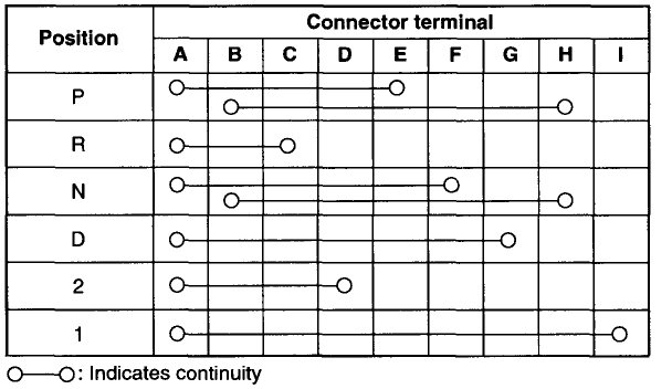

Without a proper scan tool that can talk to the transmission control module you are sort of stuck. If both transmissions act the same way it almost has to be in the electronics and the testing of those requires a scan tool to read the signals and test the controller. You might want to check the connections and wiring and test the transmission range selector using the charts below. The first shows the connector pin view looking at the end on the selector, the other chart tells you which ones connect in which position. For that test you only need a continuity tester to be sure the switch conducts properly.

KAY KHALIL
Hi guys....well problem solve..its actually the ecu for the gearbox located behind the foot brake...replace it and all ok..bah....I wonder tis so called gearbox specialist fail to check...send to a wireman and he show me the thing and ask me to replace it or rebuilt it...well found a 2nd ones so down it go..now smooth...
