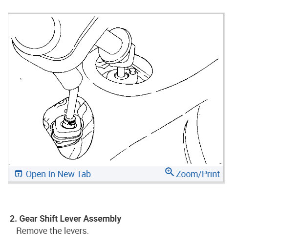

I had a clutch put in my vehicle when I got it back it won't come out of four wheel high? I've tried everything is wireless or something. So, what could I do to make it come out of four-wheel drive?

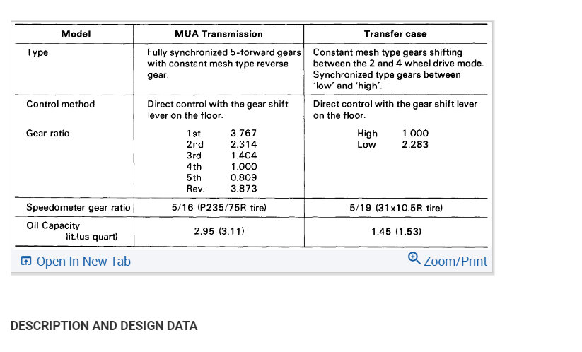

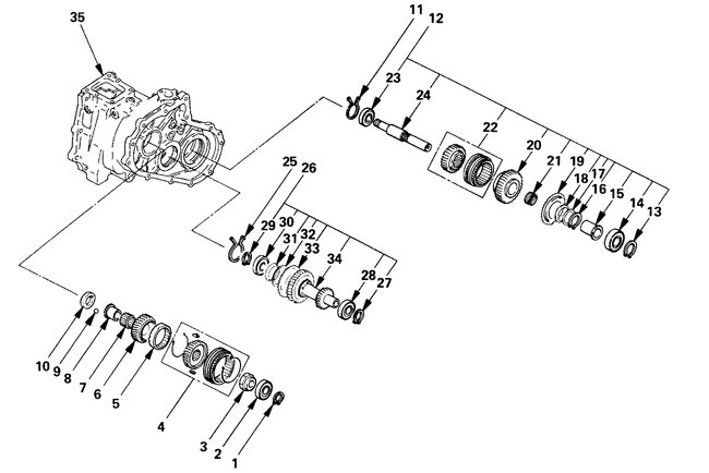

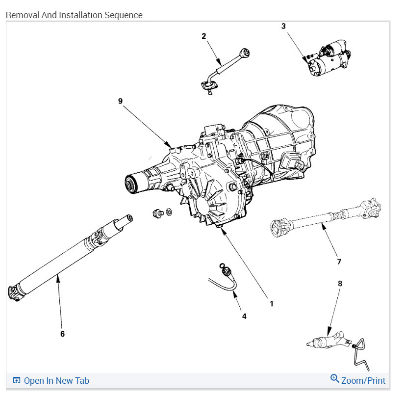

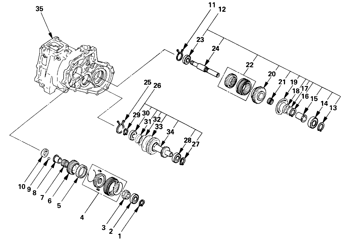

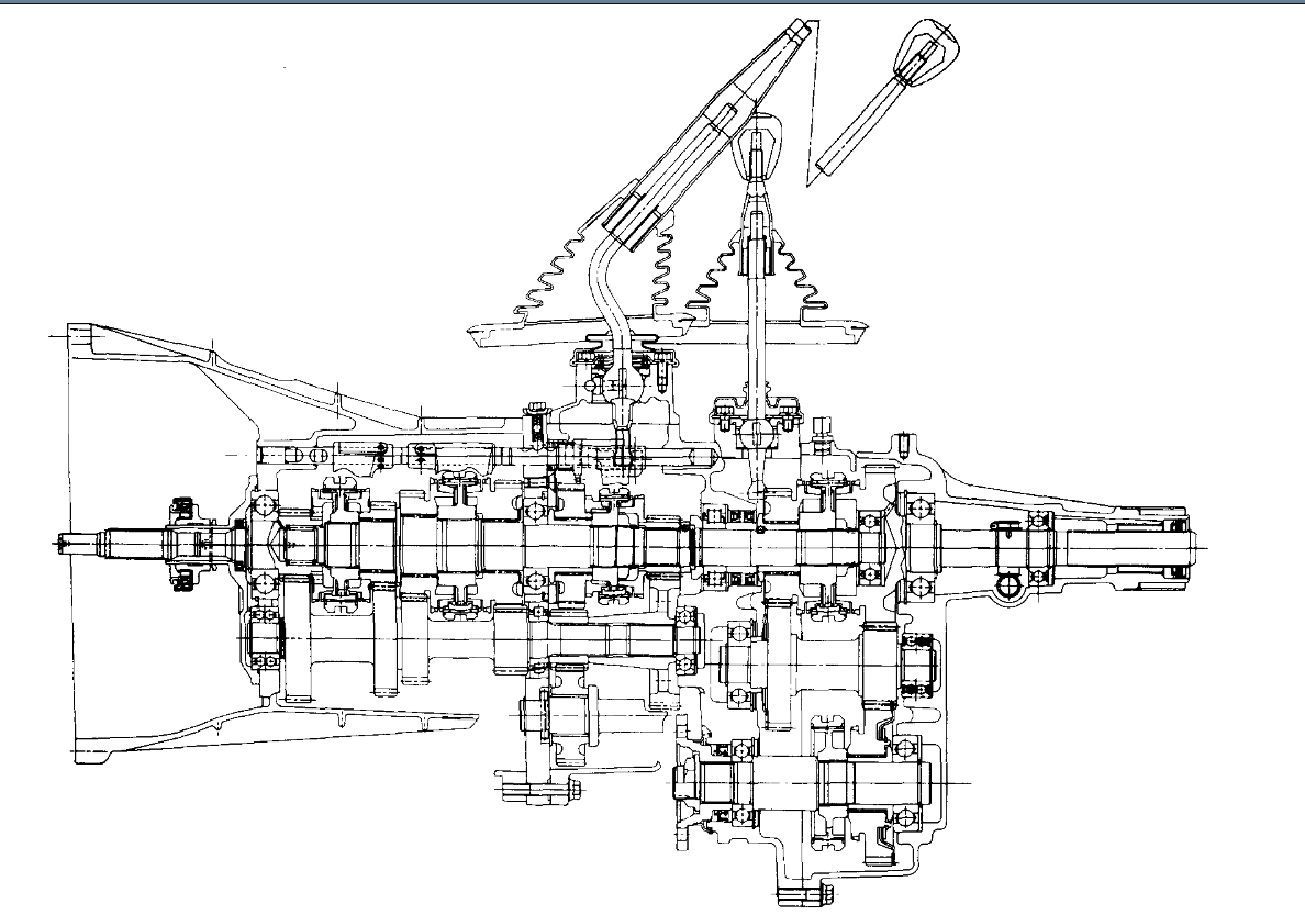

This is a full manual transfer case system, I would remove the gear selector and see if it is installed correctly, the selector rod might be off. Check out the images (below). Please let us know what happens.
