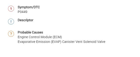

Code PO449
2008 CHEVROLET COBALT
165,000 MILES • 2.2L • 4 CYL • 2WD • AUTOMATIC
CPERRY54
  • 35 POSTS

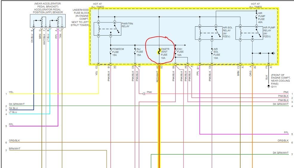

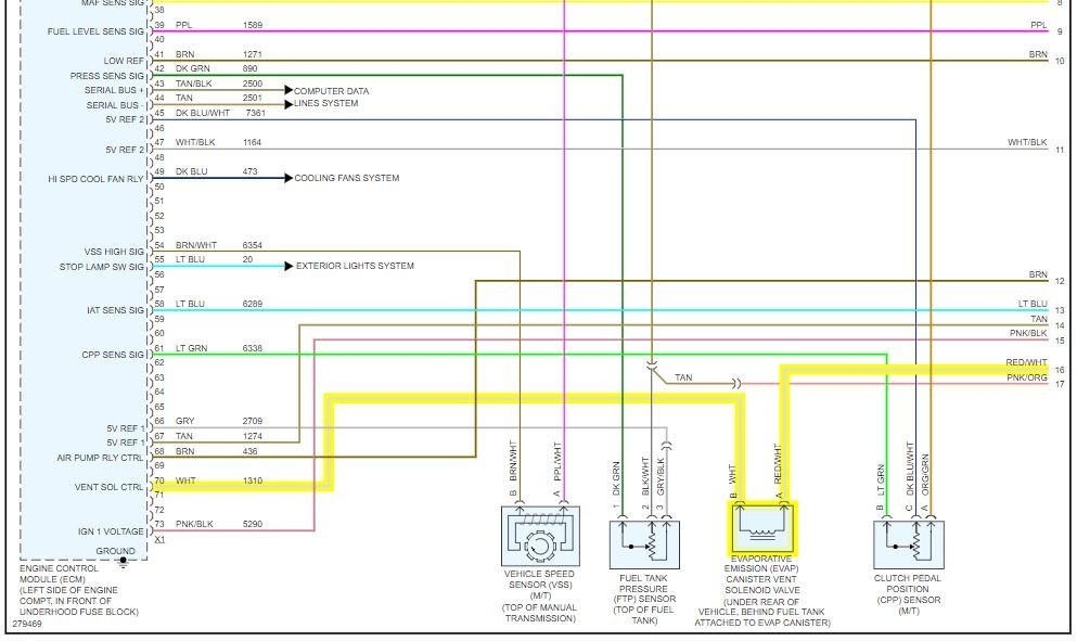

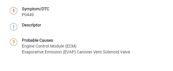

I changed the vent solenoid,and erased the code and it reappeared within minutes. what could be the problem? Thanks
Feb 21, 2020 at 3:02 AM
Good morning,

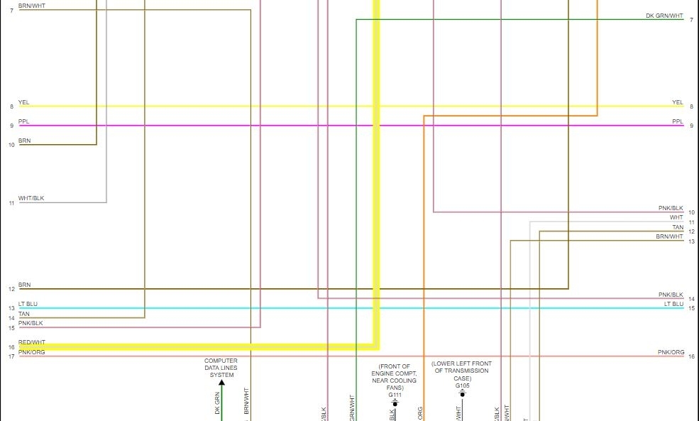

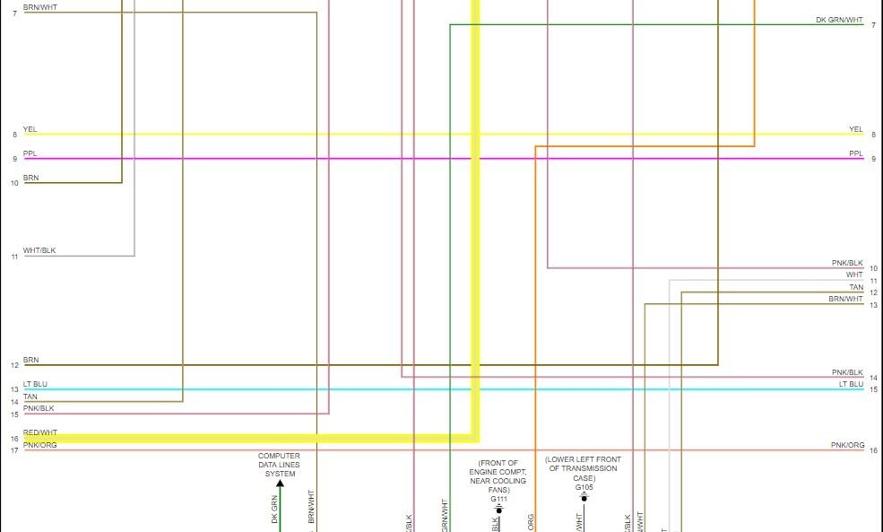

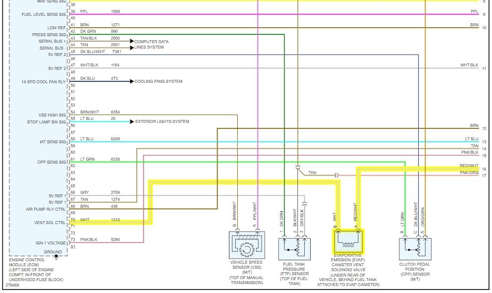

I would go to the solenoid and test for power with the key on to the pink wire. If it does not have power, it cannot work.
Feb 21, 2020 at 4:31 AM
CPERRY54
  • 35 POSTS
There is no power at the pink wire. Where do I go from here? appreciate it.
Feb 22, 2020 at 1:03 PM
Check the fuse I circled in the one diagram I sent you.
If there is power at the fuse, you have a wiring issue from the fuse to the solenoid.
