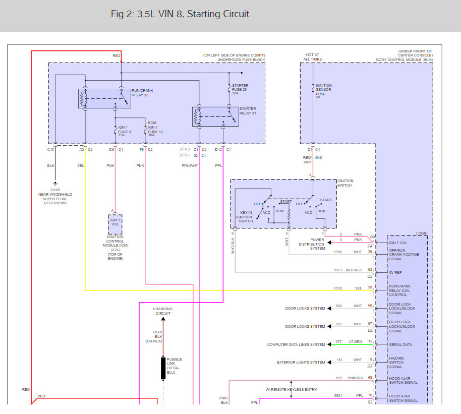

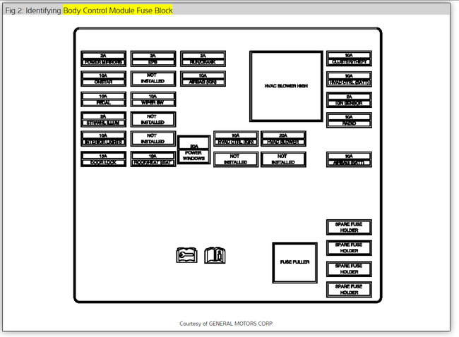

We changed the starter. If you jump across the solenoid, it starts. Sounds like clicking in or around the fuse box on the fender. Swapped out the starter relay with a couple other relays Still nothing, same with fuse for starter.
Jul 19, 2018 at 9:12 AM
  • 55,746 POSTS

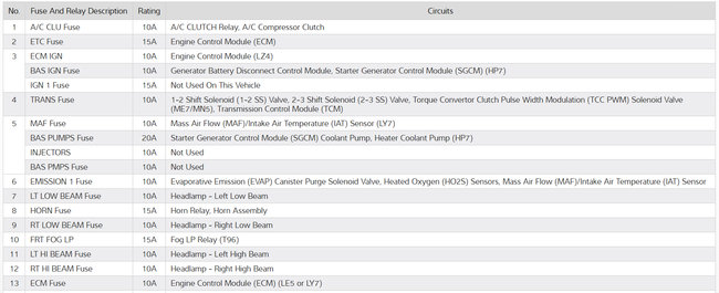

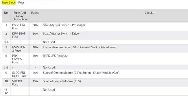

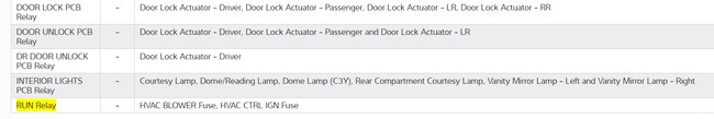

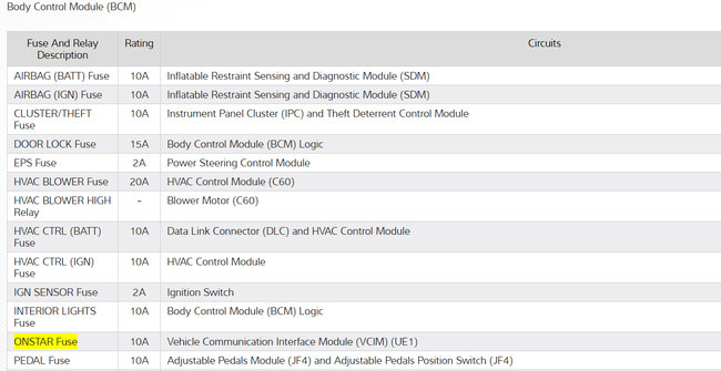

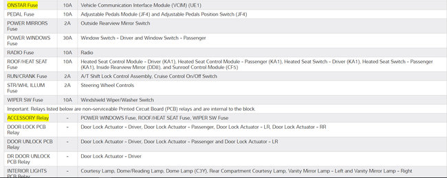

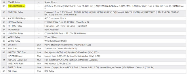

There are four fuses and two relays that run the system through the BCM. Can I ask if the security light is flashing? If so follow this guide:
https://www.2carpros.com/articles/how-to-reset-a-security-system

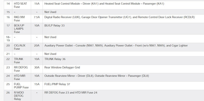

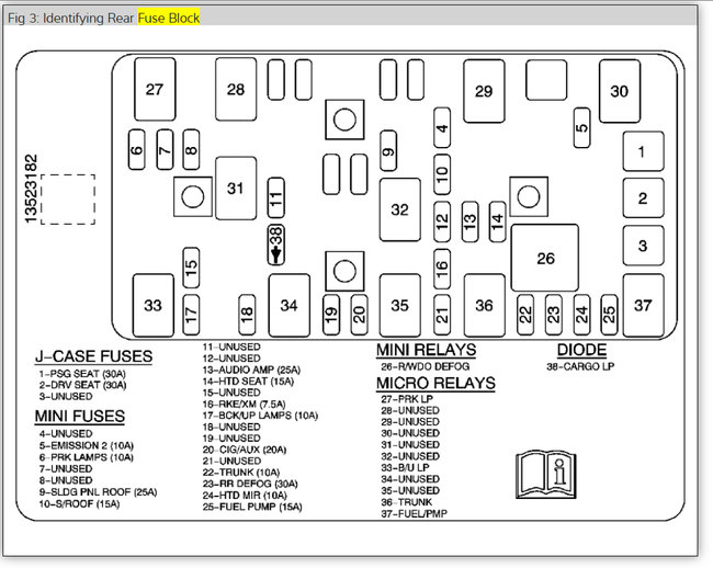

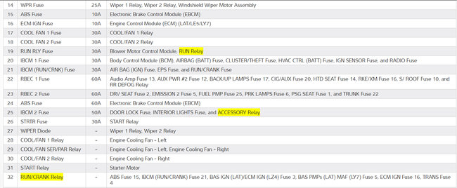

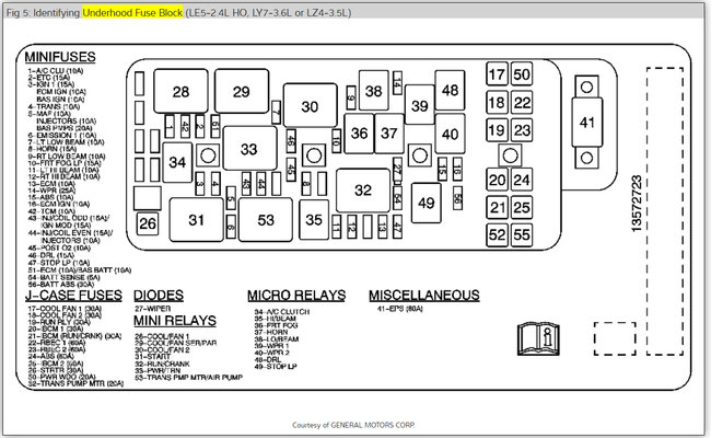

If not, here is a guide to help you test the fuses and relays:
and

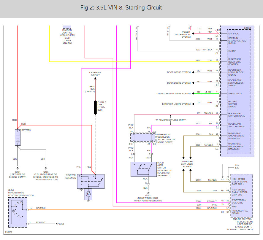

Here is the starter wiring diagram so you can see how the system works and which fuses and relays to test. Check out the diagrams (below). Please let us know what you find.
