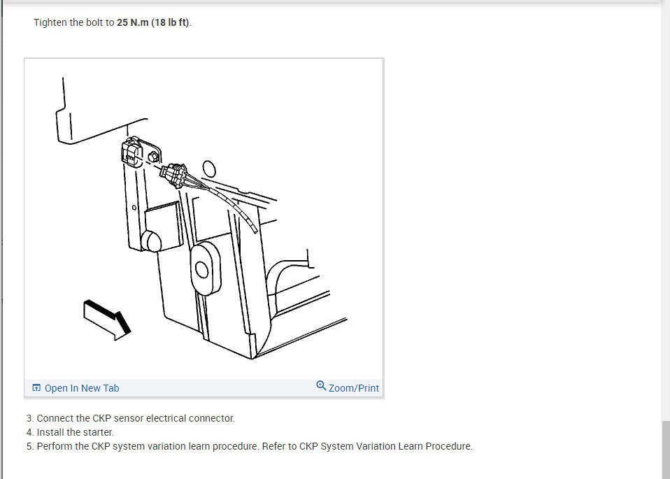

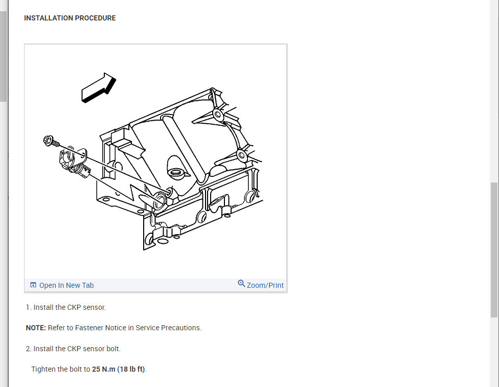

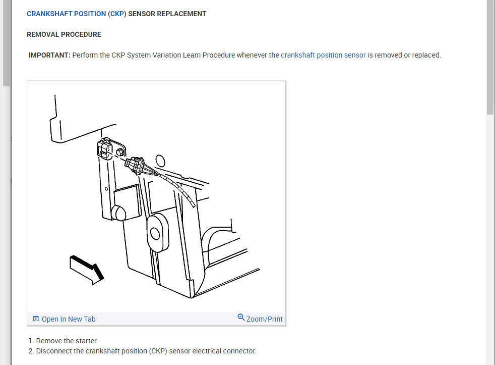

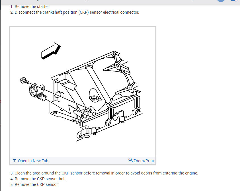

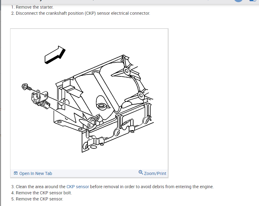

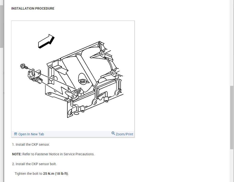

Below is the process for the crank sensor in case that proves out.
