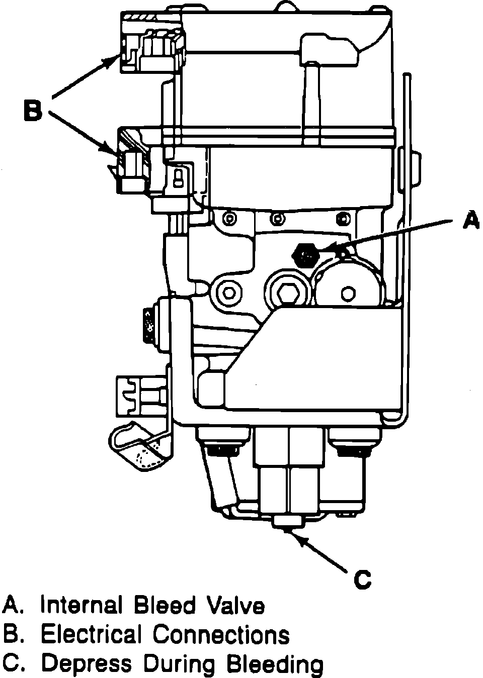

I just replaced my vacuuming booster in my older four wheel drive. After bleeding brakes four times each brake line by pumping brakes the pedal is soft. Several questions evolved. Must the modulator be bleed as well? If so,then I will read more from previous answers on best way to do this.

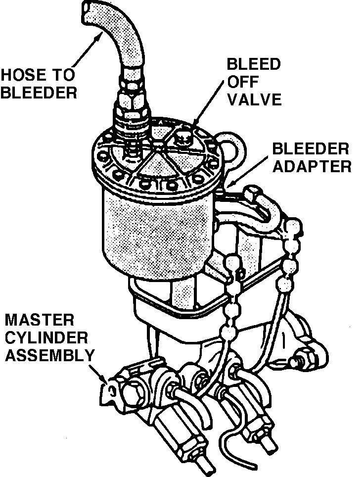

However, here are the directions specific to your vehicle for bleeding the system. There are two different process. Both are covered in these directions. I will separate the two with a line. Picture 1 correlates with pressure bleeding.

Fig. 1 Installing Pressure Bleeder Adapter (pic 1)
Pressure Bleeding
1. Loosen, then slightly retighten bleeder valves at all four wheels. Repair any broken, stripped or frozen valves at this time.
2. Using a diaphragm type pressure bleeder, install suitable bleeder adapter to master cylinder, Fig. 1.
3. Charge bleeder ball to 20-25 psi, then depress and hold valve stem on combination valve.
4. Connect pressure bleeder line to adapter.
5. Open line valve on pressure bleeder, then depress bleed-off valve on adapter until a small amount of brake fluid is released.
6. Raise and support vehicle.
7. Bleed right rear, left rear, right front and left front brakes, in that order.
8. Place transparent tube over bleeder valve, then allow tube to hang down into transparent container. Ensure end of tube is submerged in clean brake fluid.
9. Open bleeder valve 1/2 to 3/4 turn and allow fluid to flow into container until all air is purged from line.

As far as the ABS module, here are the directions for bleeding it. It does require the use of a live data scanner. See pic 2
The EHCU Module should be bled after replacement or if trapped air is in the unit. If bleeding is required the module must be bled thoroughly before the wheel cylinders and calipers.
There are two bleeders on top of the unit that appear to be normal bleeders, Fig. 59. These are modulator bleeders and must remain closed when the unit is not pressurized.
The internal bleeders are on either side of EHCU module. The valves are used to open the internal passages within the EHCU module. Both bleed valves must be rotated 1/4 to 1/2 a turn counterclockwise before beginning the bleed process. The valve on the left hand side is used for the rear brakes and the valve on the right hand side is used for the front brakes.
The ignition switch must be in the ``Off'' position or false trouble codes may be stored.
1. Install combination valve depressor tool No. J 35836 or equivalent to LH high pressure accumulator bleed stem of EHCU module.
2. Install combination valve depressor tool No. J 35836 or equivalent to RH high pressure accumulator bleed stem of EHCU module.
3. Install combination valve depressor tool No. J 35836 or equivalent to rear combination valve.
4. Ensure master cylinder fluid level, fill if required.
5. Bleed EHCU module as follows:
a. Slowly depress brake pedal one time and hold.
b. Open left modulator bleeder, until fluid flows clearly or pedal is depressed, the close left bleeder.
c. Slowly release brake pedal.
d. Wait 15 seconds, then repeat a through d until all air is bled from EHCU module.
e. Close LH internal bleed valve. Torque bleed valve to 60 inch lbs.
f. Repeat steps b through e for RH bleed procedure.
g. Remove three tool Nos. J 35856 or equivalents.
6. Ensure master cylinder fluid level, fill if required.
7. Bleed wheel cylinder and calipers.
8. Turn ignition key to ``On'' position, then perform three function test with TECH1 scanner.
9. Check brake pedal feel and braking performance, repeat procedure if required.
