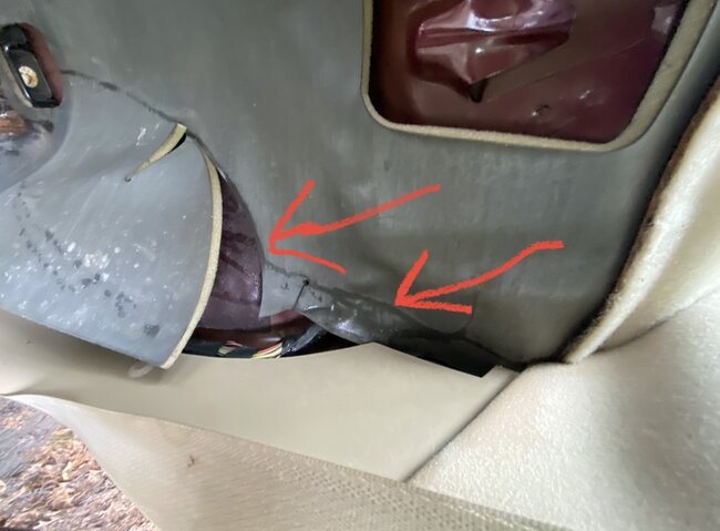

The carl listed above has a sunroof and carriage top. Multiple water leaks when raining or after washing it.
Sealed the passenger side cowl area which is prone to leaking.
Water is coming in from under the pedals, leaving a few rust marks on the carpet. And leaving the driver side front floorboard wet.

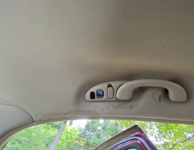

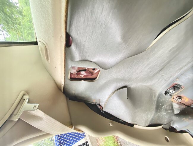

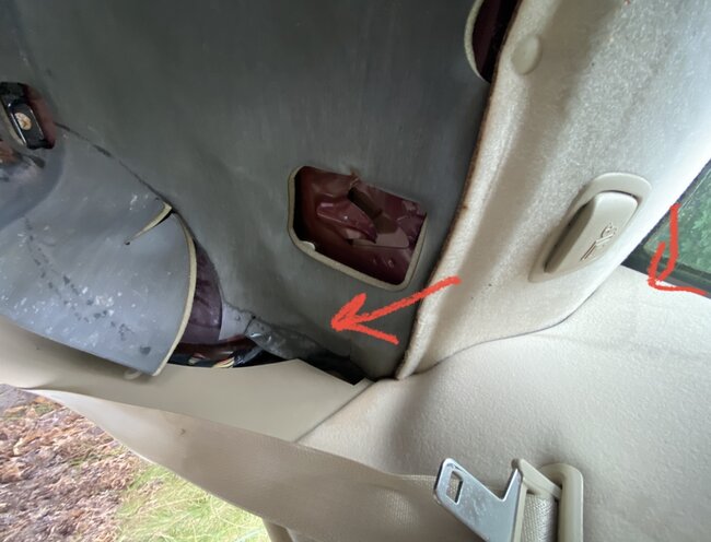

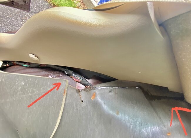

Also leaks from the “c” pillar on both sides (see picture) and water pools under rear seat.

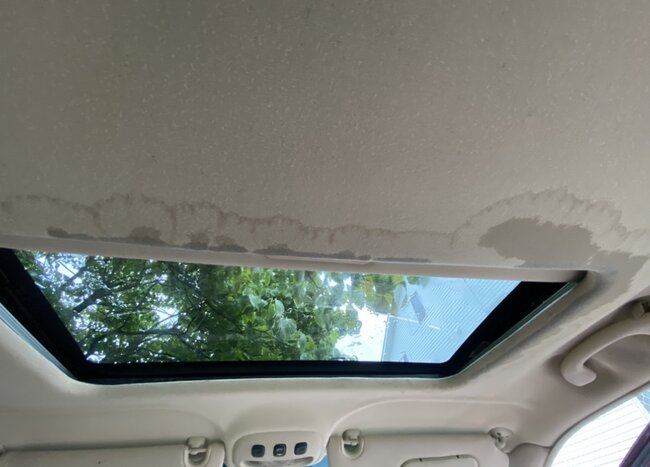

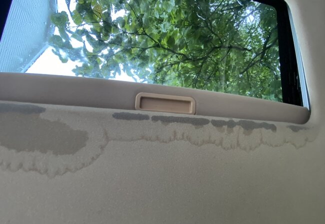

Headliner drips at the back end of the sunroof. (See picture)
Thanks in advance for reading and helping!

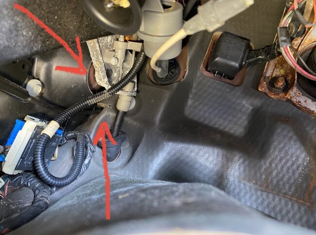

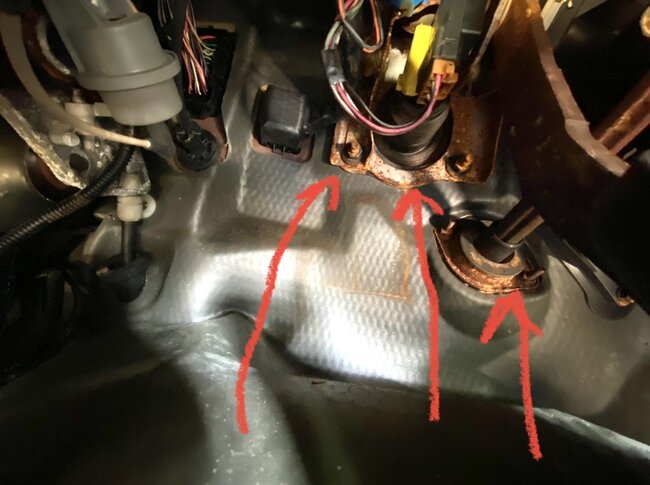

Here’s a picture of under the driver side dash board up by the pedals.

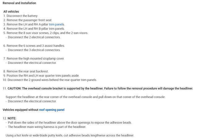

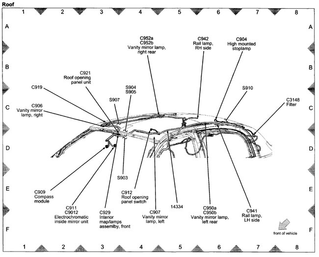

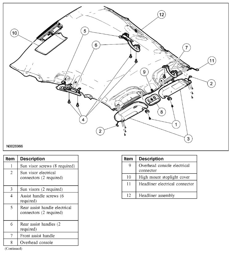

It looks like the sunroof drain hose is clogged up. How are the seals on the sunroof? I would remove the headliner so you can inspect the drains and have a better idea of where it is coming in at. You may have a windshield seal that is leaking as well. Check out the images (below). Let us know what happens and please upload pictures or videos of the problem so we can see what's going on.
