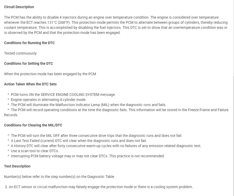

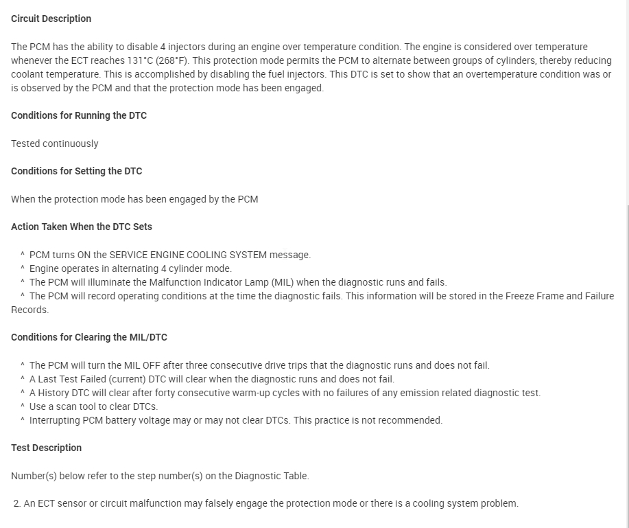

Diagnostic Trouble Code P1258 (Engine Coolant Overtemperature - Protection Mode Active) The only code and multiple times.
I should note that last year I had to replace the coolant recovery tank, and I did use the correct 'dex' coolant for my car, topping it off with a mixture of water and coolant, but not a measured mixture. I might have gone too heavy on the Dex
Thanks!
Jul 15, 2019 at 12:45 AM
Okay. This is good but to be sure we need a little more info that is stored in what is called the freeze frame data. An actual scan tool can pull this information. What this does is tells us what the PCM was seeing at the time the code was set.
The coolant mixture would not cause this. Most likely it is the engine coolant temp sensor or its circuitry to the PCM. The freeze frame data will hopefully confirm this so you don't waste any money and time on a sensor.
