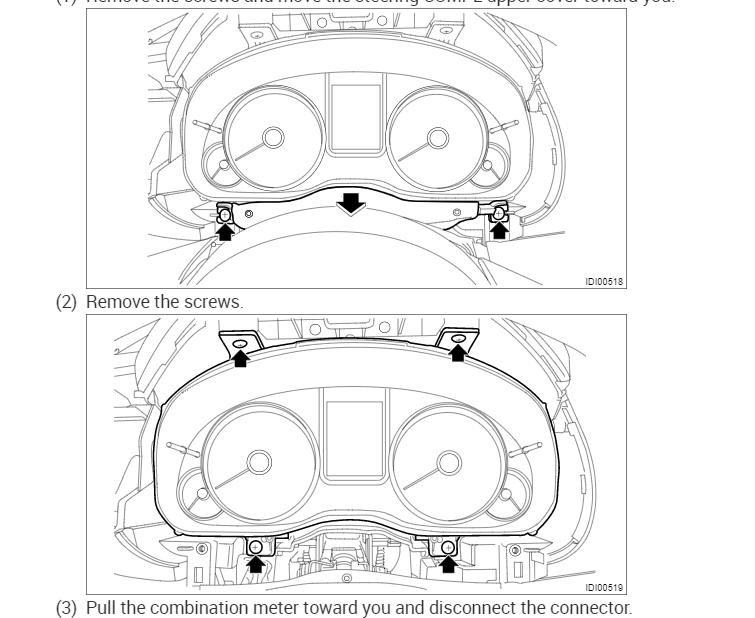

I have my check engine light on, cruise control flashing, at oil temperature, flashing, nonslip flashing, brake light flashing. I replaced the brakes about one year ago. I have replaced the battery about 10 days ago. I have not had this issue ever happen with this car.
It seems to be something electrical? But I am not sure.

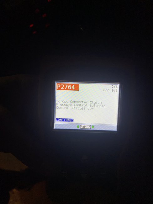

At times when trying to start the car it will turn on fine. Other times it was turned on and the engine will shut off. The lights to the car on the dash will still be on but the engine will not turn on therefore I will sometimes have to gas it when turning it on. I have taken it to advanced auto to get a computerized reading. Below is what I received.

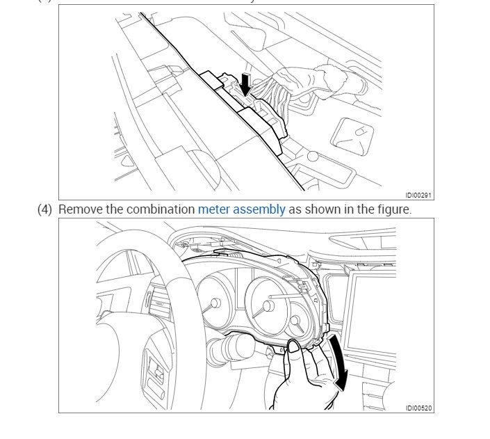

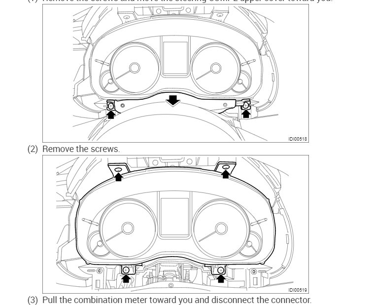

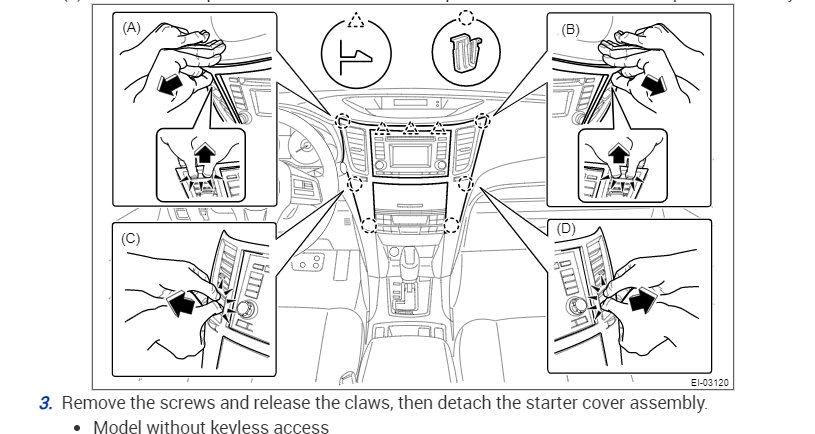

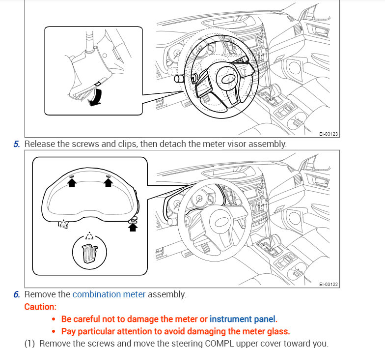

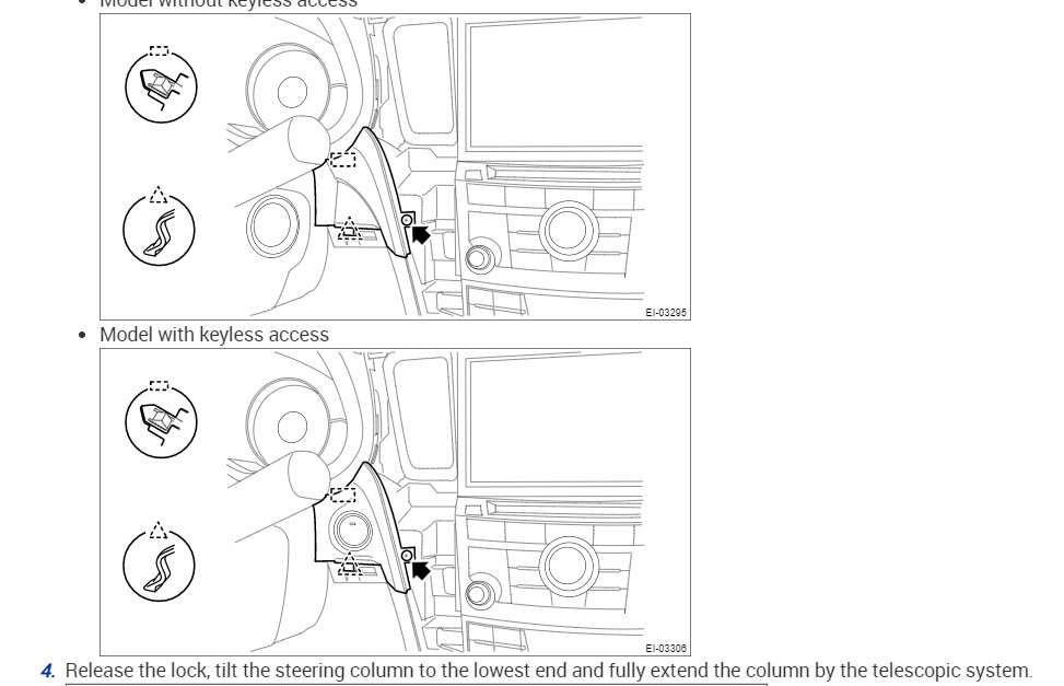

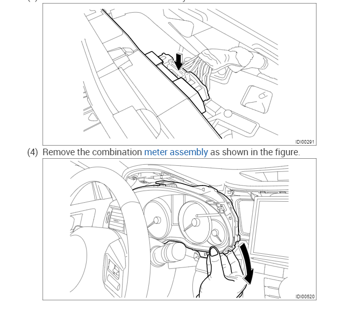

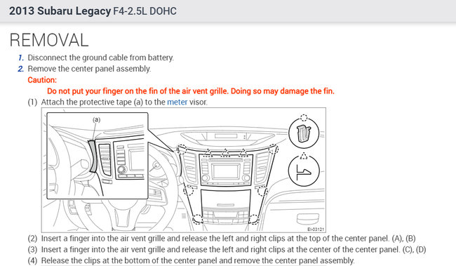

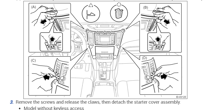

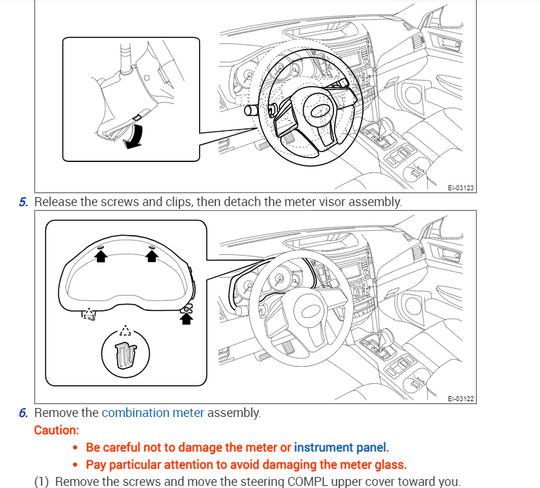

That code will not cause the issues you are having, it sounds like the instrument cluster is bad. To be sure let's do a CAN scan to confirm the issue. here is a guide and video that will help us fix the problem, also I have left the cluster replacement instructions in the diagrams below.
The code you have should go away once the cluster is replaced if not, please start a new question for torque converter clutch problem. Check out the diagrams (below). Let us know what happens and please upload pictures or videos of the problem.
May 31, 2022 at 10:40 AM

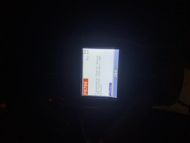

I also received this one. Does that pair with the previous comment as well?

Here is the dash.
May 31, 2022 at 12:00 PM
  • 54,832 POSTS
The cluster looks normal so it might be a BCM or PCM going out. We must do a CAN scan to be sure of the problem. here is the link, sorry I didn't include it in my first post.
Jun 1, 2022 at 11:01 AM
