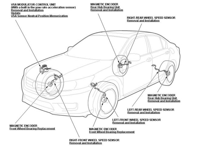

I have a 2013 Honda Accord with multiple warning lights turning on after a short drive. The lights that are turning on are ,brake light, abs light, traction control and power steering. Any idea why this is happening?
Aug 24, 2020 at 10:10 AM

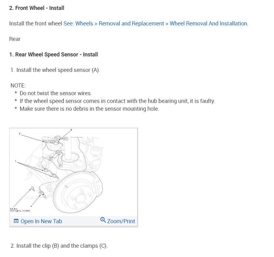

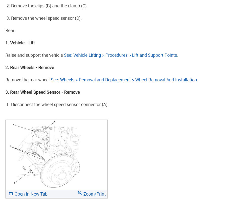

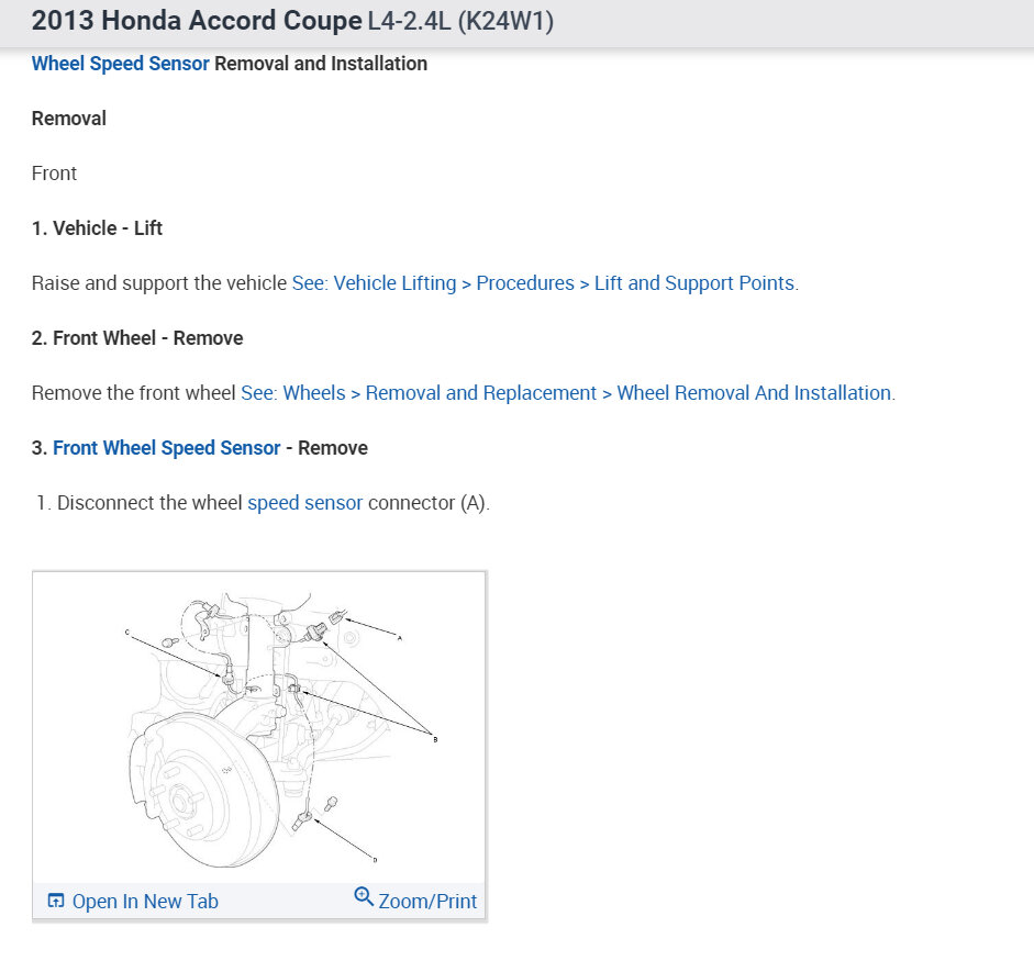

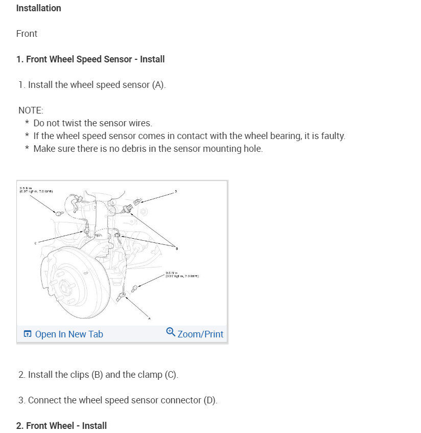

It sounds like you have an ABS wheel speed sensor that is not working, here is a guide to help you get the codes so we can see which one is not working.
https://www.2carpros.com/articles/anti-lock-system-testing-and-repair-abs
Here is how to change the wheel speed sensor out once you see which one the problem is. Check out the images (Below). Please let us know what happens.
