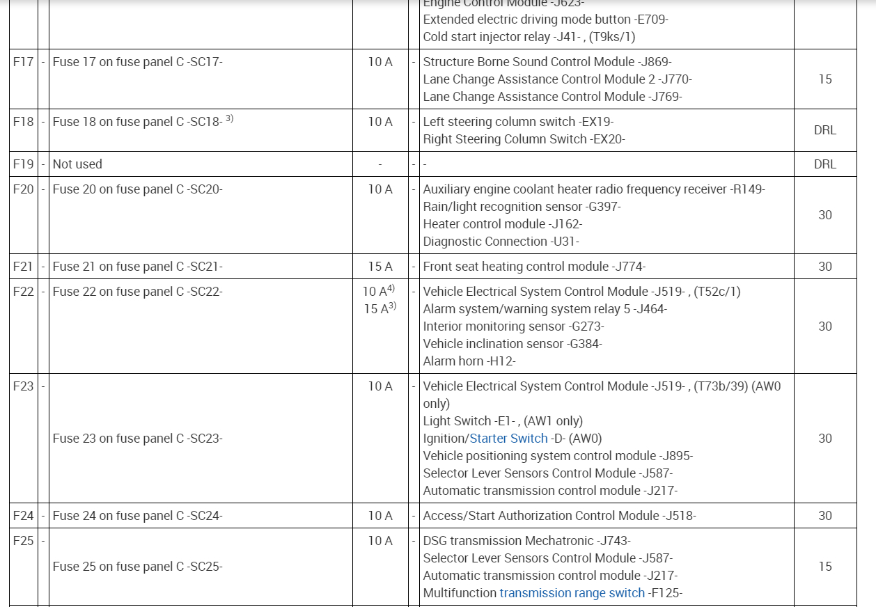

Multiple warning lights are on
31,000 MILES • 4 CYL • 2WD • AUTOMATIC
NINA PIANTANIDA

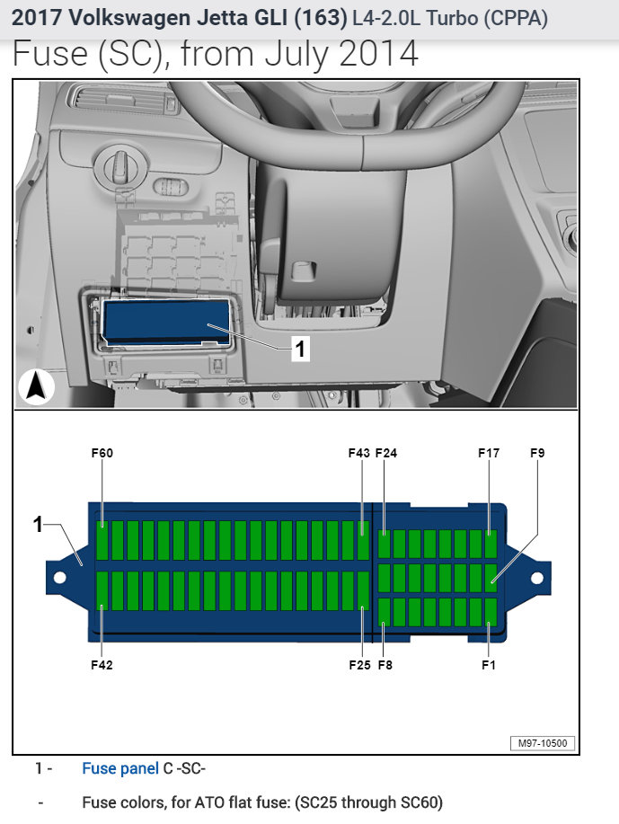

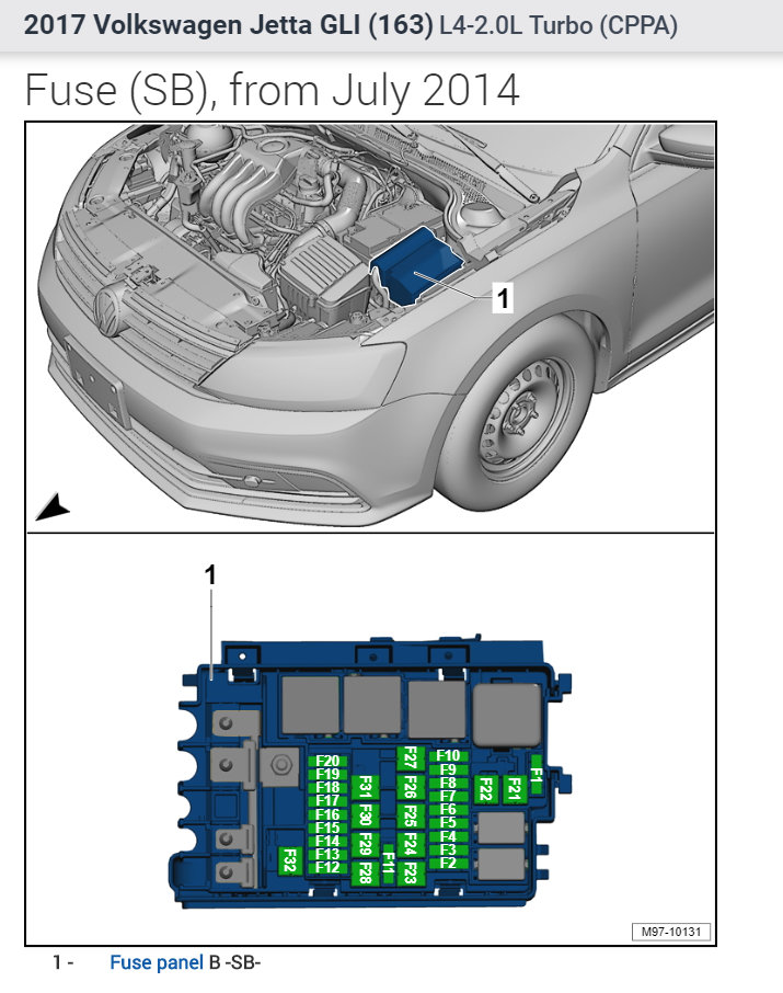

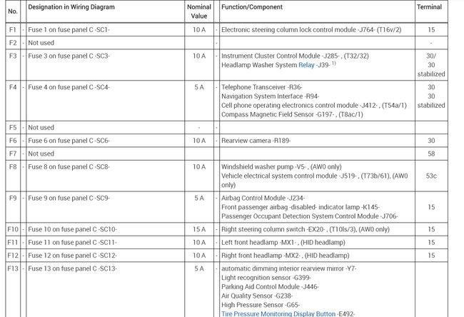

ABS, ESC, power steering, airbag and tire pressure warning lights are all on.
Jun 16, 2019 at 10:53 AM
  • 55,732 POSTS

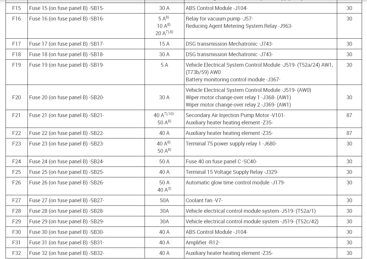

It sounds like you have a main system relay that is not working, does the engine run? Lets run the codes to see what comes up here is a video of what needs to be done:
https://youtu.be/rTtAnsOlZU4
and
https://youtu.be/gnSGfEqrf_w

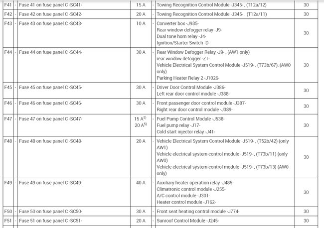

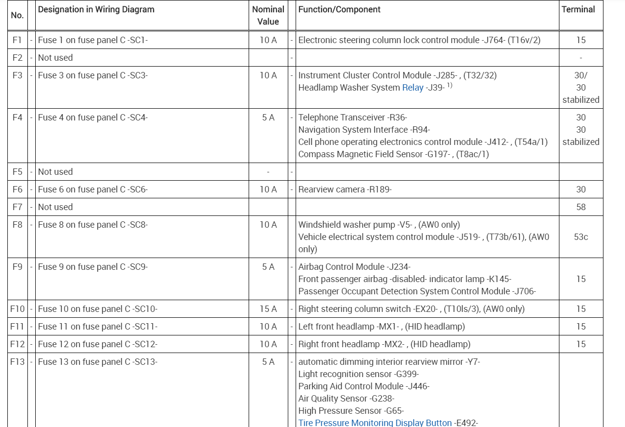

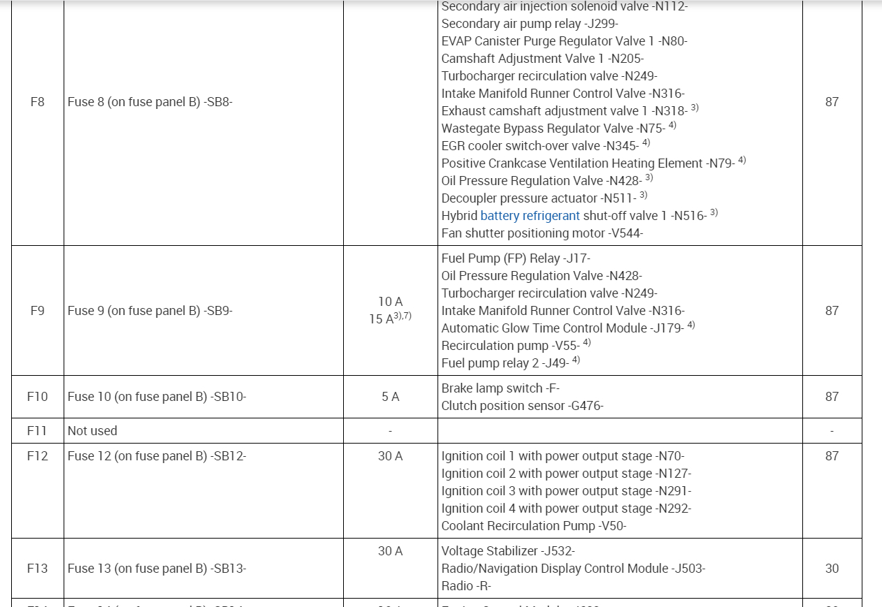

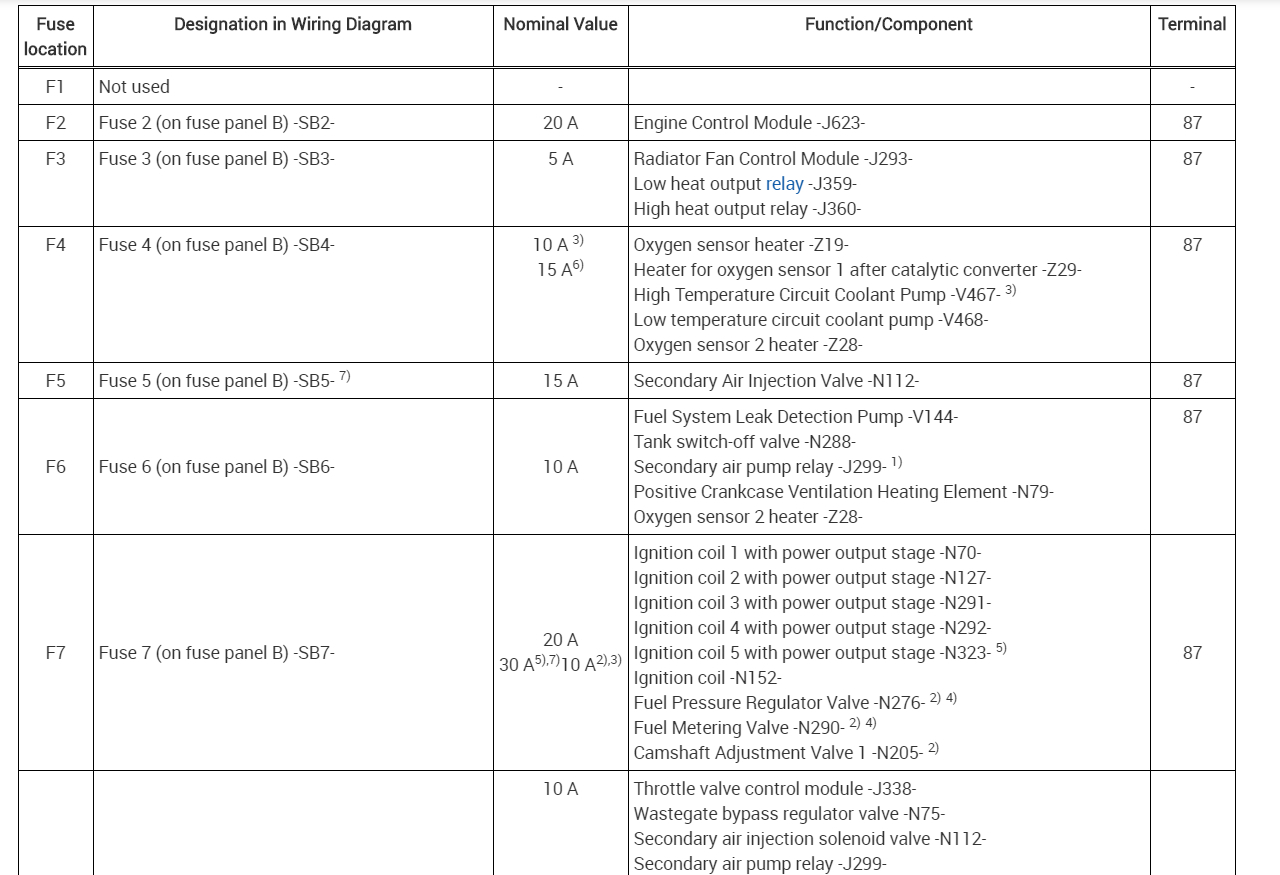

Also have you checked the fuses?

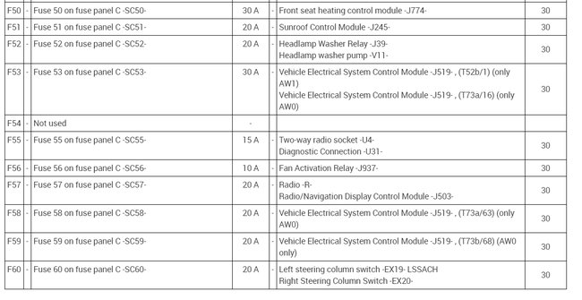

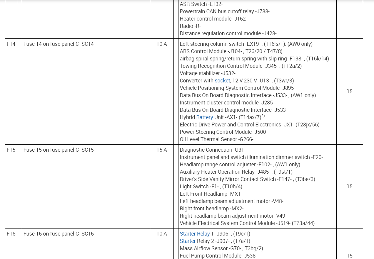

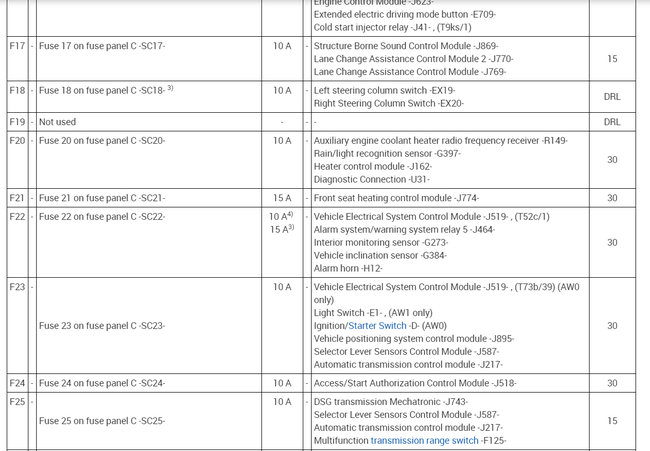

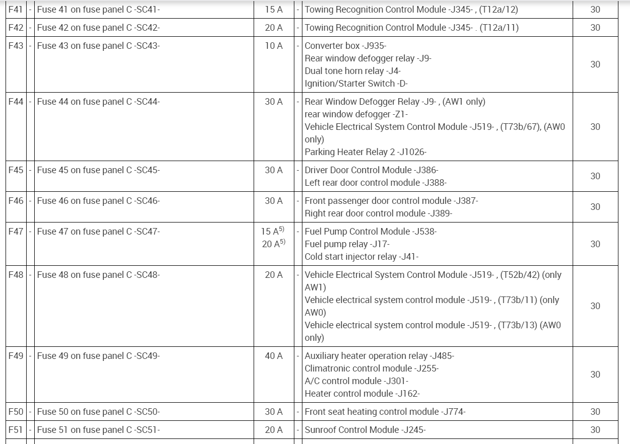

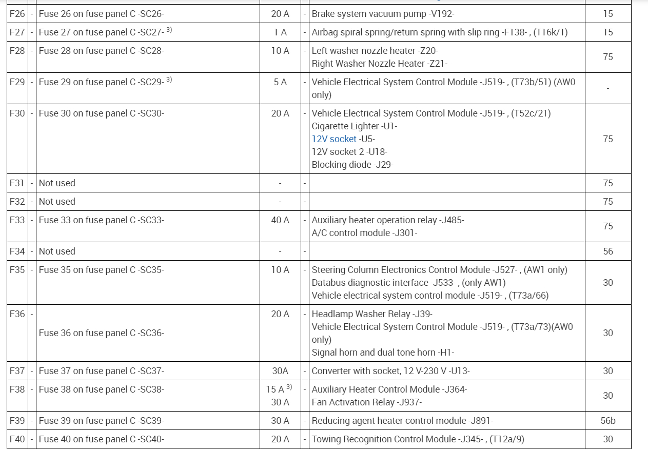

Check out the fuse locations below. Check out the diagrams (below). Please let us know what you find. We are interested to see what it is.
Jun 18, 2019 at 7:03 AM
