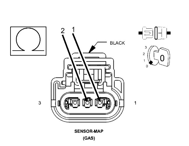

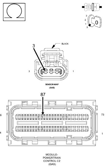

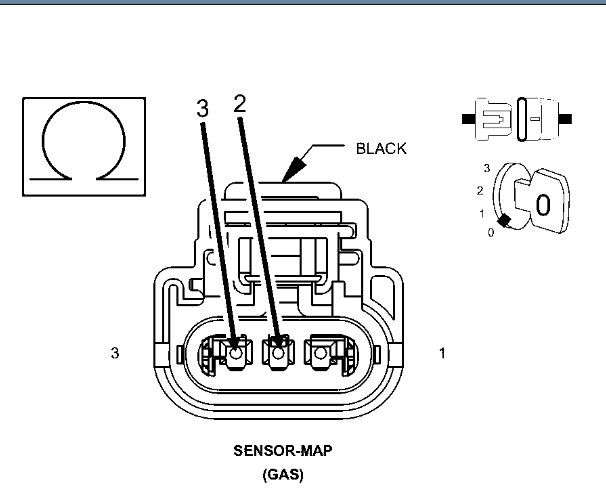

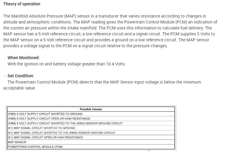

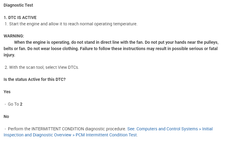

Traction control light, engine light and electronic throttle control light are on and sometimes blinking. Changed out the etc,spark plugs and ignition coils. car still idles a bit rough but most importantly lacks power when accelerator is fully pressed down.
Sep 21, 2019 at 7:28 AM
DANNY L
  • 5,648 POSTS
Hello, I'm Danny.
Having those lights on mean there are fault codes stored in your vehicles computer.First thing needed to do is retrieve the codes.If you don't have access to a scanner/code reader your local auto parts stores have a tool loaner program and can rent you one.Here is a tutorial showing what is involved:
Once that is completed get back to us with the code information and we can properly diagnose your vehicles problems.Hope this helps and thanks for using 2CarPros.
Danny-
Sep 21, 2019 at 8:01 AM
JOSHB15

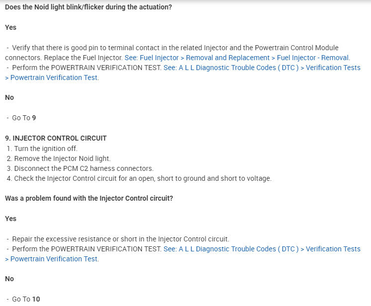

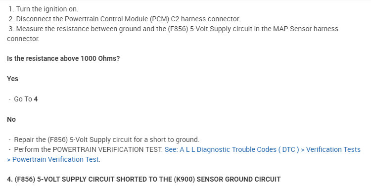

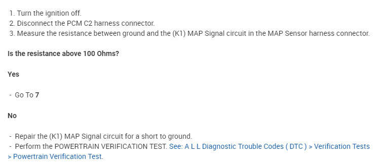

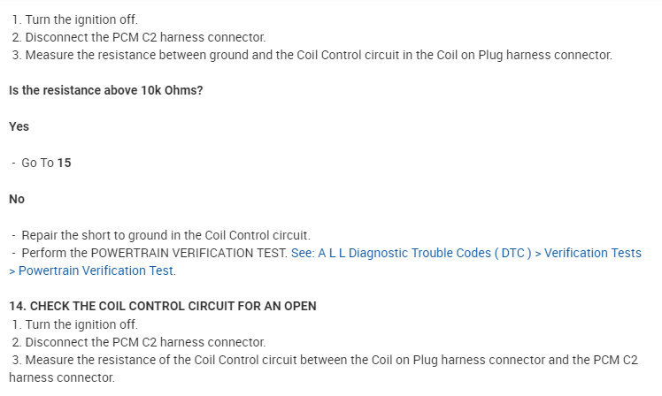

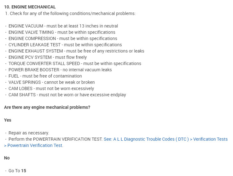

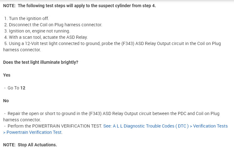

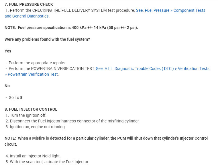

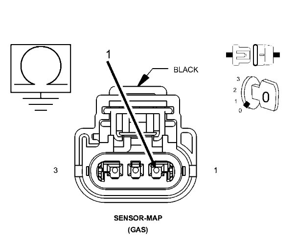

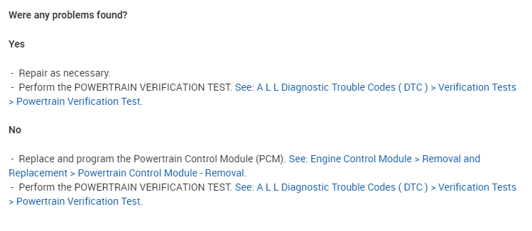

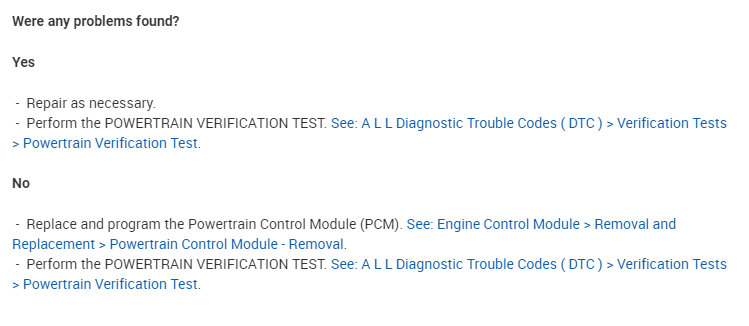

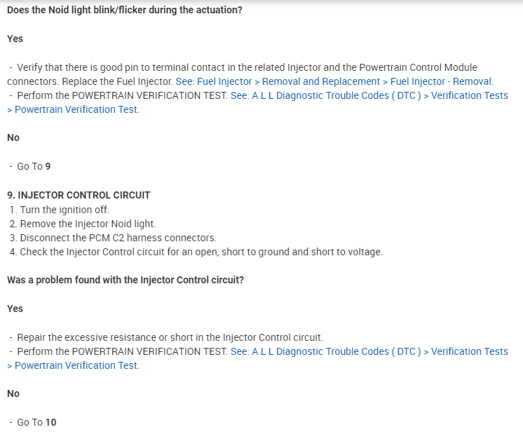

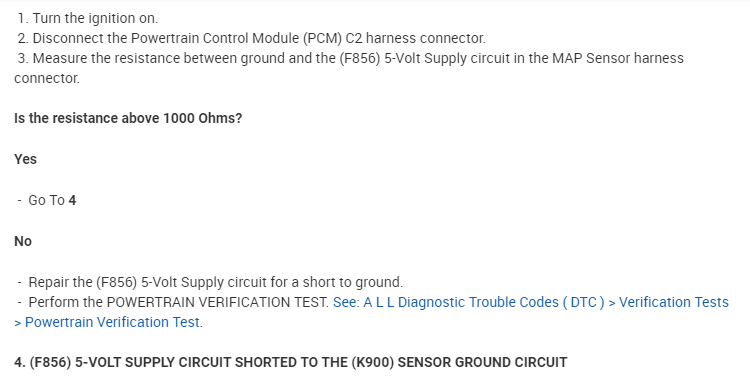

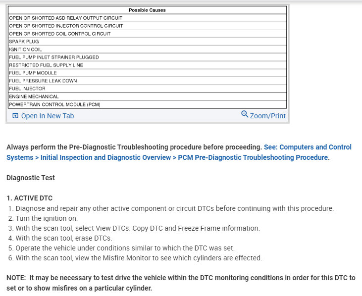

P0300 and p0107.
Sep 21, 2019 at 8:12 AM
DANNY L
  • 5,648 POSTS

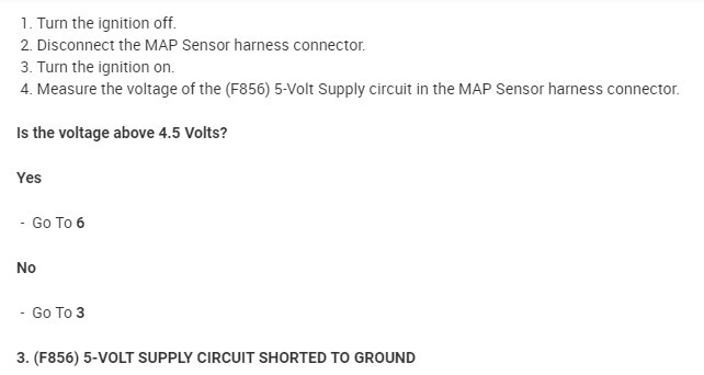

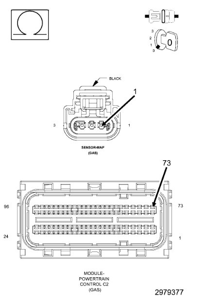

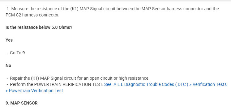

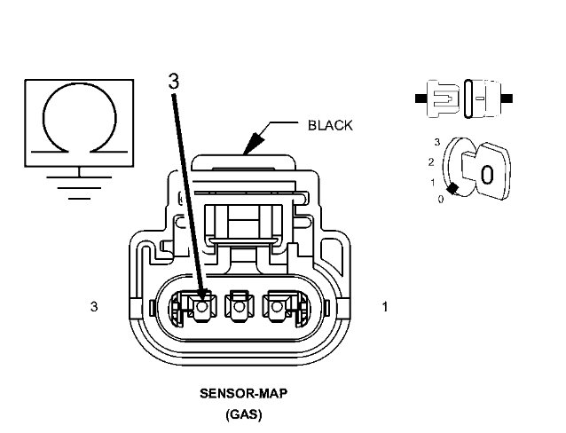

Hello again.

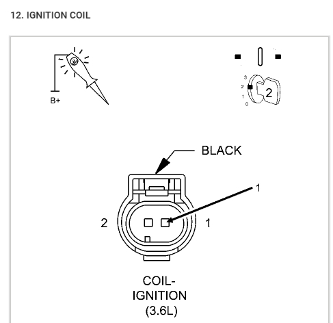

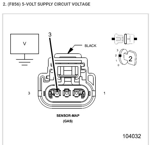

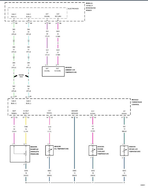

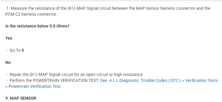

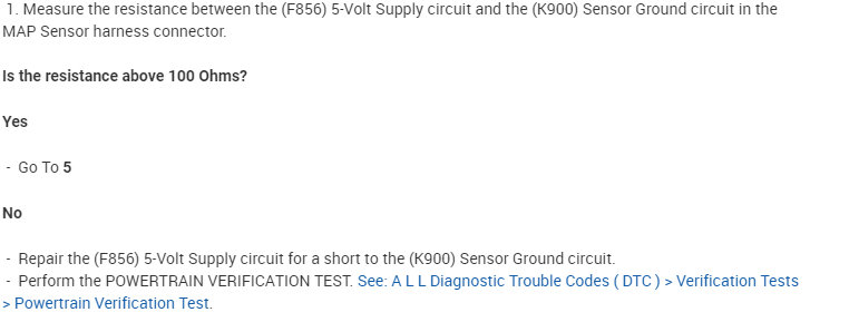

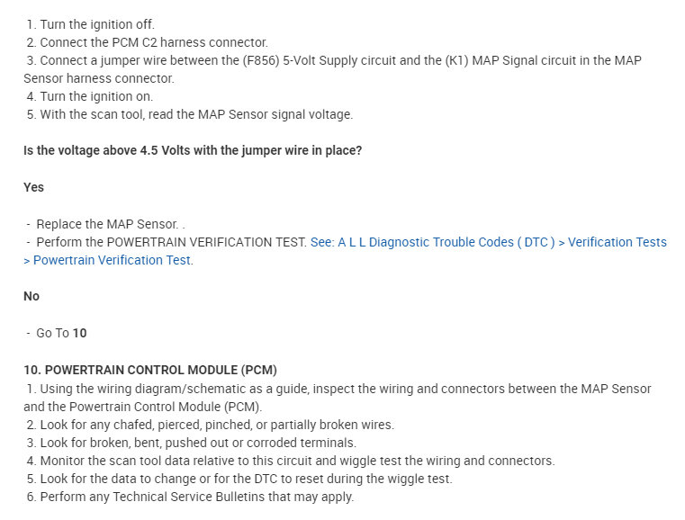

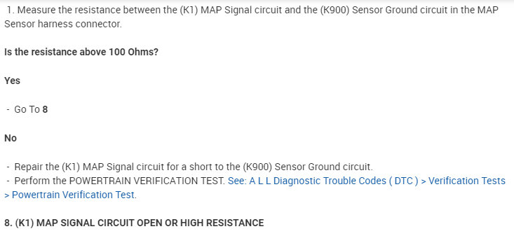

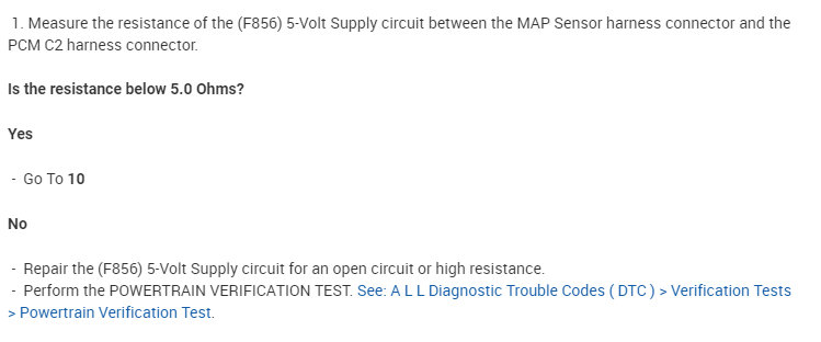

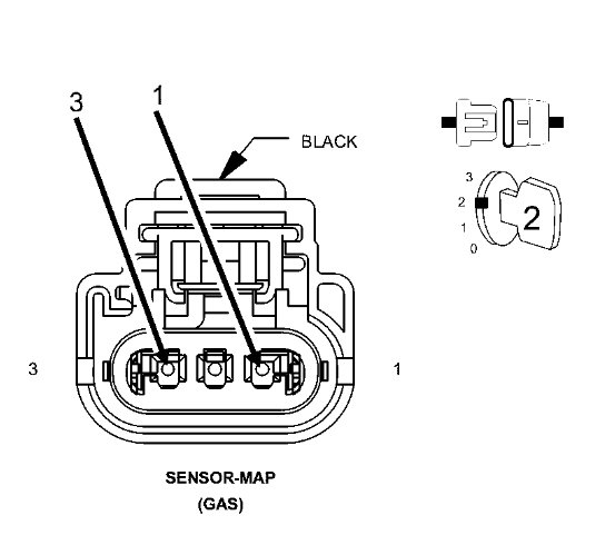

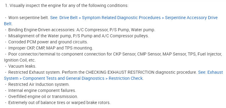

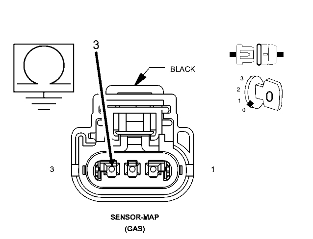

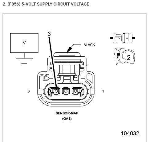

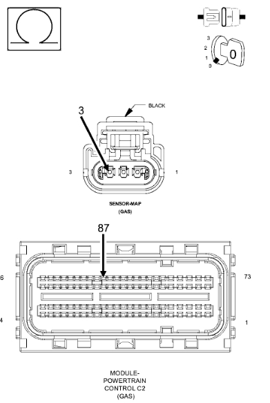

I've attached step-by-step instructions below for the P0107 code. Hope this helps and thanks again for using 2CarPros.
Danny-
Sep 21, 2019 at 1:00 PM
DANNY L
  • 5,648 POSTS

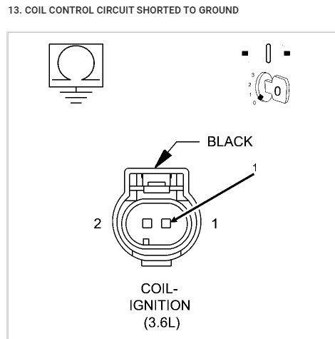

Hello again.

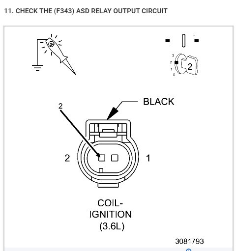

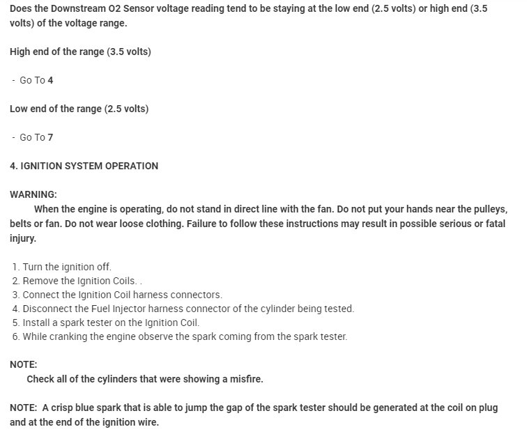

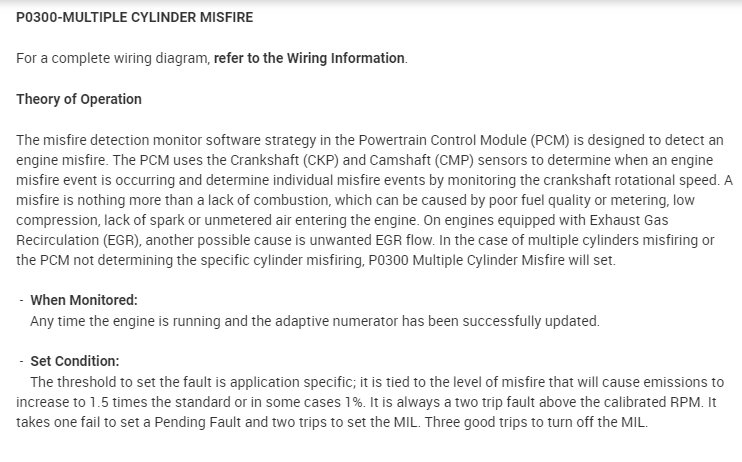

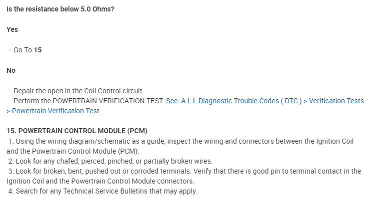

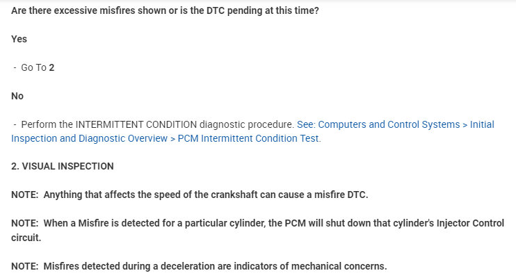

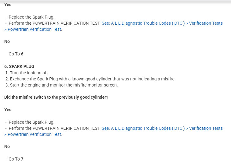

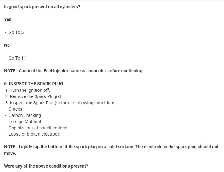

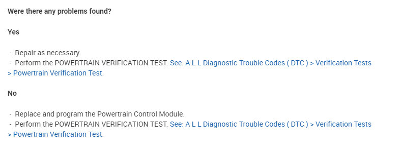

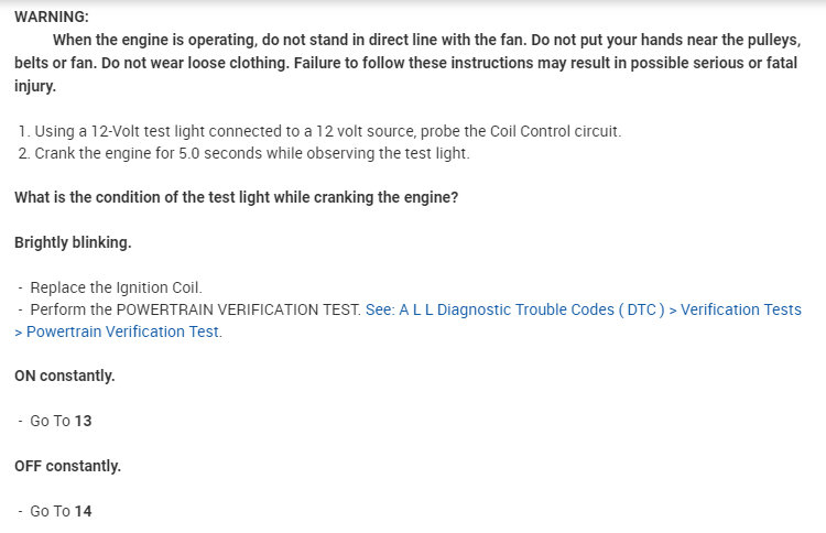

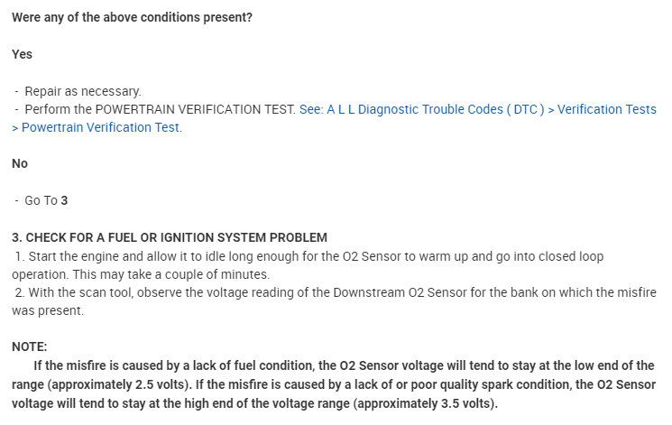

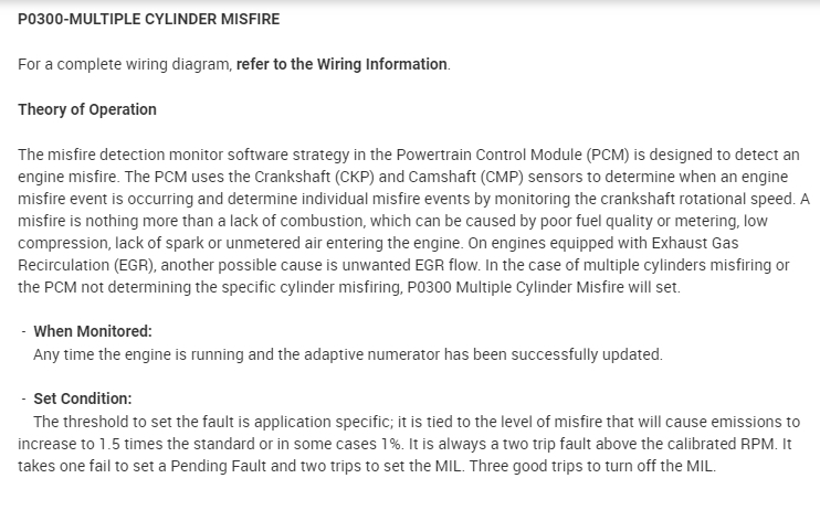

Here is a part 2 response for code P0300. See attached below. If you don't have access to a noid light set or a fuel pressure tester your local auto parts stores usually have a tool loaner program and will rent you one.Here are a few tutorials showing what is involved:
Again hope this helps and thanks for using 2CarPros.
Danny-
