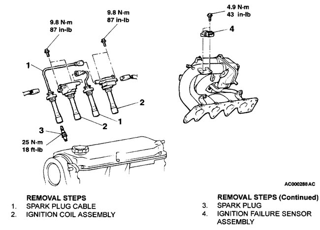

I got the P0355 code as an ignition coil problem which can cause the other codes, but I have seen the coil act poorly because of bad ignition components such as the spark plugs, wires and coils. I would start by replacing these components first and then clearing the codes. Can I ask how the engine sounds while cranking over? Can you please upload a short video of the engine cranking so I can see if the engine is hurt or not?

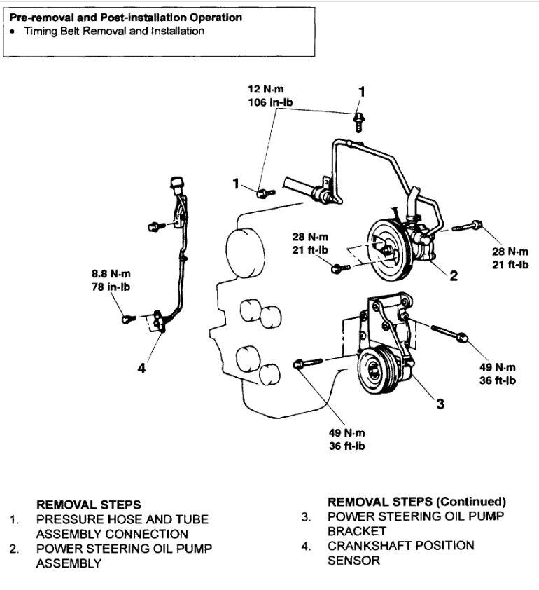

The trouble code P0335 for your 2003 Mitsubishi Galant indicates a Crankshaft Position Sensor "A" Circuit Malfunction. So, it sounds like the sensor has gone bad, here is the location and instructions on how to swap it out. But first the timing belt could have gone bad, the easiest way is to pull a spark plug and do a compression test, or if you can see the camshaft from the oil fill cap have a helper crank it over to see if it turns.

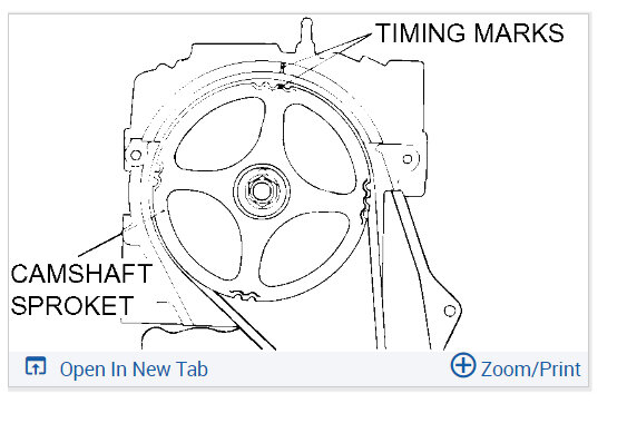

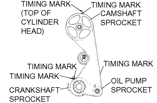

  • 55,732 POSTS
It sounds like the timing belt has jumped. Here are the timing belt marks so you can check it out. Also, did you check the compression this can tell us as well. Also, is the tune up okay, new spark plugs etc? Check out the images (below). Let us know how it goes.

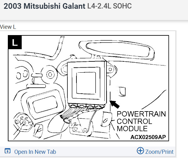

  • 55,732 POSTS
If the timing belt marks are okay and these codes both came up at once you may have a bad PCM I would send it in for testing. It seems thoughtful the wiring would be bad to both sensors at the same time. You might want to remove the electrical connectors and check them for corrosion. Check out the images (below). Let us know how it goes.
