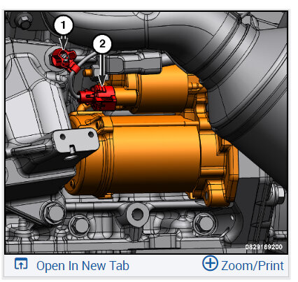

In the last month I have had 6 starters go out on me. The first one (the original) when we took the starter apart looked like an internal wire came apart. We have since replaced the starters with refurbished ones. They all work for a few days and then all burn out. I will push to start, and I get a loud click (almost thunk) sound and then white smoke from the starter. The wiring harness has been redone. There are no issues or drainage from the battery. Any advice to check or try would be appreciated!

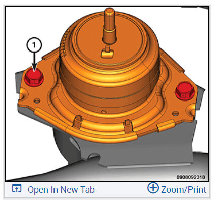

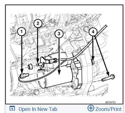

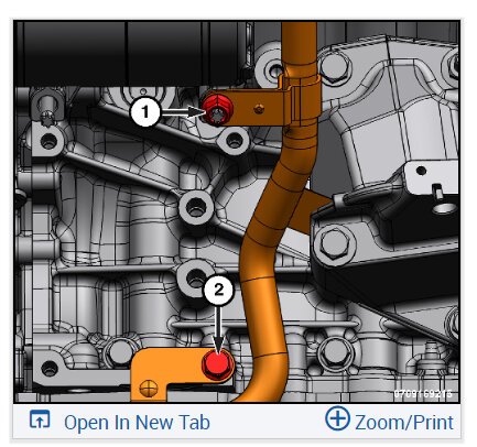

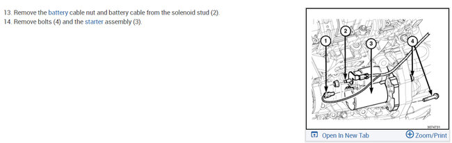

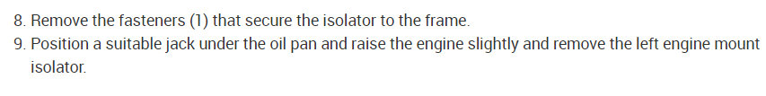

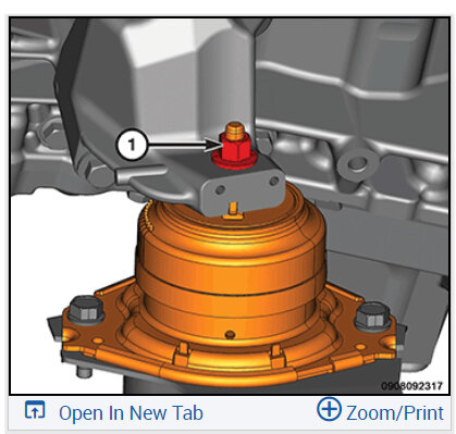

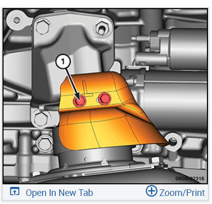

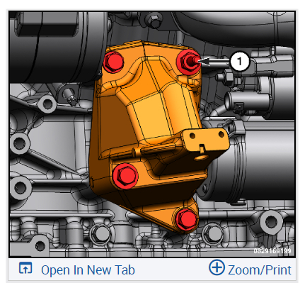

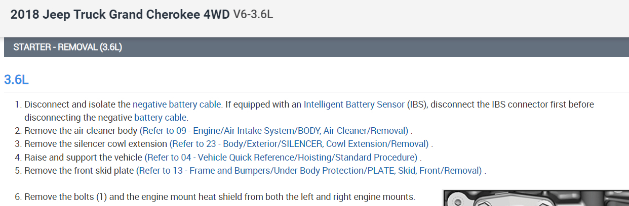

Yep, the only reason for this is bad starters, I would say the connections are bad but then the problem would be with the connection itself, I would make sure the connections are clean and tight at the battery and starter motor. Here is how to change the starter motor correctly. You might want to try a Denso or OEM unit. Check out the images (below). Please let us know what happens.
