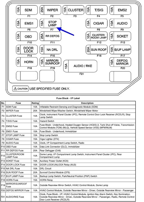

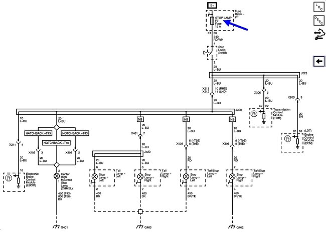

Fuse # 7 in the inside fuse box is for the stop lights. Start with checking that. You can use this article:
or, since we're only interested in one fuse, just pull it out and inspect it visually. If a new one blows again, we'll need to diagnose the cause. Let me know when it blows and how long the brake light circuit works before that fuse blows.
