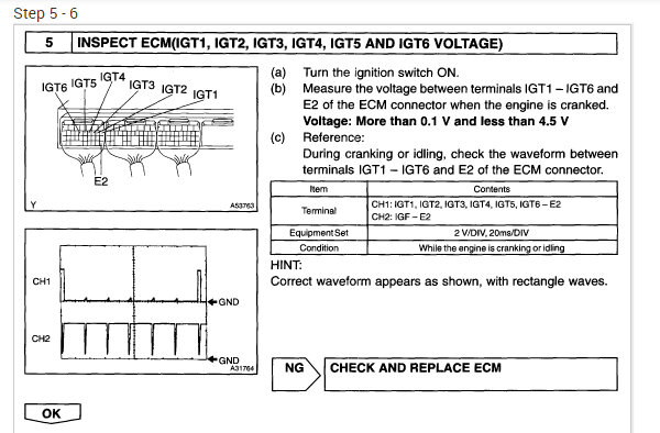

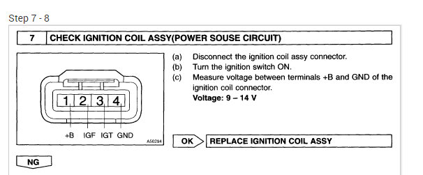

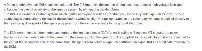

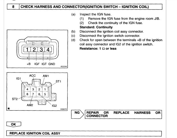

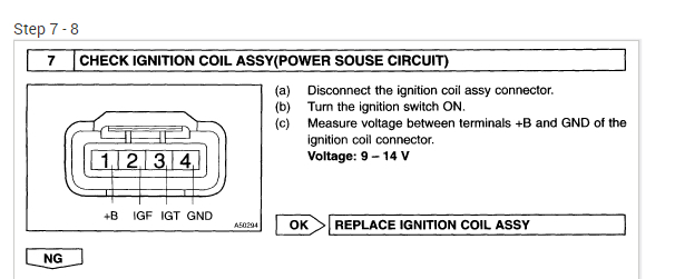

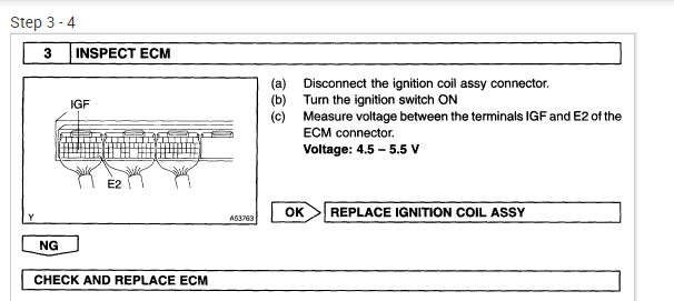

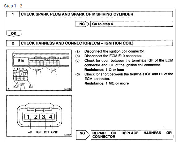

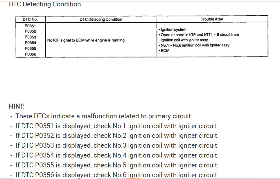

The original code indicates there isn't a feedback signal from the ignitor indicating the coil is working. I'm not sure what may have changed since the work was done. Have you checked to see if there are additional codes stored now?

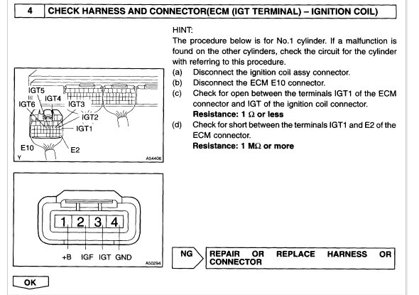

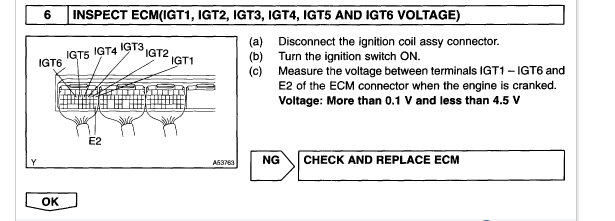

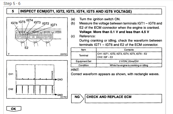

As far as testing, I attached the diagnostics for the P0351 code below. Note that all cylinders can be checked using the same process. Take a look through them and let me know if you are comfortable performing them.

For some reason, the PCM isn't getting a feedback signal that the cylinder is firing. Do me a favor. Switch the number 1 coil (New one) with cylinder 2. See if the code changes cylinders.

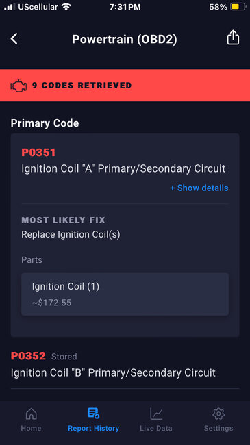

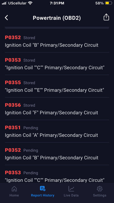

The codes are as follows, but I have another problem now my battery is dead so I have to charge it.

As far as the codes are concerned, the only active one is the P0351. That will require the diagnostics I attached above. Let me know if you are comfortable performing them. Additionally, let me know about the battery. Once it is recharged, you may want to have it load tested at a parts store. Most will do it free of charge.

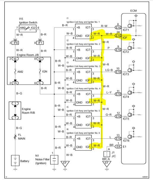

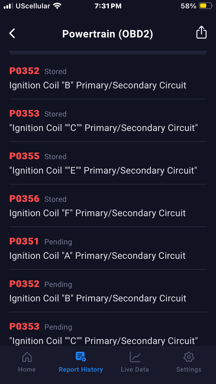

Okay, i have charged the battery and it's up to full cap now. i cleared the codes and the came back PO 351, PO352, PO 353, PO 354, PO355, and PO356.
Jun 27, 2024 at 9:33 AM
  • 110,240 POSTS

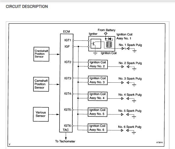

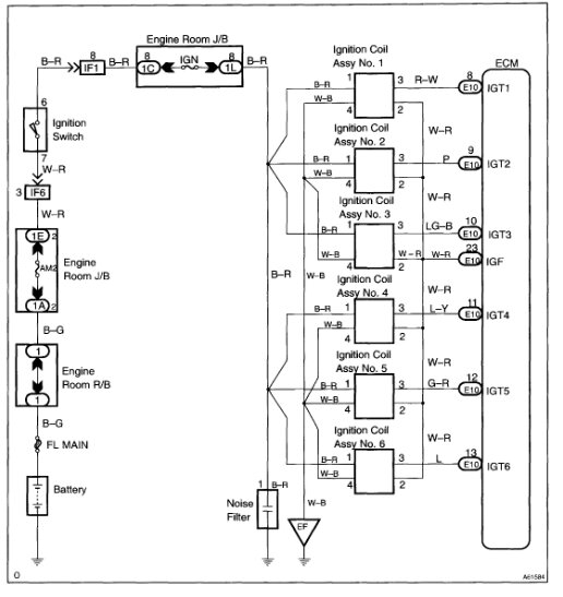

The ECM is indicating there is no feedback from any of the coils. It is very unlikely that all coils failed.
Since all six coils have a common IGF wire to the ECM, that is where I would start checking. The wire may be damaged or there could be an issue with a connector. Worst case is the ECM has failed.

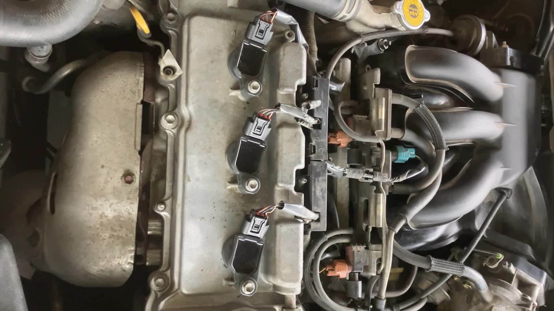

Each coil should have a white wire with a red tracer. This wire ties all of the coils together and then goes to the ECM. See if you are able to locate the wire I'm referring to and check it for damage.
See pic below.
Jun 27, 2024 at 1:28 PM

I'm not sure what you need. the wiring schematic above shows the coils and the wire colors.

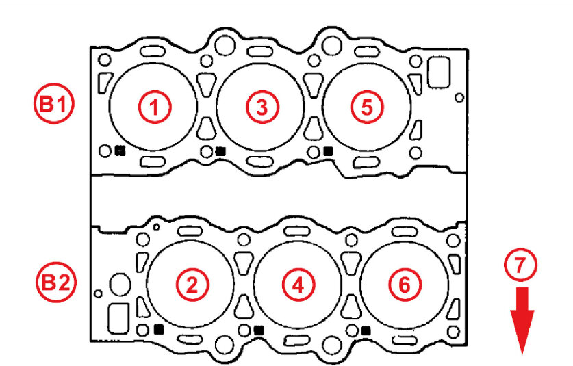

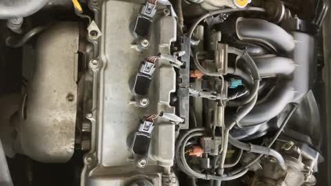

If you follow the IGT wire back to the ECM, it shows IGT 1, IGT 2 and up to six. Those are the cylinder numbers. If you look at the pic below, I included the cylinder configuration. That way you will know which cylinder to look at. Additionally, the arrow in the picture points toward the front of the vehicle. Therefore, bank 1 is nearest to the firewall.
Let me know if this helps.
joe
See pic below.
Jun 29, 2024 at 12:32 PM

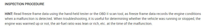

Do you notice any dark smoke from the exhaust or odd smells from the exhaust? If there are no codes, this will get a little more difficult to diagnose.
