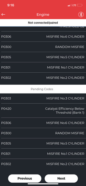

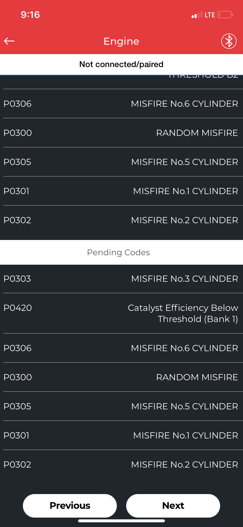

I just scanned my check engine light and I got 4 misfire codes for cylinders 1, 2, 5 and 6. I just replaced my spark plugs and ignition coils about 20,000 miles ago.

I looked at the pics you attached and noted a P0420. That is related to the catalytic converter. Is the misfire something that started all at once? I'm asking simply because I question if the catalytic converter may be partially plugged causing problems.
Also, keep in mind there are many things that can cause a misfire. Low compression, fuel pressure, vacuum leaks and so on. Is the scan tool you have provide live data? If it does, can you tell me what the short term fuel trims are?

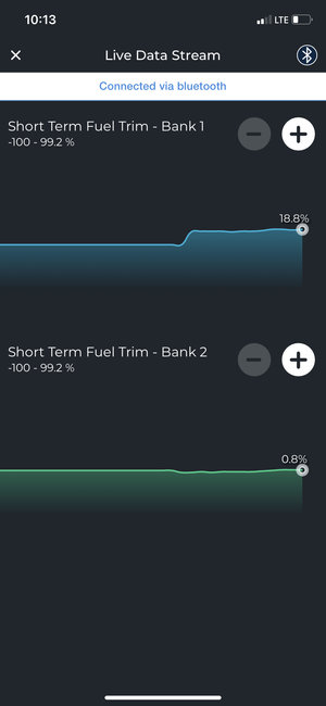

The P0420 code has been on for a couple years. The cost of that repair outweighs the value of the car and has never affected the driving. This rough acceleration issue started yesterday and I got to scan it today. The CEL is flashing. I have attached a picture of the live data.

The trims seem high. Are you able to check fuel pressure? The computer is trying to remove fuel frim the mixture which, in this case with multiple misfires, may indicate a bad regulator and high pressure. Under normal conditions, they should range in the + or - 10%.

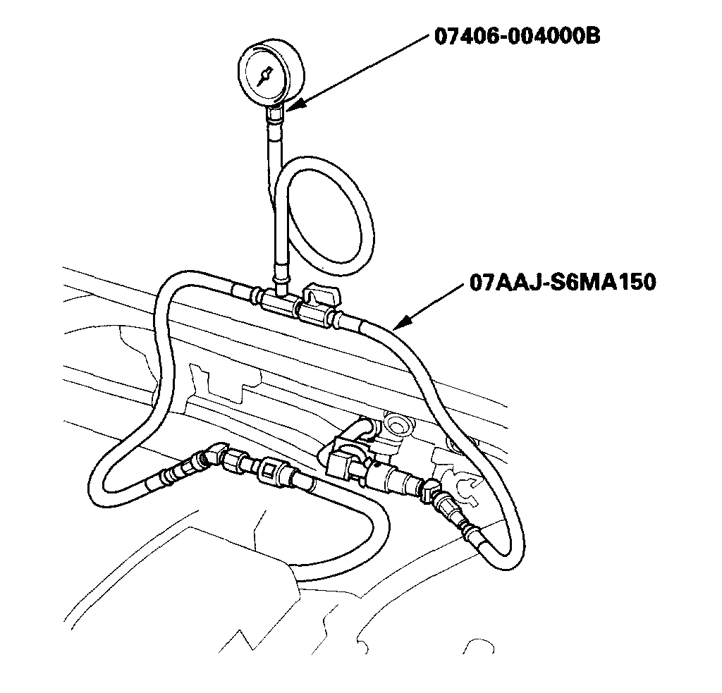

Here are the directions specific to your vehicle for testing fuel pressure. The manufacturer's specs are listed in the directions. The attached pic shows location to attach fuel pressure gauge.

Let me know what you find.

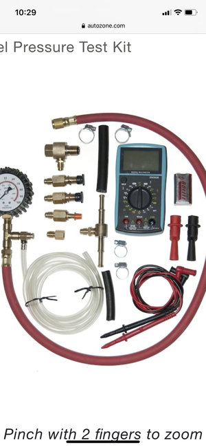

Okay, I must not have the right testing equipment from AutoZone. There is no way to hook up this gauge to the fuel system. I just sprayed fuel all over my engine and nothing registered on the gauge.

That isn't good. Can you take a pic of what you have so I can see it? Also, they should have the connectors for both ends of the fuel supply and a T to join the gauge to them.

I screwed the T connector into the end of the gauge which fit perfect. The fuel line from the tank had an open narrow end so I put that end into a piece of provided hose. And the other end of the short hose into the brass T. The hose going to the engine had that quick connector end which fit over the Brass T, but there was not a tight fit so that’s where fuel shot out of.
Oct 19, 2020 at 1:34 PM
  • 110,240 POSTS
Did it leak from the side that went to the engine? If so, check to make sure the o-ring in the connector isn't damaged or missing.
