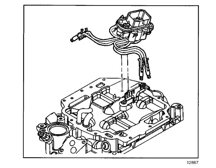

I have replaced my spark plugs, my wires, my cap and rotor. got the check engine light to turn off and passed inspection. then today check engine light came back on and truck was running rough like the multiple misfire came back. What should I do next or is there nothing else I can do?

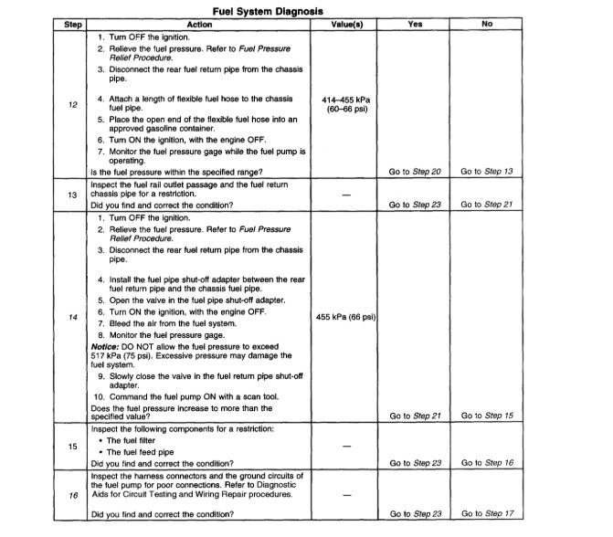

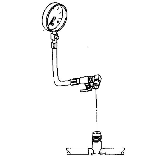

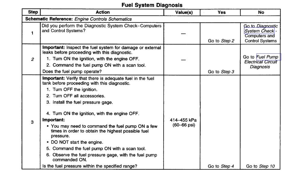

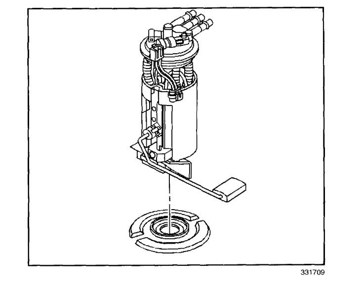

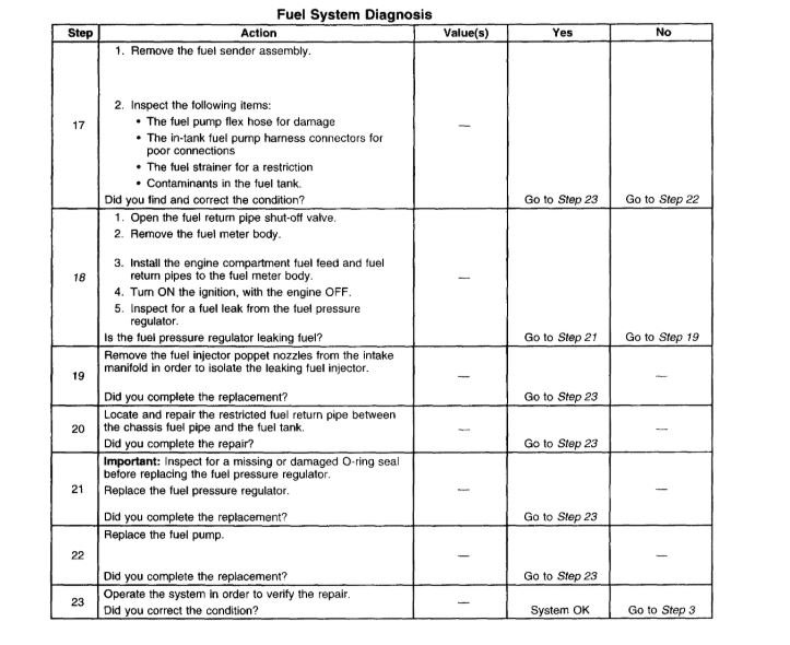

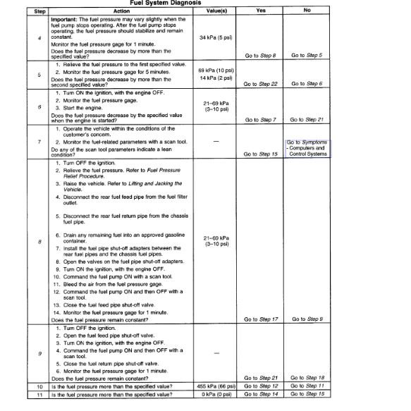

I would check the fuel pressure. Low fuel pressure is the most common cause for this issue.
I attached a flow chart for the fuel system fr you to follow and you need a gauge to hook up to test the pressure. It could be the fuel pump or the spider assembly.
