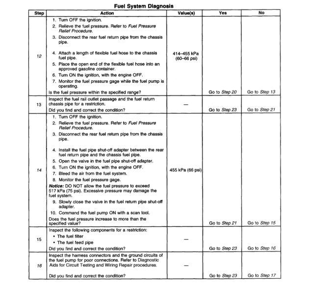

I have replaced my spark plugs, my wires, my cap and rotor. got the check engine light to turn off and passed inspection. then today check engine light came back on and truck was running rough like the multiple misfire came back. What should I do next or is there nothing else I can do?
Feb 6, 2020 at 9:36 PM
Good morning,

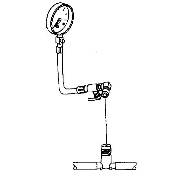

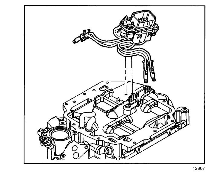

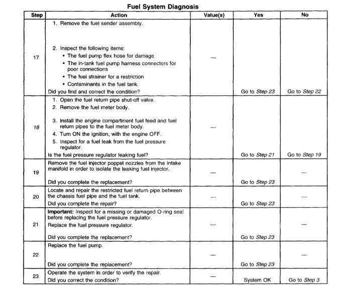

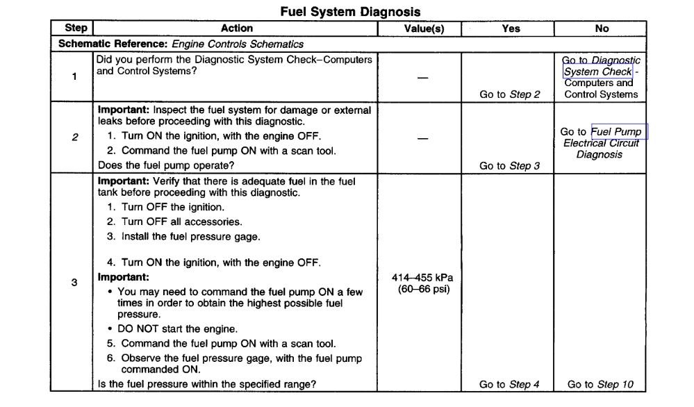

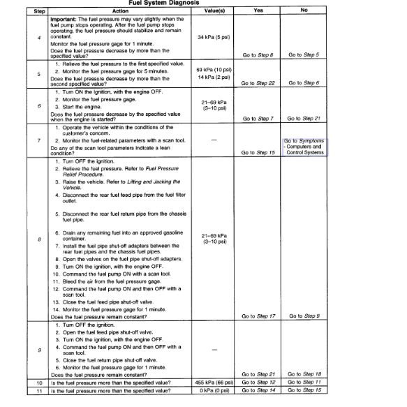

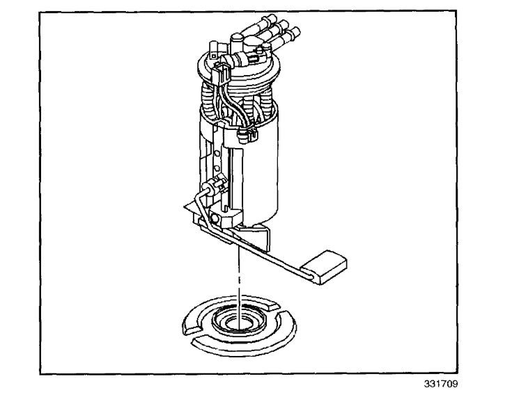

I would check the fuel pressure. Low fuel pressure is the most common cause for this issue.
I attached a flow chart for the fuel system fr you to follow and you need a gauge to hook up to test the pressure. It could be the fuel pump or the spider assembly.
Feb 6, 2020 at 10:32 PM
STIVALE91
I replaced the coil earlier today and disconnected the battery to reset the code. Now I’m just waiting to see if the code comes back. And I don’t know if it’s a fuel issue because it only runs rough at idle when I hit the gas and let off it’s fine but when it’s at idle it wants to shut off.
