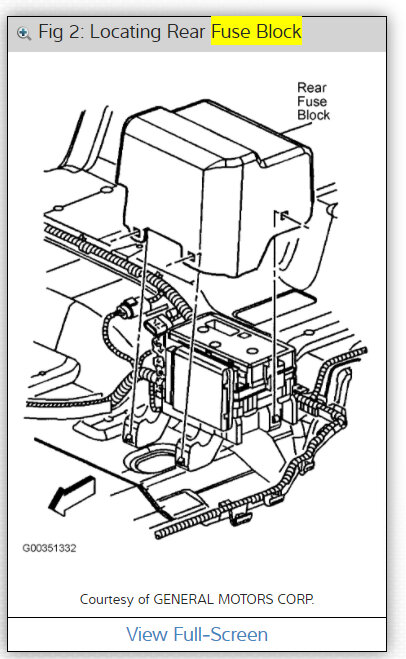

This vehicle has multiple issues which appear to be electrical. Speedometer, power seats, radio, locks, and other features don't work. I haven't checked fuses yet, but it occurred to me with so many things not working it might be ECM related. Is this possible and could it affect transmission? No upshift from 2nd. The truck also stalls after running for a few minutes. Haven't checked spark when it happens yet. We're suspecting crank sensor, but could all these be related? Right now, we are in a deep freeze here. Lol

Yep, the county is under snow for the most part, so hang in there. We must check the fuses first.

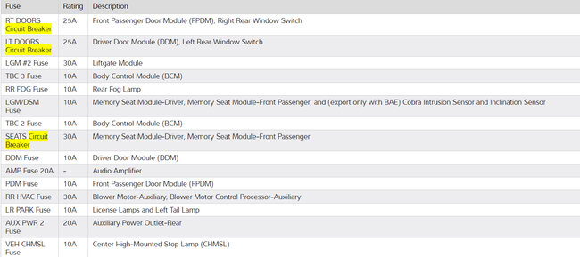

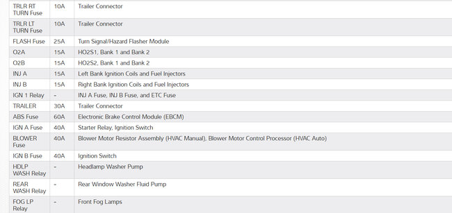

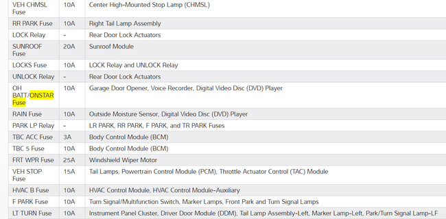

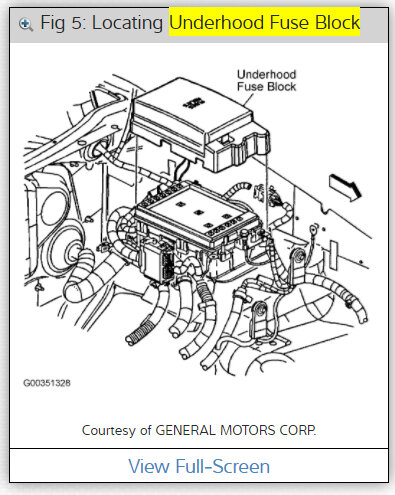

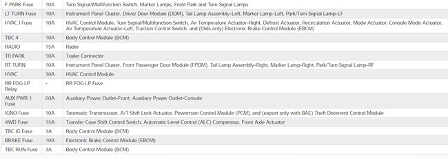

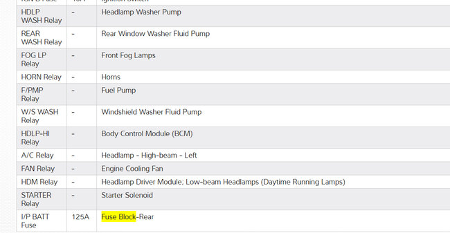

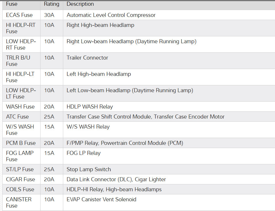

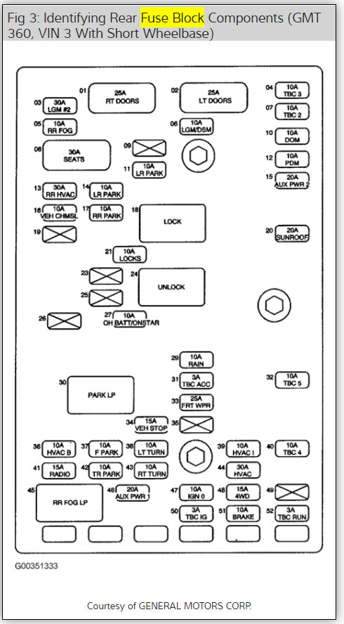

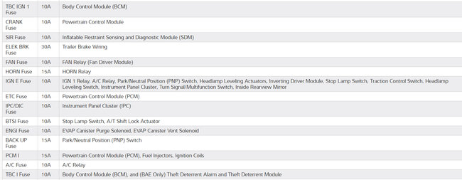

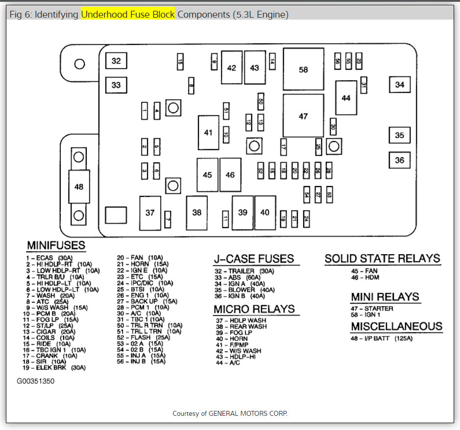

Here is a guide and the fuse locations as well:
There is a driver's door module that sounds like it is not working or the battery fuse 125 amp in the under-hood fuse panel has gone out. Please check the fuses with the key on. Check out the images (below). Please let us know what you find. We are interested to see what it is.

I found the 125A mega fuse blown. After replacing it power windows, seats, gages, radio work. Car won't start, haven't checked fuel or spark. Would that fuse power the PCM and be a possible source of the failure to upshift from 2nd? It looks like there is some wires broken going to a sensor on the transmission. Would doing a complete reset be advisable? If so what's the easiest way to do it?

Yes, that can cause it we can do a hard reset of the system which is easy by removing the negative side of the battery, with the cable loose from the negative side of the battery, hold it to the positive terminal for 1 minute this will discharge the memory capacitors in the BCM and PCM allowing the system to reboot. I would fix the wiring at the sensor first though. Can you upload an image of what you are seeing?

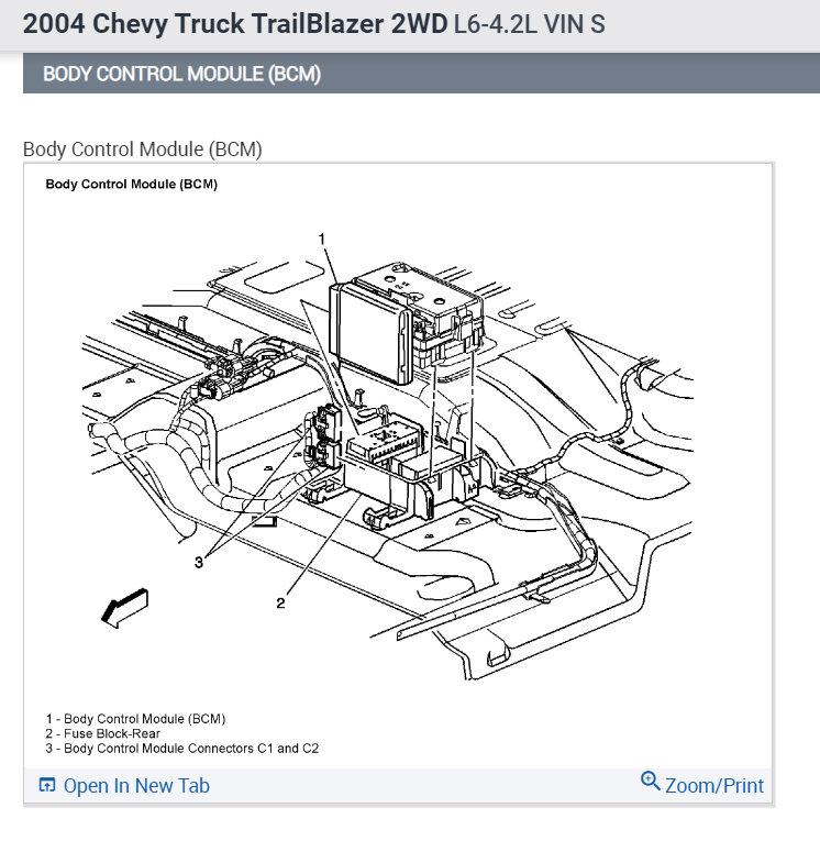

It sounds like the BCM is going out, I would try to get the engine running again and then tap on the BCM to see if the engine stalls here is the location, also let's do a CAN scan this guide will show you how (it is easy).

Please check the images below and get back to me when you can.
