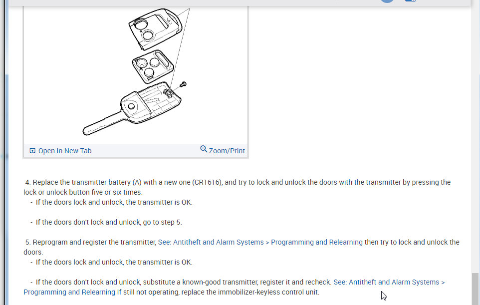

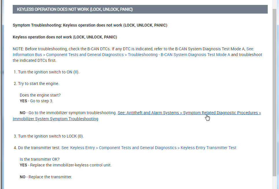

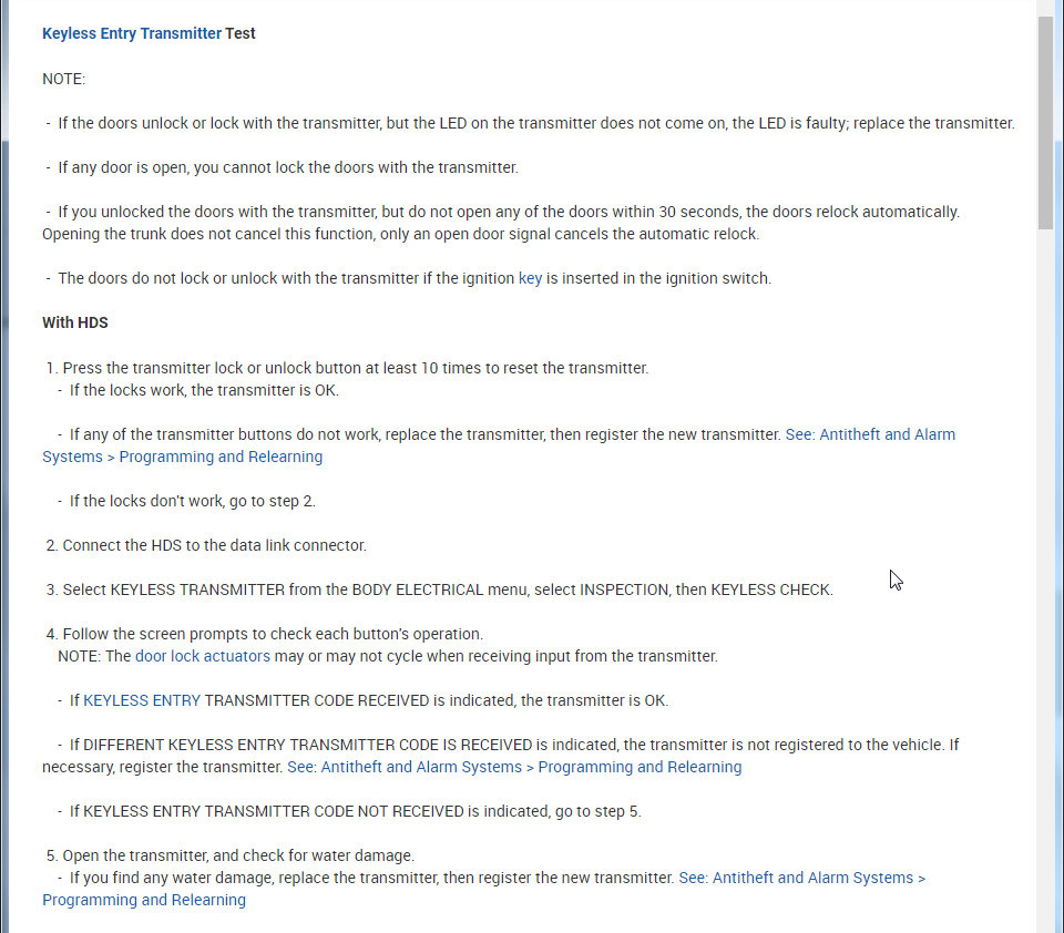

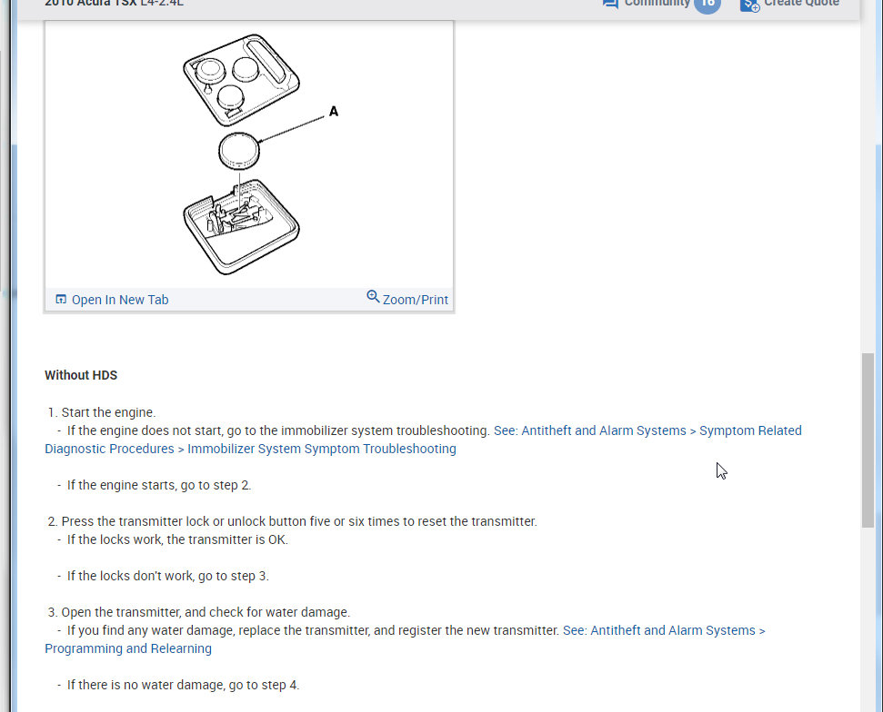

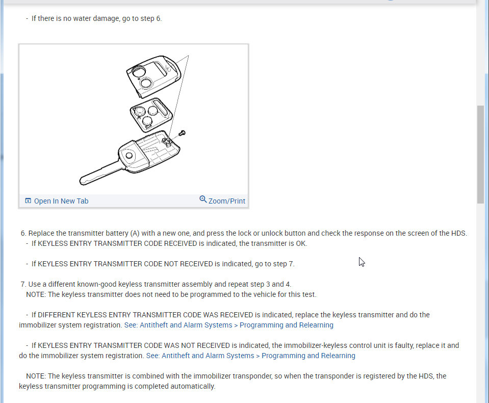

It is possible that these issues are all related but we need to start with fixing one of them and then if that fixes all of them then that is great. If not we need to move onto the next issue.
I would suggest starting with the keyless entry issue. That is most likely the easiest and likely to cause all of them so it is the best place to start.
Below are tests that we need to run through in order to determine what the issue is.
Let me know what questions you have and we can work through them. Thanks
