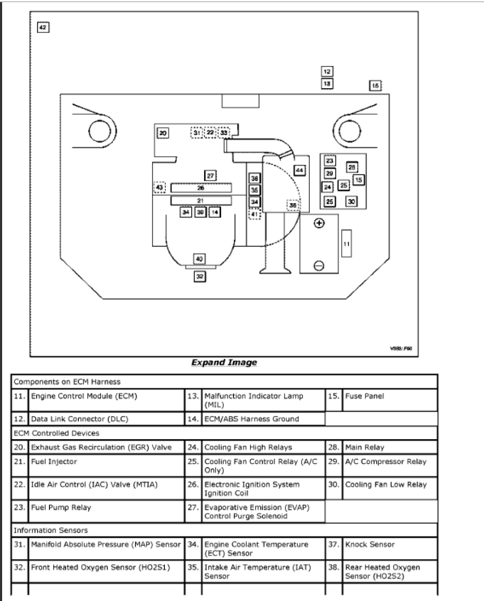

Hey everyone,
The vehicle has the following error codes:
P0404 - Exhaust gas re-circulation open.
P0175 - Fuel system too rich (bank 2).
P0172 - fuel system too rich
P1172 - Secondary fuel pump insufficient.
P1175 - Fuel trim system balance bank.
P0106 - Mass air flow sensor (MAP).
I was wondering what would be the next steps. I would like to disclose that the MAP and MAF sensors have been replaced once already. I have replace the O2 sensor on this car at least three times. I have taken this car to three other shops as this problem continues after spending all this money. Lastly, one shop had me pay for a Suzuki specialist to drive down to the shop to program the computer which speaks to the engine for programming issues with air flow take.
Symptoms: The car rides rough, stalls when making turns, stopping at a red light or just out of nowhere.
Please let me know your thoughts?

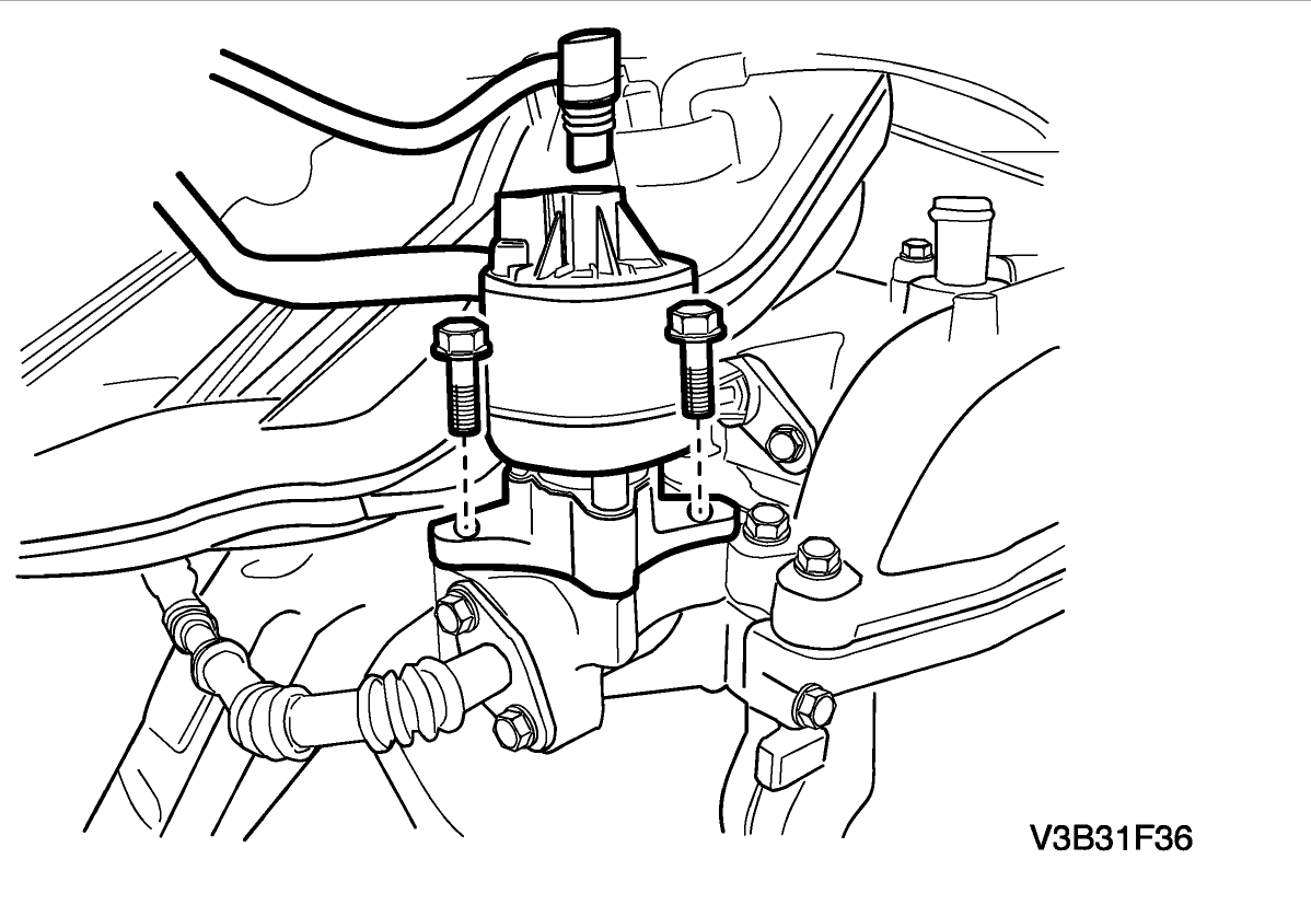

I would think that the open EGR will cause all of these problems. Here is a video and a diagram (below) to help you with the test:
https://youtu.be/DqUCbbKdWf4
They had problems with that style of valve.
Please let us know what happens so it will help others.
