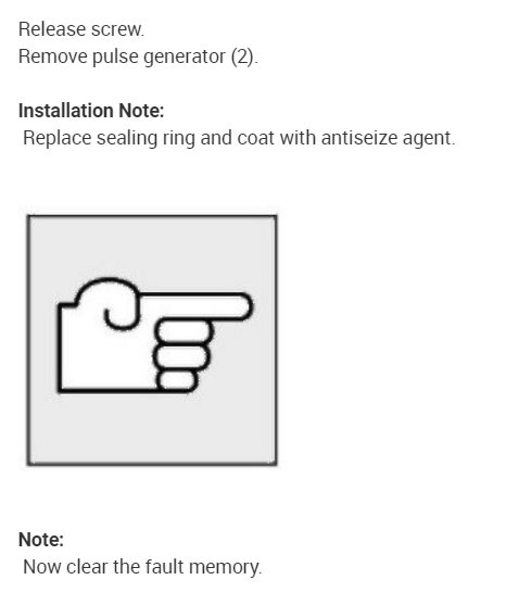

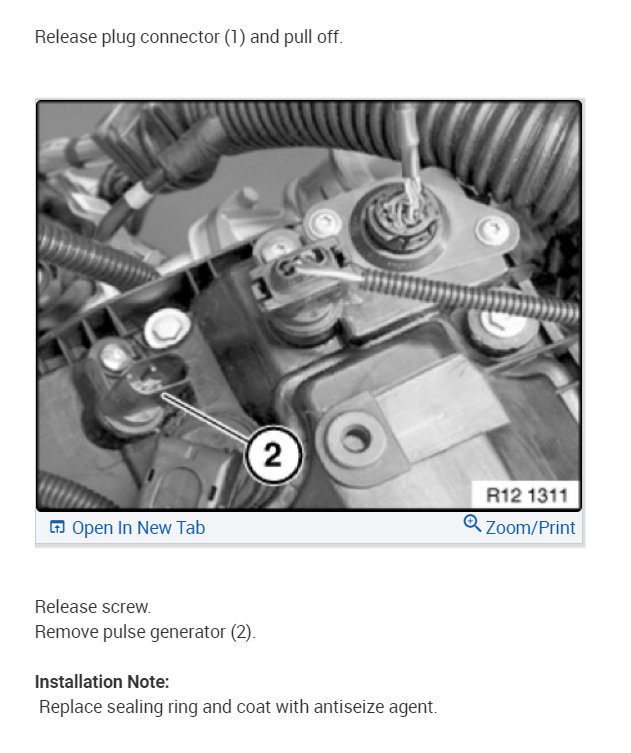

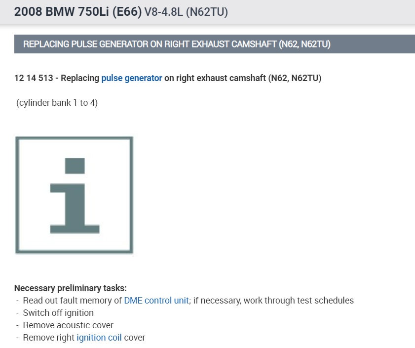

Yep, the trouble code P0393 means the PCM has detected a high voltage reading from the camshaft position sensor for camshaft sensor B in engine bank 2. Here is how you can change out the sensor with instructions and location in the diagrams below. After you change the sensor out clear the codes and drive it to confirm the sensor was the problem.

Thanks Ken. Can you tell me, facing the engine, which side this one is on and if it's the one on top and closer to the front or the one further back and lower?
Thanks,
Sam
May 3, 2022 at 8:58 AM
  • 55,433 POSTS
Sure, facing the engine it will be on the left side.
May 3, 2022 at 9:18 AM
SAM CRENSHAW
  • 52 POSTS
Top or bottom one?
May 3, 2022 at 9:28 AM
  • 55,433 POSTS
Where it says #2.
May 3, 2022 at 11:45 AM

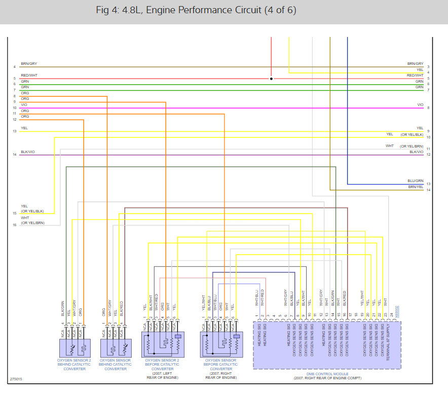

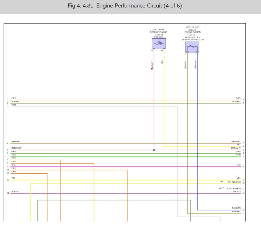

  • 55,433 POSTS

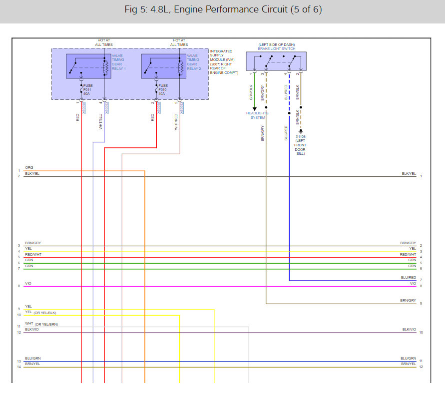

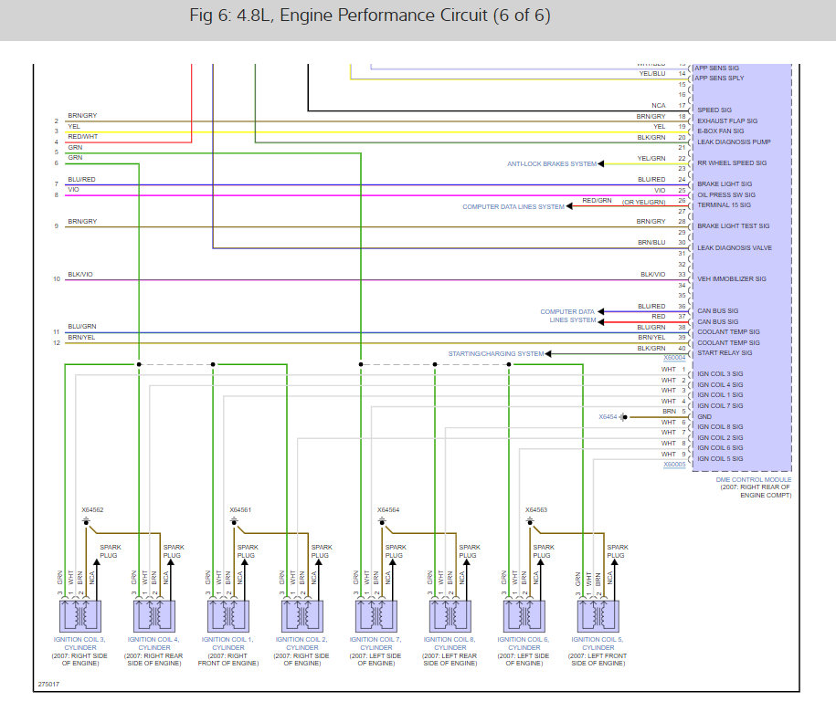

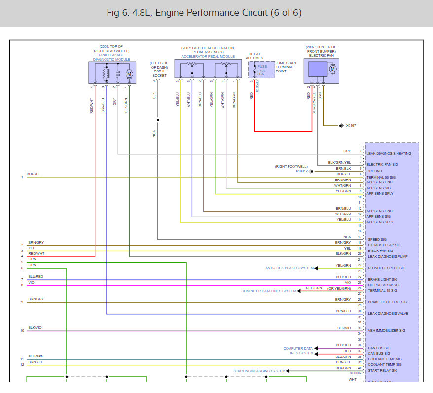

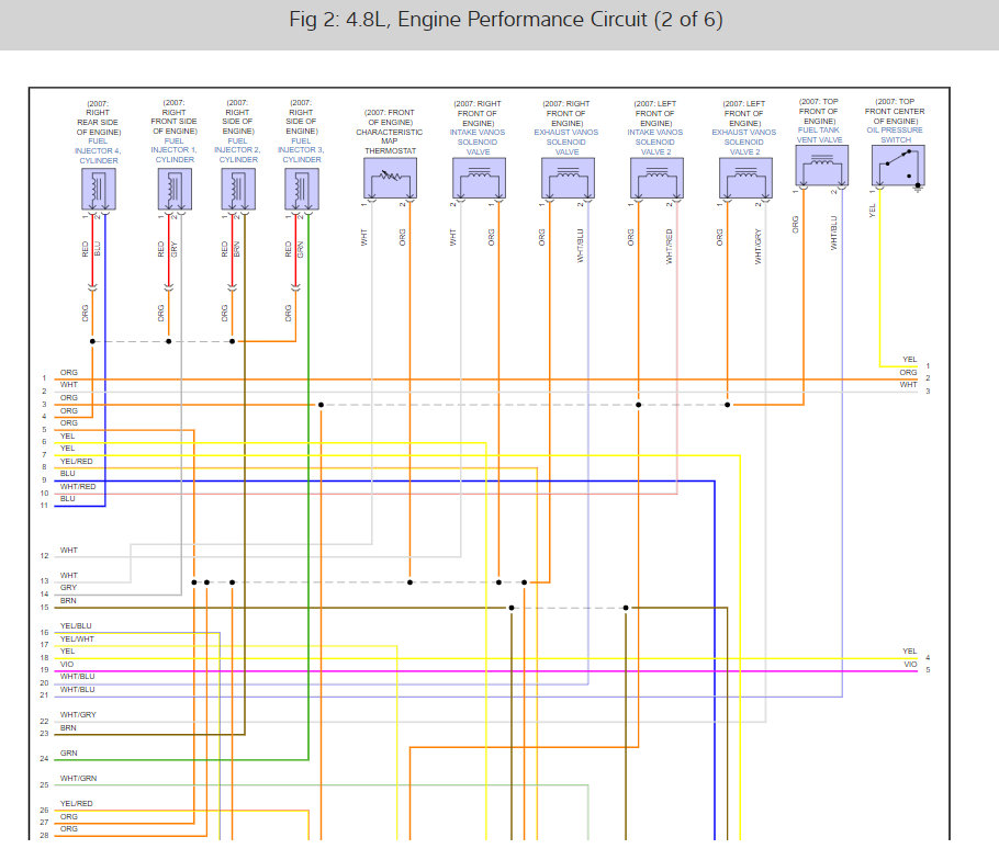

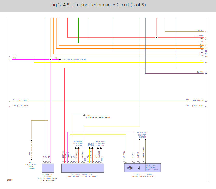

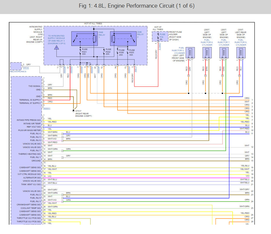

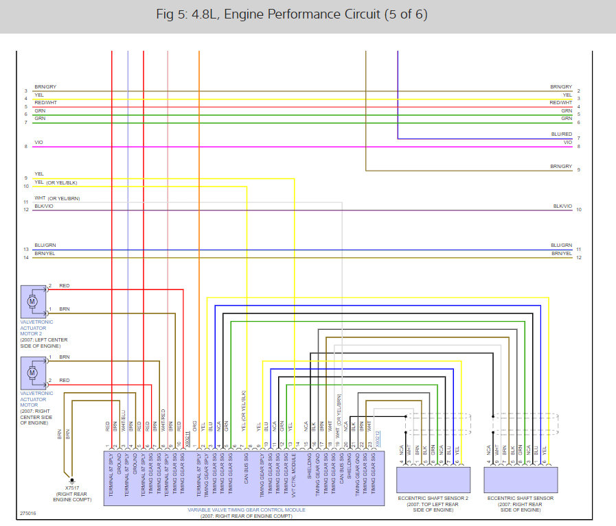

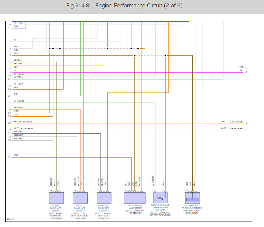

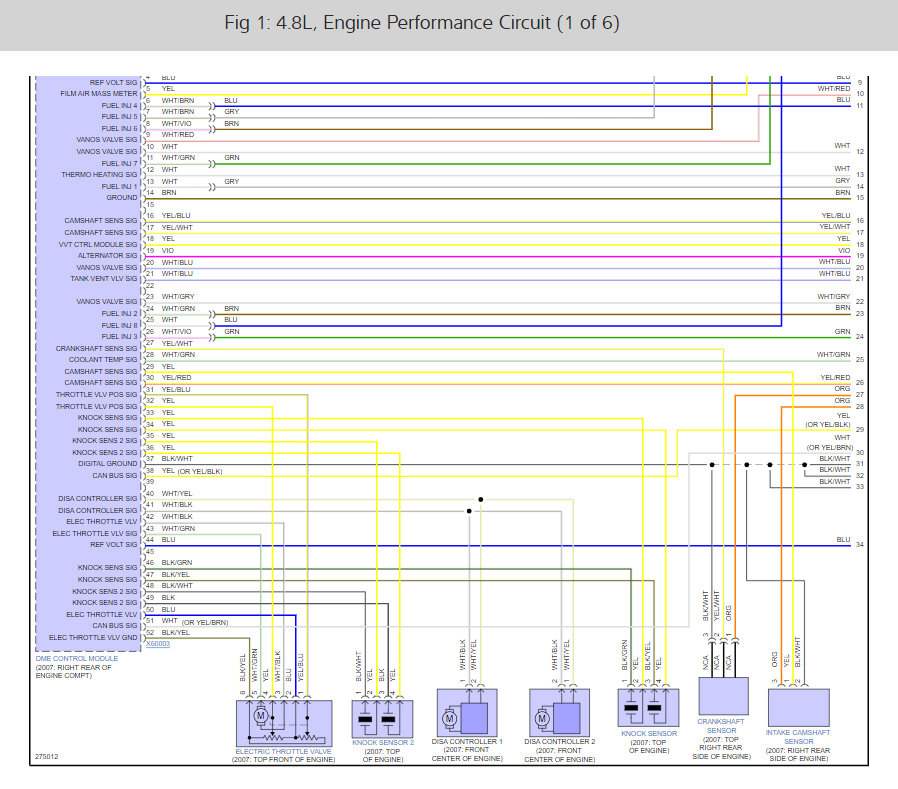

The code is for a circuit issue, we will need to check the wiring from the sensor to the ECU. This guide will show you how and I have the engine wiring harness diagrams to help you see which wires to test. How is the condition of the sensor connector?
May 16, 2022 at 6:21 AM

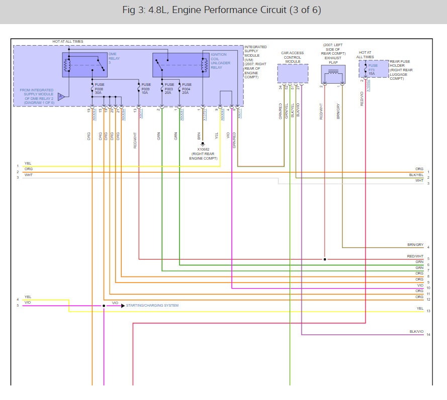

Good find, check the fuses in the front # f008, f009, f003 and f004 and rear fuse panel f001, f002, f006 and f005. Here is a guide to help you:

After this I tried a tester light on the plugs, and both showed connection in one of the three prong holes. I retried my multimeter and got nothing which may mean that the cheap meter I have just is messed up.
Where should we go from here?
I looked at the schematics you sent me and couldn't decipher where the wiring goes back to from the sensor, but if I'm getting power through the plugs to the sensor as indicated by the test light, which would indicate that it's not a wiring issue, right? Or could it be an improper ground where the two ground wires come back together?
As I'm sure you can tell, I'm a real babe in the woods on all this, and I'm sorry if I'm asking simple questions. I am trying to learn and am willing to do whatever work is necessary if I know what it is.

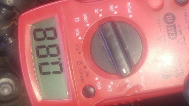

Okay, I'm getting between 20.4 - 21.6 on both sides.

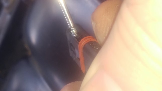

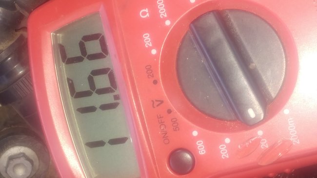

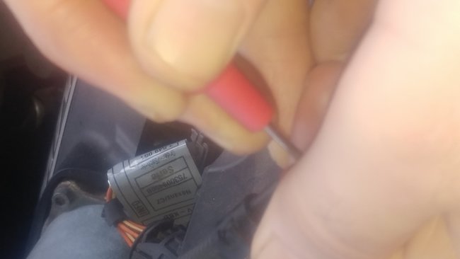

SAM CRENSHAW
  • 52 POSTS
It's the plugs that connect into the camshaft position sensors.
May 26, 2022 at 12:01 AM
  • 110,244 POSTS
Sam, that is either the problem or the reading was incorrect. The sensor is called a hall effect sensor. A signal voltage is provided by the PCM which is usually around 5v. The sensor (via a magnet) produces a signal when it turns. The signal can't produce that much. Actually, nothing on the vehicle should be doing that.
When the alternator is charging, I've seen output slightly over 14v. If it goes over 15.2, then suspect there is an issue with the regulator. With that in mind, I want you to confirm the alternator isn't overcharging. Something isn't adding up.
Here is a link that explains how to test the alternator. You will need the new test you got:
May 26, 2022 at 11:13 AM

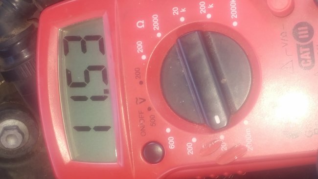

SAM CRENSHAW
  • 52 POSTS
Hi Joe,

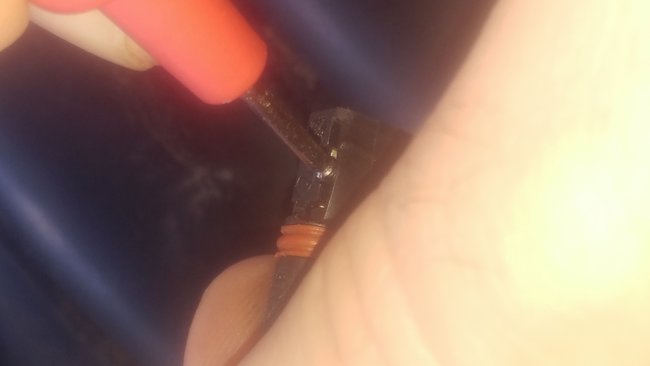

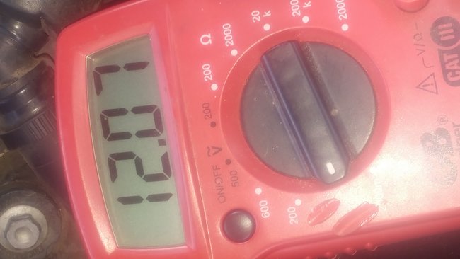

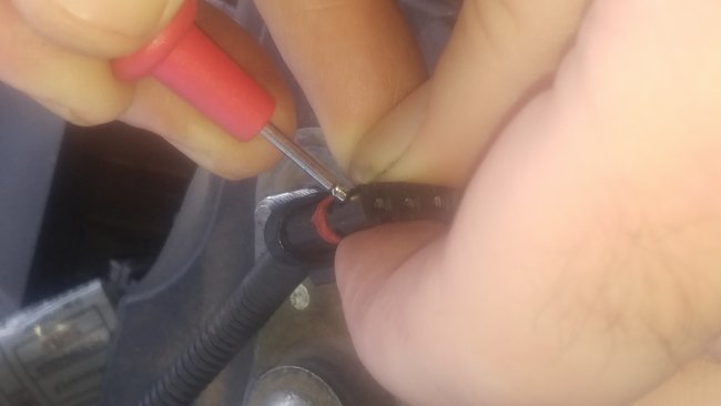

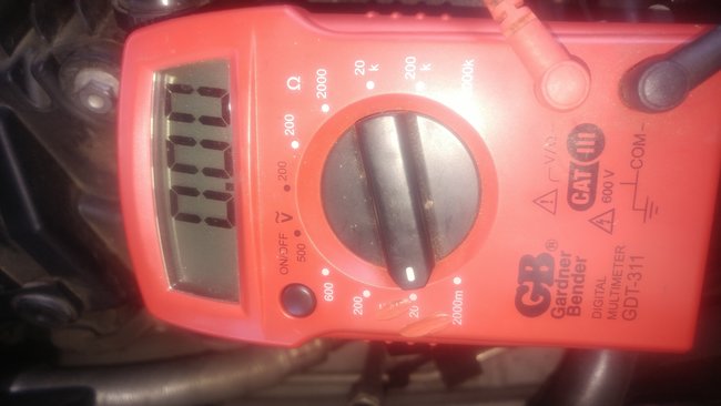

I'm attaching some photos. Please bear with me, electrical work isn't something I've ever really done although I'm trying to learn and I am absolutely willing to do whatever is required to do that.
I made these measurements with the ignition turned on, but the car was not running.
I thought perhaps I had the multimeter on the wrong setting, so I changed it (see picture).
I probed the positive into alternate sides of the plugs as shown and got the corresponding readings as shown.
Please, if you would, let me know if I'm doing anything wrong. One of the four readings, as you can see, was noticeably lower than the other three. I double checked to make sure.
Thank you so much for your patience.
Sam
May 31, 2022 at 3:31 AM
  • 55,433 POSTS
Those readings look correct, you may have a PCM that is going out. To confirm, let's do a CAN scan to see what it brings up. here is a guide and video that will help us see what's going on:

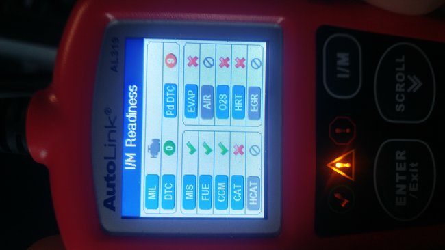

I'm attaching a screenshot.
The current codes are as follows:
P0458
P2092
P2094
P0365
P0348
P0393
P0300
P0301
P0305
Please let me know if this is what we need.
Thanks,
Sam
Jun 6, 2022 at 10:19 AM
  • 55,433 POSTS

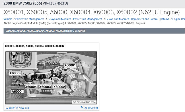

Yes, this is pointing to the DME module being bad, here are instructions on how to replace the unit. Check out the diagrams (below). Please let us know what happens.
Jun 7, 2022 at 2:59 AM
SAM CRENSHAW
  • 52 POSTS
Hey Ken,
In looking at your reply and the attached images, I'm not seeing any instructions for replacing the module.
Am I just missing it?
Thanks,
Sam
Jun 7, 2022 at 3:24 AM
  • 55,433 POSTS
This is all they offer as far as instructions go, did it fix the problem?
Jun 8, 2022 at 5:12 AM
SAM CRENSHAW
  • 52 POSTS
The part is being shipped out to me today. Luckily, I found a great deal on a used one. I'll let you know.

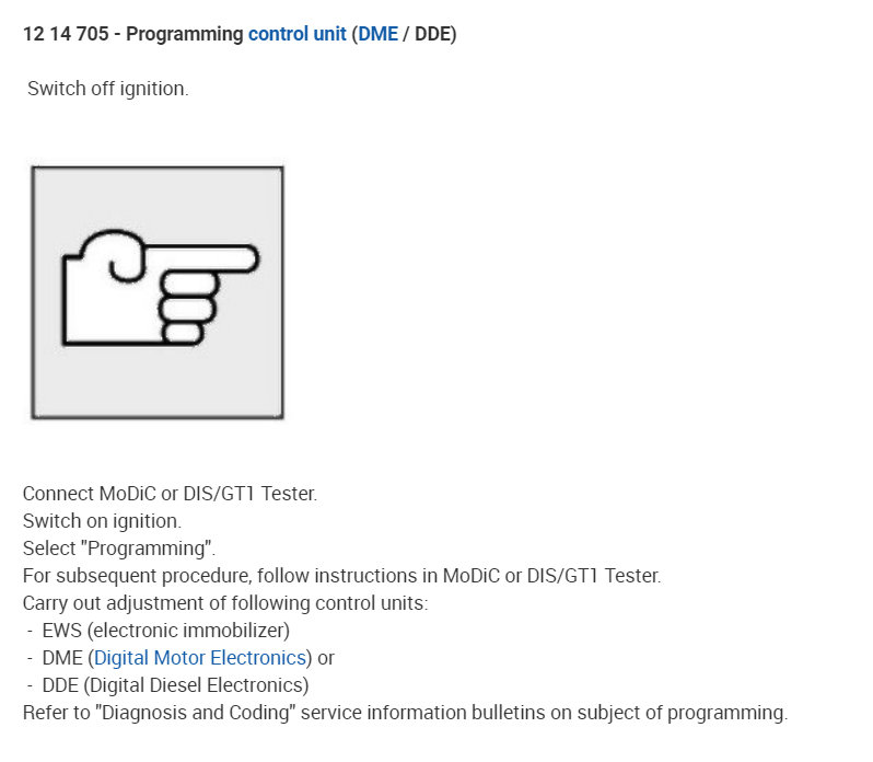

Ken, these DMEs have to be programmed to the car, no? Isn't that why it wouldn't start?
Jun 14, 2022 at 4:50 AM
  • 55,433 POSTS
Yes, they need to be programmed to the car, many online services can do this for you.
