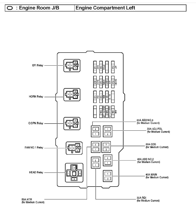

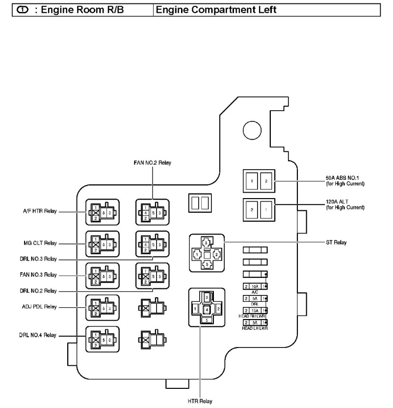

I wondering if all of these are possibly on one fuse or relay that I can try replacing or what to do next. I'm not very good at reading wiring schematics or determining what fuses or relays to check or if there's a fusible link somewhere.

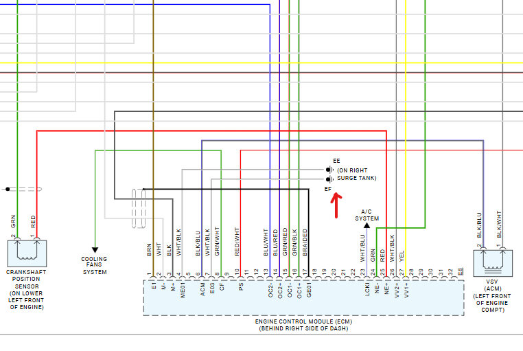

I would check to make sure the engine wiring harness ground is secure, next let's check the fuses because anytime there is a spark a fuse can be blown. Here is a guide to help and the fuse locations as well, please test the fuses with the key on.
If you find a blown fuse, replacing it can clear the codes. Check out the images (below). Let us know what you find.

Can you tell where the engine wiring harness ground is?
Nov 7, 2024 at 11:33 PM
  • 55,721 POSTS
They don't show the locations exactly, did you have this problem before the repairs? If not, I would look around the area where you were working. It says the ground is on the right side of the surge tank. Check out the images (below). Please let us know what happens.
