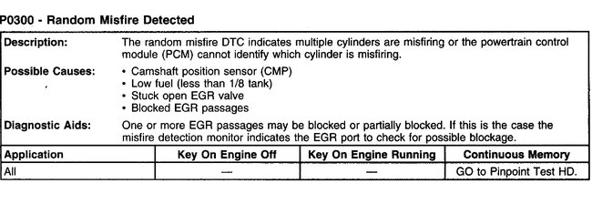

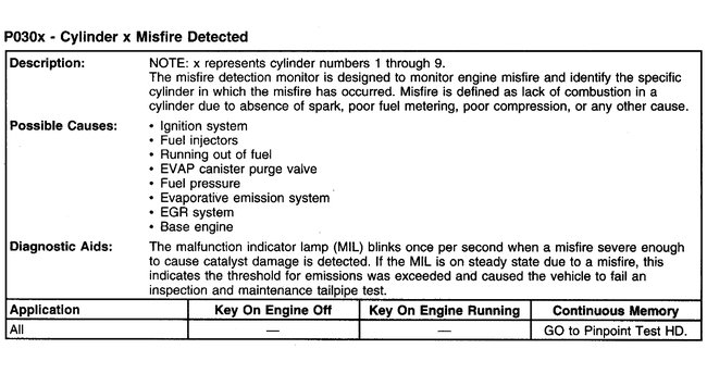

Those random misfire codes can be caused by a number of components/reasons.

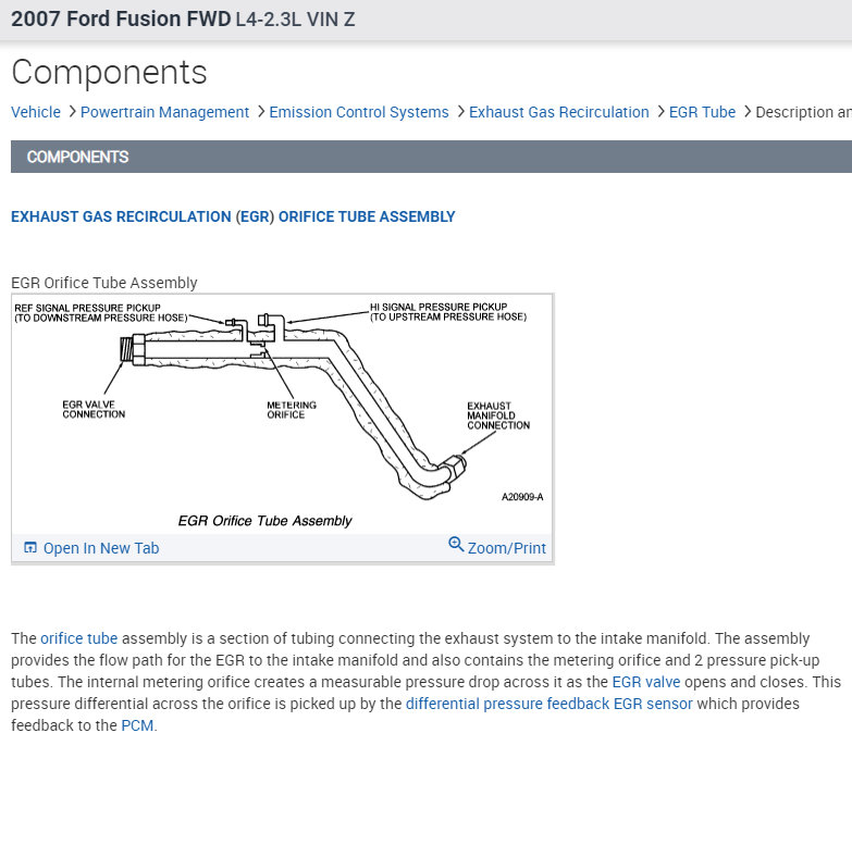

It could be due to faulty fuel injectors, blockage in the EGR system, bad EVPA purge valve, improper fuel pressure, it can also happen due to having low fuel and of course due to spark plugs or coils.

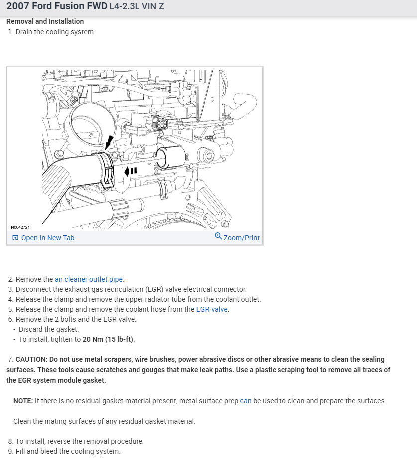

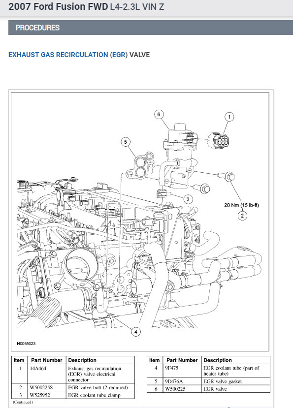

As you have already done the injectors and plugs, checking and cleaning the EGR system would be a good next step.
