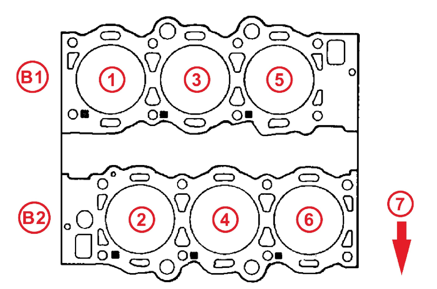

From the data i have cylinders 2,4 and 6 are the front 3 cylinders, bank 2.
You have codes for -
Random misfire and misfires on all of bank 2 (P0300,P0302,P0304,P0306)

With the misfire issue being on bank 2 only and also not having an issue during the closed loop phase warm up chase you need to look into the oxygen sensor fault and the camshaft sensor sensor fault.
I would advise you will need access to a scanner with live data to monitor signals received by the ECM.
A compression test or a relative compression test would be useful to see if you have any variation between cylinders and between banks. This would point potentially to a timing issue.
A check for vacuum leaks, to make sure you don't have an intake leak on bank 2.

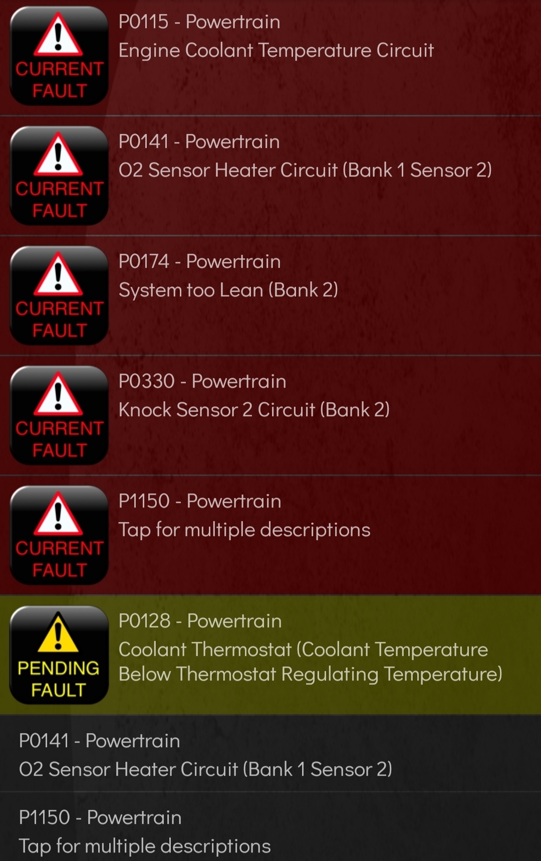

The misfire, lean and rich codes started it all. The car was stalling and had very poor gas mileage.
That was when the mechanic started trying to investigate the cause by changing the fuel pump, the spark plugs and the MAF sensor. There was no success. Then they attempted the timing belt fix and it still didn't solve the problem.
The initial codes are in the image attached.
