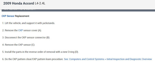

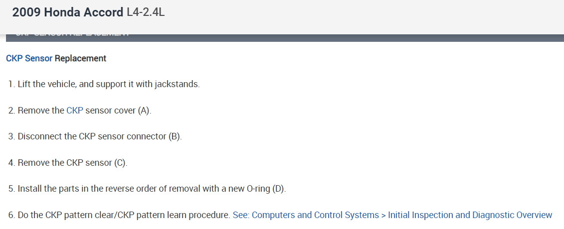

Can you upload a short video of the engine cranking and running? In the meantime, let's do a compression test to make sure the engine is in good shape; this guide can help:

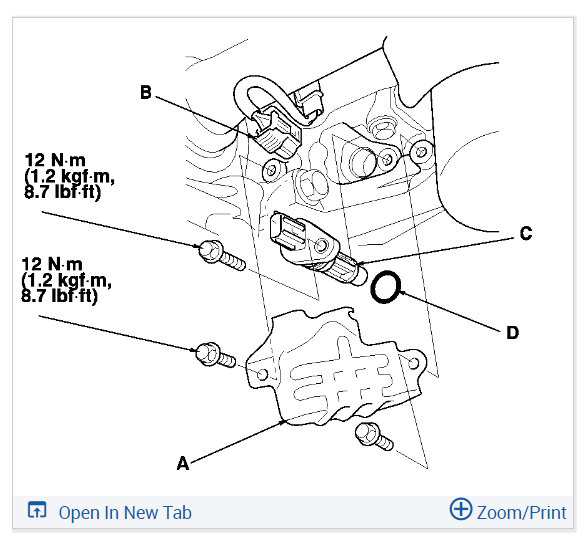

Also, let's swap out the crankshaft sensor and inspect the wiring at the connector. While the spark plugs are out, please check the condition. Check out the images (below). Let us know how it goes.

Thanks for your comment. I have replaced the coolant sensor, crankshaft sensor and all spark plugs. Once the engine started and the error codes were all gone. Then, I ran drive cycles, and activated 7 functions accept one function. But car runs roughly compared to before. At first could not erase codes, before replacement parts. How can I do programs relearning without high grade code reader if possible. Thanks for your comment and helps!

Engine is running smoothly, no mor rough, acceleration was also recovered. No more code. After replacement of parts, and run twice Drive cycle completely reset to original states. Main issues were resolved now! No more compression test is necessary, there was no any compression related codes found so far.
