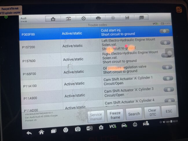

BHAMDOC1973
  • 2,007 POSTS

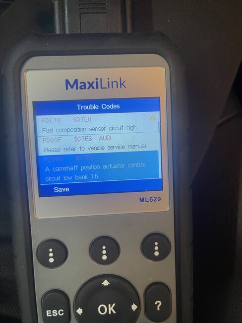

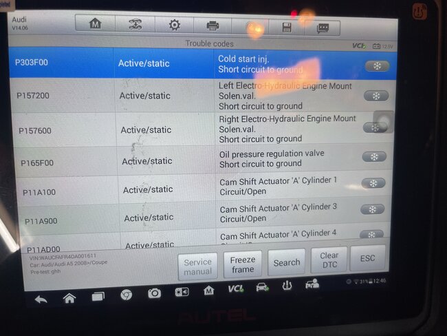

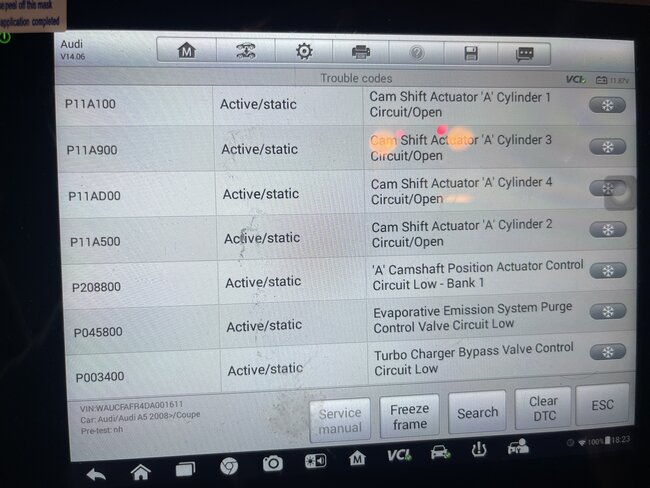

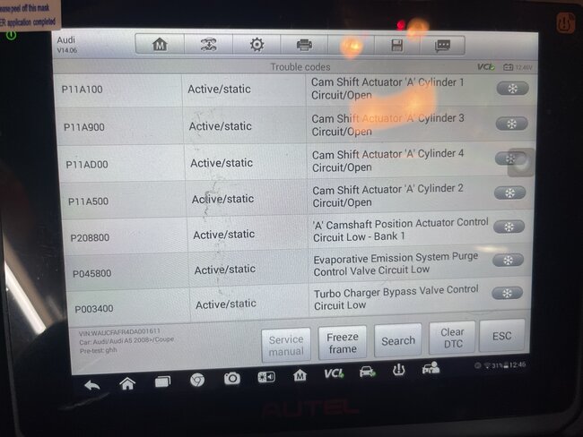

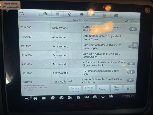

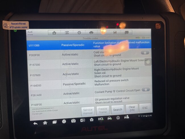

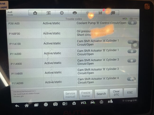

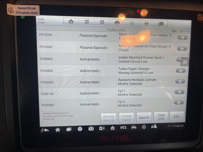

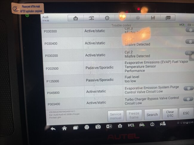

Idles rough, starts right away, several codes which am always positive most of them are connected, misfire as check engine flashes. If i remove the MAF sensor it gets better, and no flashing check engine. These are the codes from before I deleted them to see what stays.

These are after i deleted them.

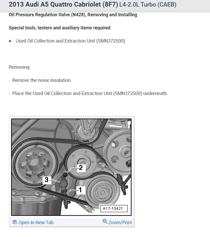

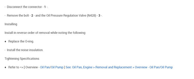

  • 55,740 POSTS

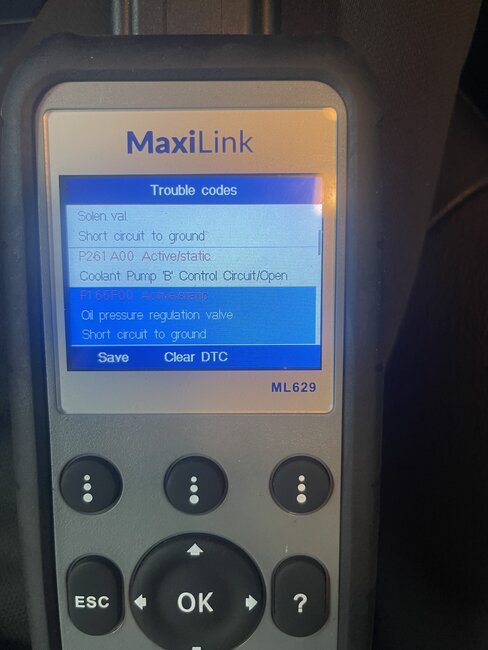

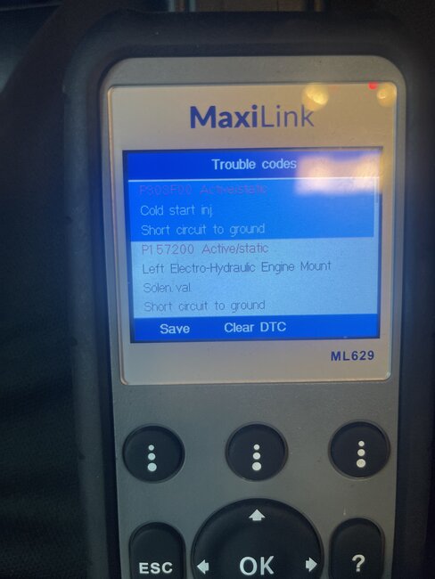

Two of the codes are for the engine mounts which are common when they need to be replaced, the other codes could be caused by the P165F code which is due to the oil pressure control valve being clogged or not working. can you see inside the valve cover to tell if the oil has been changed, is there a lot of sludge inside the engine? Here is the location of the valve so you can check it out. Please let me know what you find and upload images.
Feb 19, 2023 at 1:50 AM

I checked the fuses under hood and switched relay j271 to see if it makes difference, deleted all codes but these codes here stay in place and do not clear without starting the motor, so something is doing all of that throwing all these codes without the car being started.

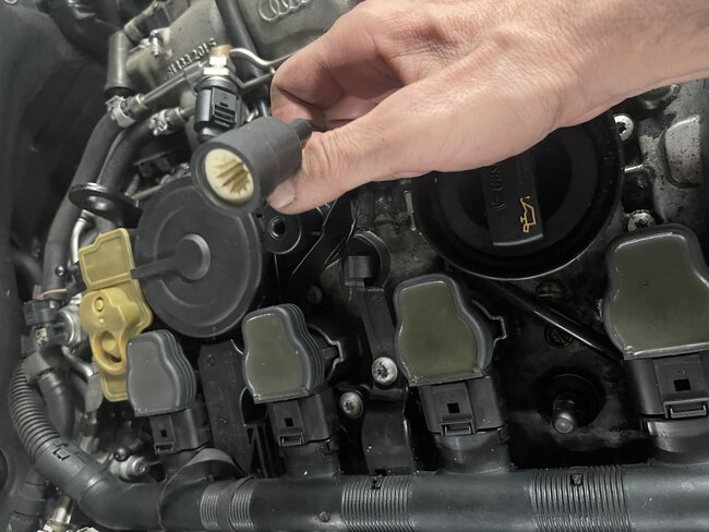

BHAMDOC1973
  • 2,007 POSTS
Found this loose do you know what it is?
Feb 25, 2023 at 11:27 AM

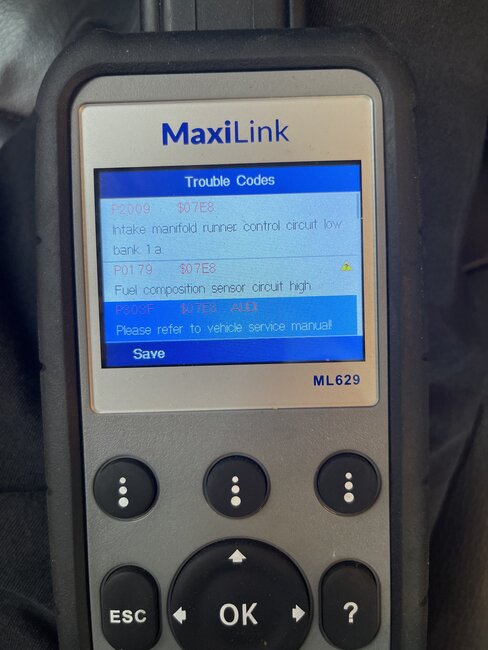

BHAMDOC1973
  • 2,007 POSTS

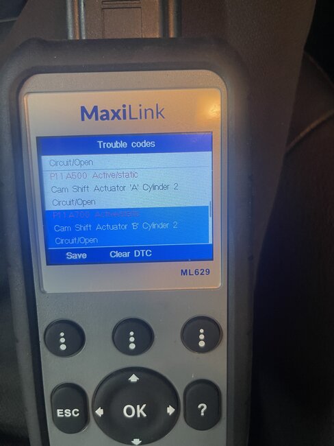

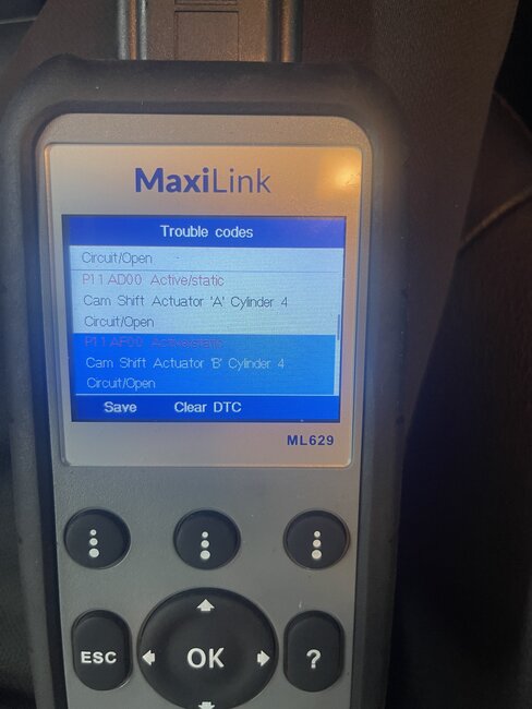

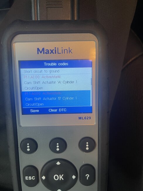

These won't delete with engine off.
Feb 25, 2023 at 11:33 AM
BHAMDOC1973
  • 2,007 POSTS
I checked the oil valve sensor but there is only a harness to it, i don't see a way to remove it, like it's part of the block.
Feb 26, 2023 at 10:41 PM

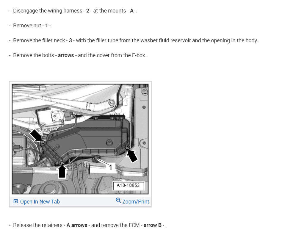

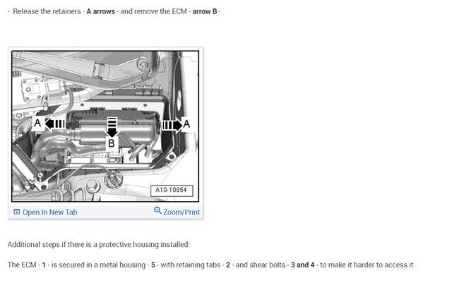

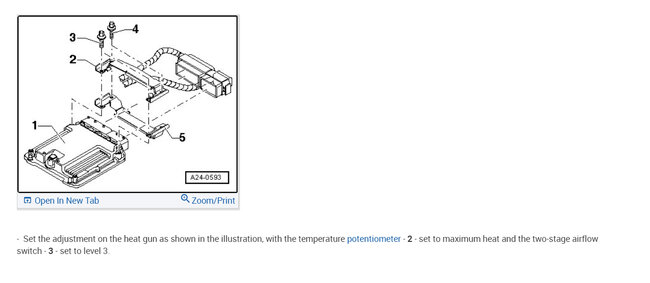

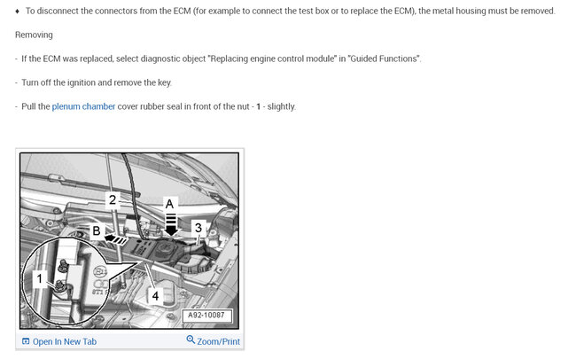

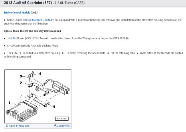

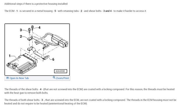

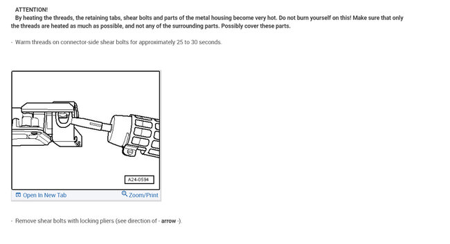

  • 55,740 POSTS

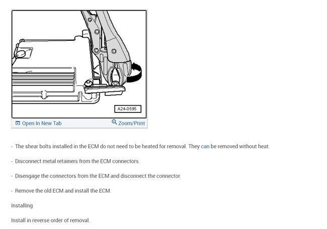

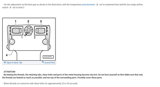

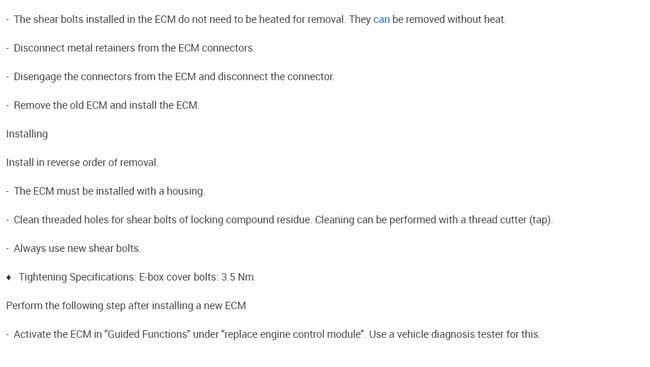

It looks like the PCM is bad or you have a bad PCM ground, if the grounds are okay here is how to replace it in the images below. You can get a preprogrammed unit by searching Google or Ebay. Check out the images (below). Please let us know what happens.
Feb 27, 2023 at 1:07 AM

By PCM ground you mean internal to the PCM? PCM is out already.

I checked the mounts, they are ancient.

BHAMDOC1973
  • 2,007 POSTS

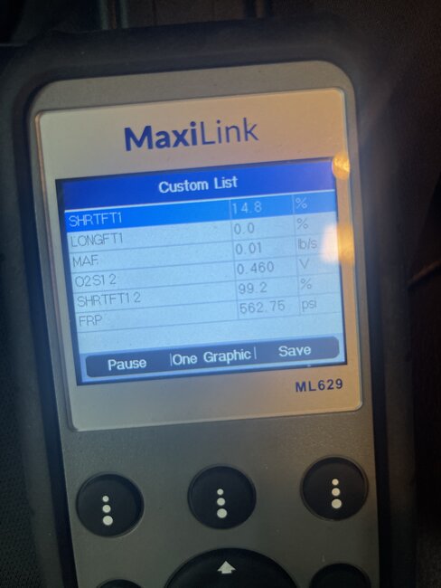

I changed the oil valve sensor, idle has gotten way better, but EPC light still on. Multiple hidden codes, but idle is very stable.
Mar 2, 2023 at 3:13 AM

BHAMDOC1973
  • 2,007 POSTS
The codes for camshaft actuator are on all cylinders, so is there kne that controls them all? Is that what you mean by that?
Mar 3, 2023 at 2:05 AM
BHAMDOC1973
  • 2,007 POSTS

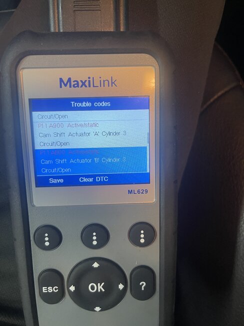

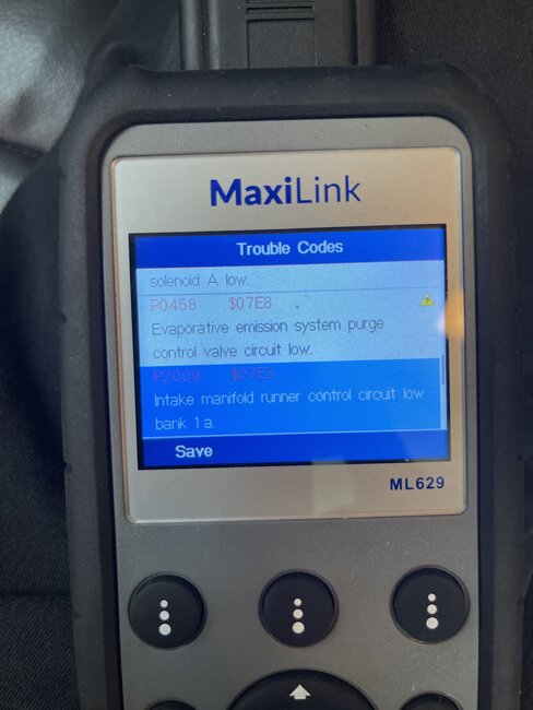

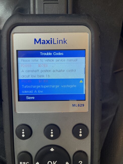

I removed the front camshaft actuator and i think the pin was stuck so I cleaned it and freed it, then cleaned out all the solenoids on each cylinder, which are below the coils on passenger side. No check engine light, EPC still on, drive it around the corner drives good no issues with idle. Turned it off turned it on and i have these here, i think many disappeared. Delete and turn car off and on and they immediately there.
