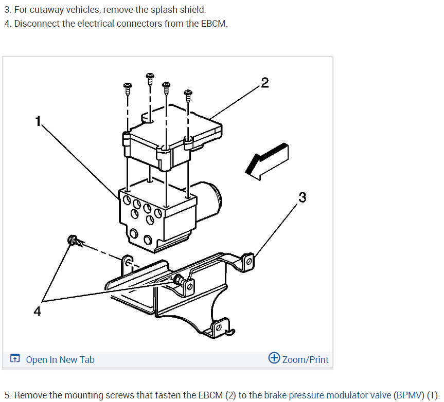

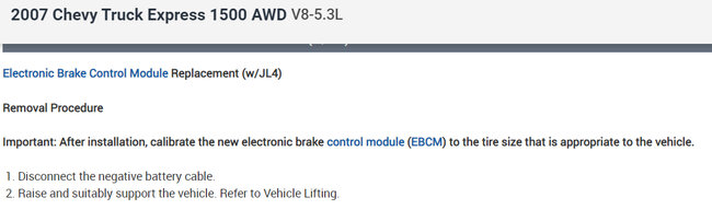

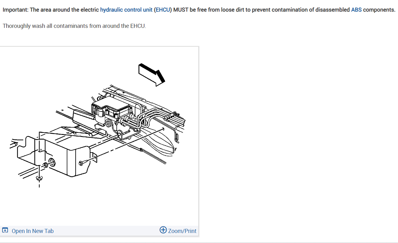

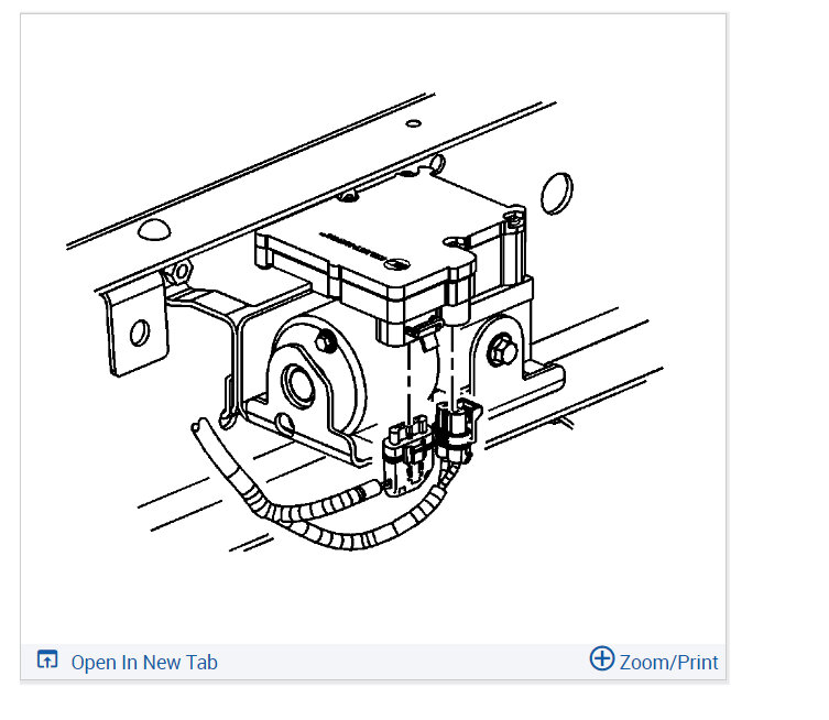

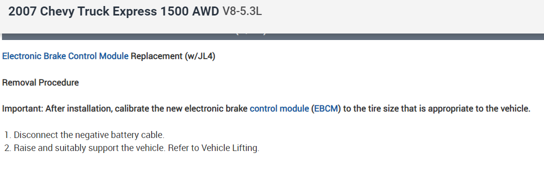

Here is how to change the ABS module out in the images below and I have included a video to show you how the job is done.
https://youtu.be/lUotkKXG9dY?si=19HPm1332WDS3Aht
The codes will clear on their own once the repair is made. Check out the images (below). Let us know if you need anything else.
