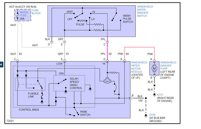

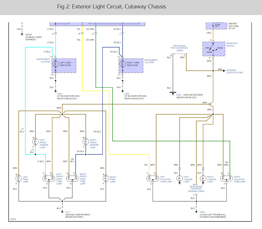

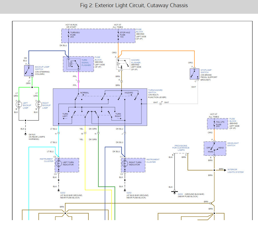

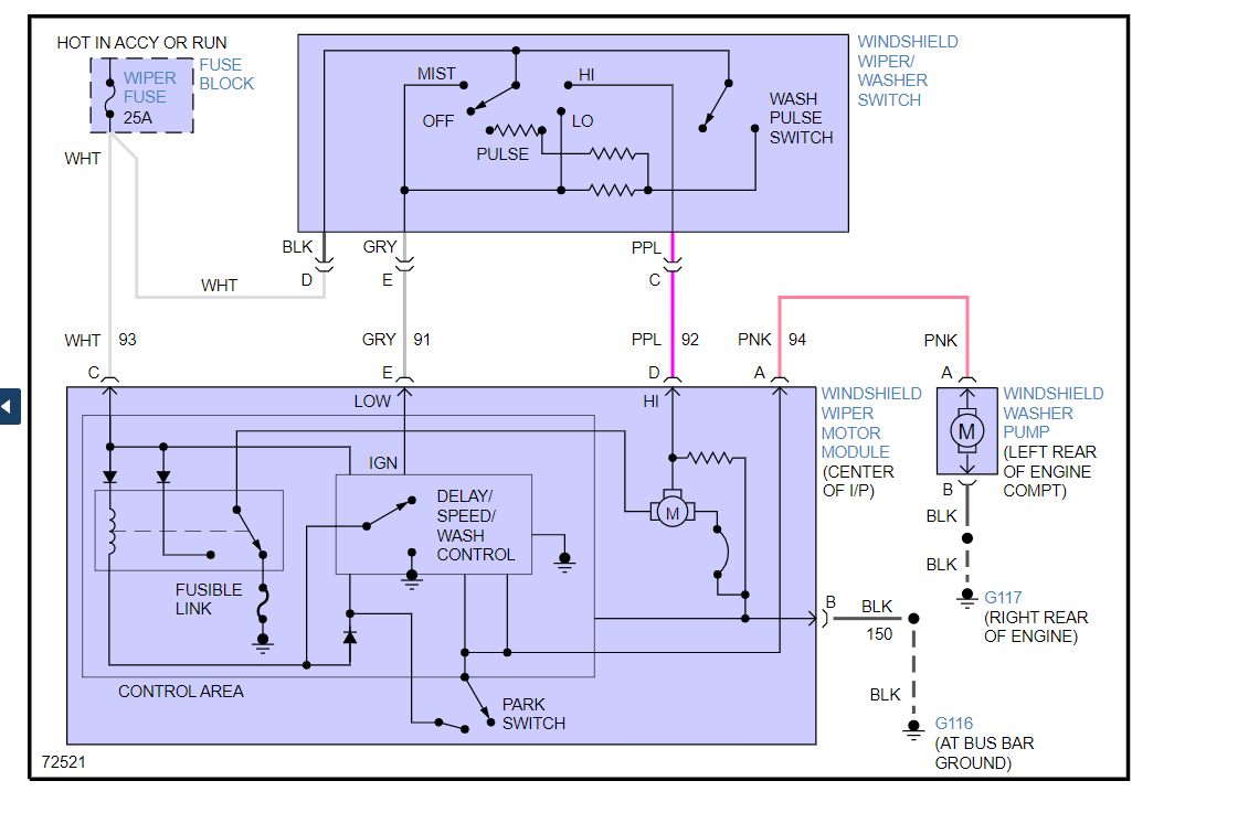

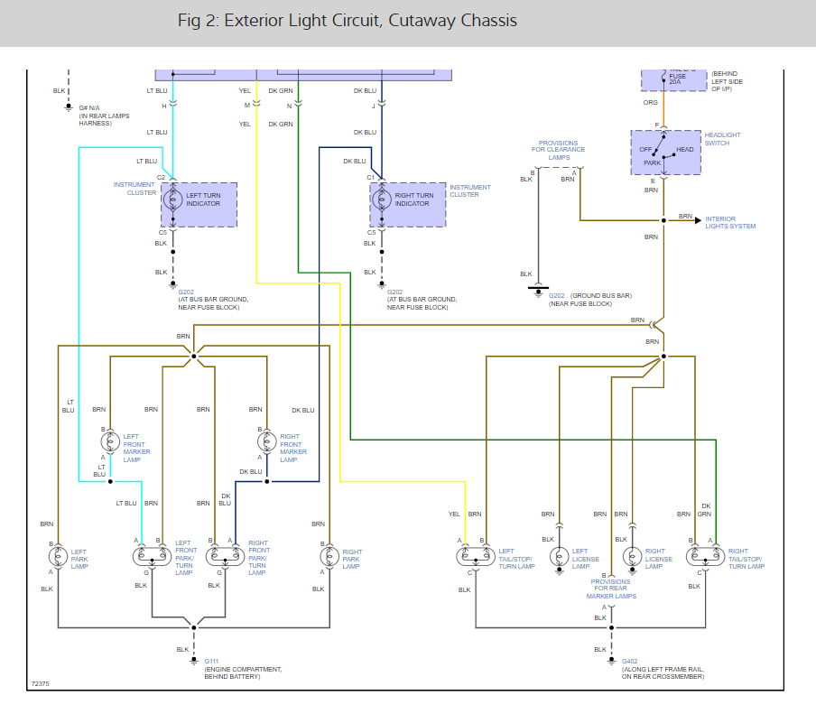

I need a pin out for the multifunction switch.
Oct 1, 2022 at 1:38 PM
Experienced Mechanic
55,688 POSTS
Yep, so they don't have one, I can get the wiring diagrams for the wipers and turn signals which I have provided. Check out the images (below). Please let us know if you need anything else to get the problem fixed.
