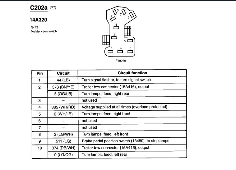

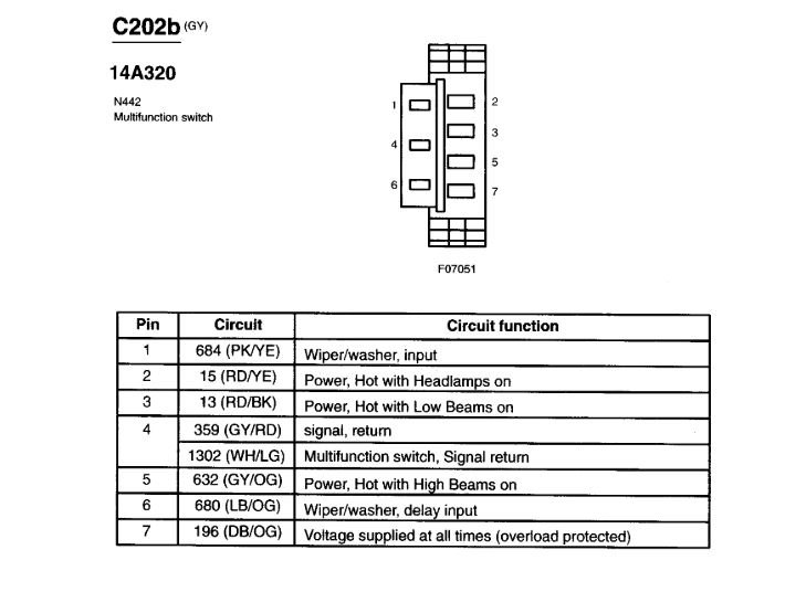

Wires loose from connector, need diagram.
Feb 10, 2020 at 4:01 AM
Good afternoon,
I attached the diagrams of both connectors below. Check out the diagrams (Below). Please let us know if you need anything else to get the problem fixed.
