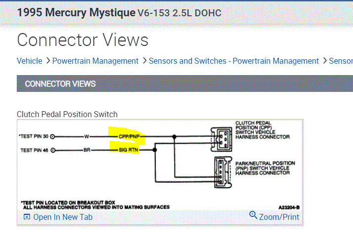

When looking at a wiring diagram and seeing a many-pin connector, are you looking at the front side or the wire side, male or female part? For instance, Alldatadiy schematics.
Jan 13, 2022 at 9:38 AM
  • 110,241 POSTS

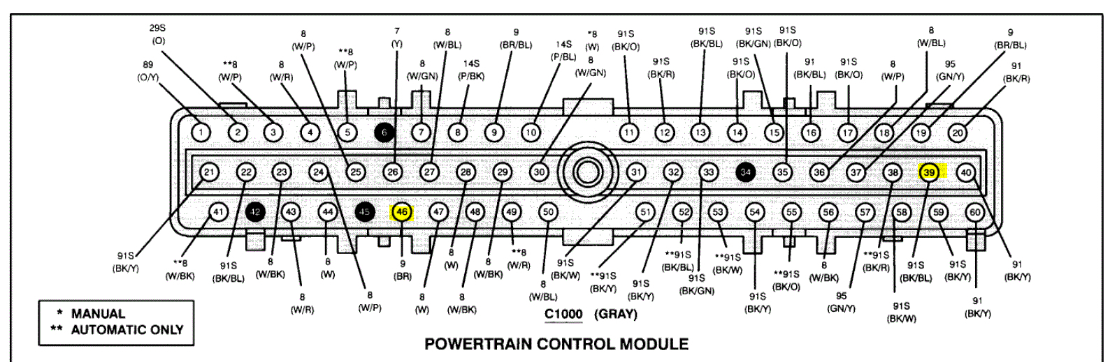

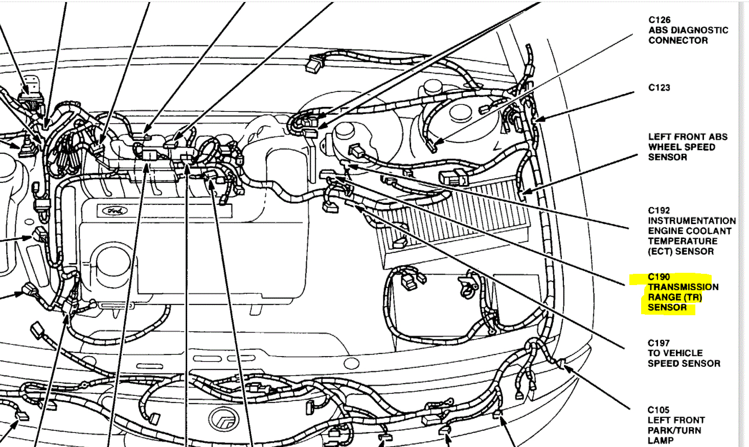

The connector pins are from the front, male or female connector. Is that what you mean?

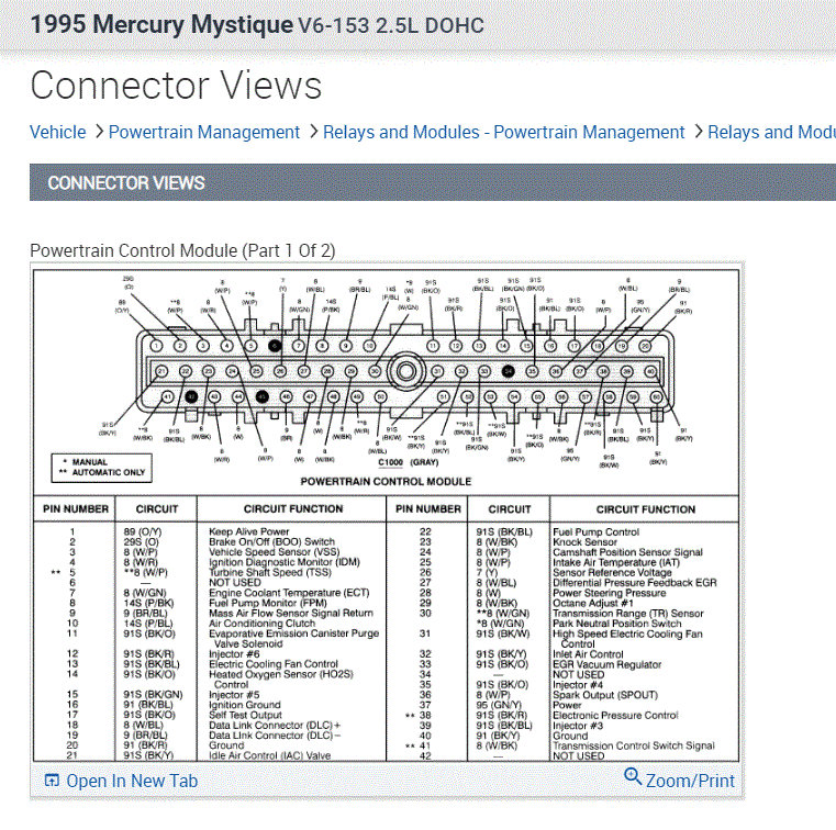

I attached a connector picture of the ECM for your vehicle below. That is with the connector disconnected and you are looking into the connector.
See pic below.
Jan 13, 2022 at 12:29 PM
QFONG
  • 92 POSTS
Am I looking into the ECM or the plug?
Jan 13, 2022 at 11:49 PM
  • 110,241 POSTS
That is the ECM. In most cases when it is a connector, wiring is shown at the connector. I don't want to say all the time, but most of the time. See pic 1 below.

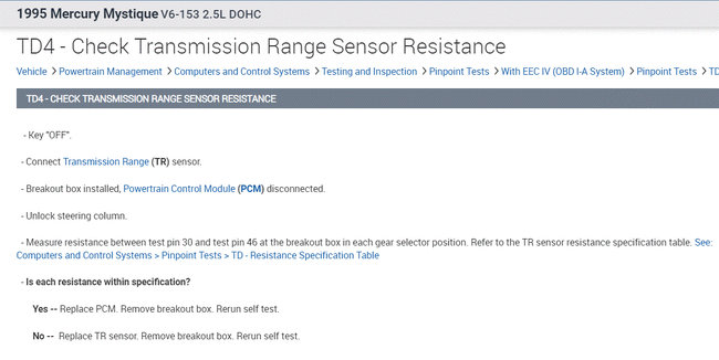

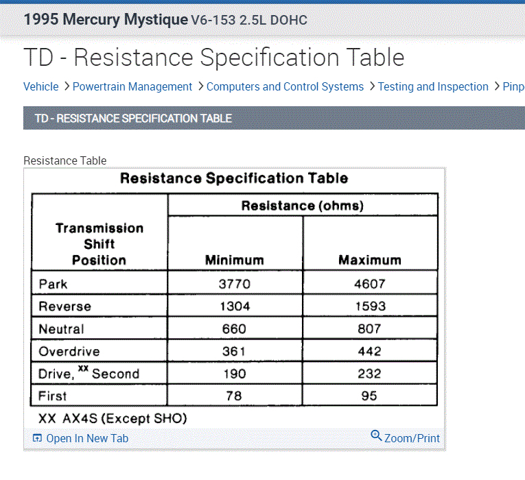

The transmission range sensor has six separate resistors in series. Each resistor has an output connection corresponding to a transmission position (P, R, N, D, 1, 2).
The PCM applies a 5.0-volt reference signal to the TR pin 30. The signal return circuit, pin 46, supplies a ground path to the sensor. As the transmission is shifted, the TR sensor output wiper arm moves to a corresponding resistor connection (based on gear selection). The six inline resistors provide a separate voltage drop for each transmission position. Based on the voltage signal, the PCM identifies the current transmission shift lever position.
So, I suspect that either the TR has failed, the linkage isn't fully placing the TR in the drive position, or there is an electrical issue. However, if there is an issue within the circuit, I wouldn't think it would be limited to just reverse.

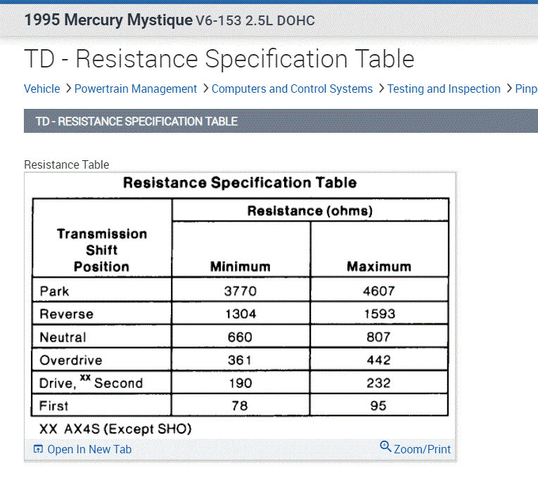

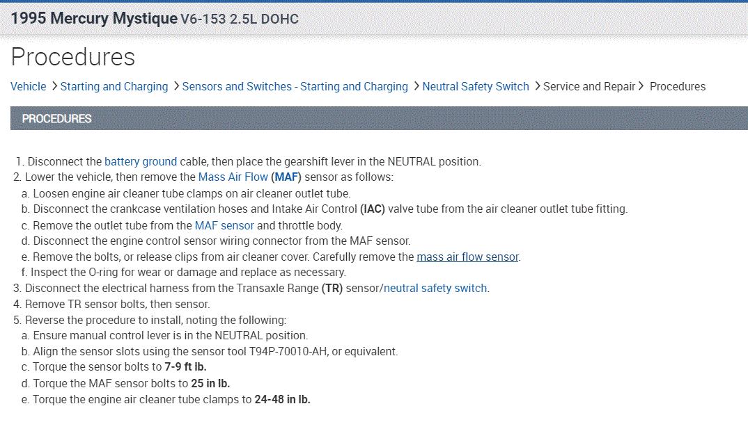

If you look below, I attached the diagnostics for testing. Pic 1 indicates the use of a breakout box, which most people don't own. Since that is the most likely case, you will need to check the return signal resistance at the PCM or the sensor itself.
Pic 2 shows the resistance based on gear selection. Pics 3 and 4 provide the location and directions for removal and replacement. Pic 5 is a pinout of the PCM. I highlighted the pins involved. Pin 30 provides the 5v reference and pin 46 is the signal return pin.
Since the vehicle sits a lot, you may want to confirm there isn't a corrosion issue on the connectors as well.
I hope this helps. Stay warm and let me know if you have other questions.

I checked the TR resistance and in each position the resistance was within the range. How would I check the ECM to see if it is functioning properly? I have the unit out and sitting on top of the engine. I can remove the 60-pin plug easily.

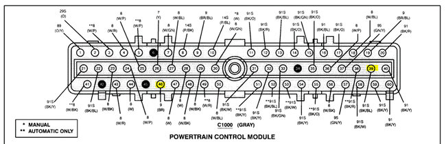

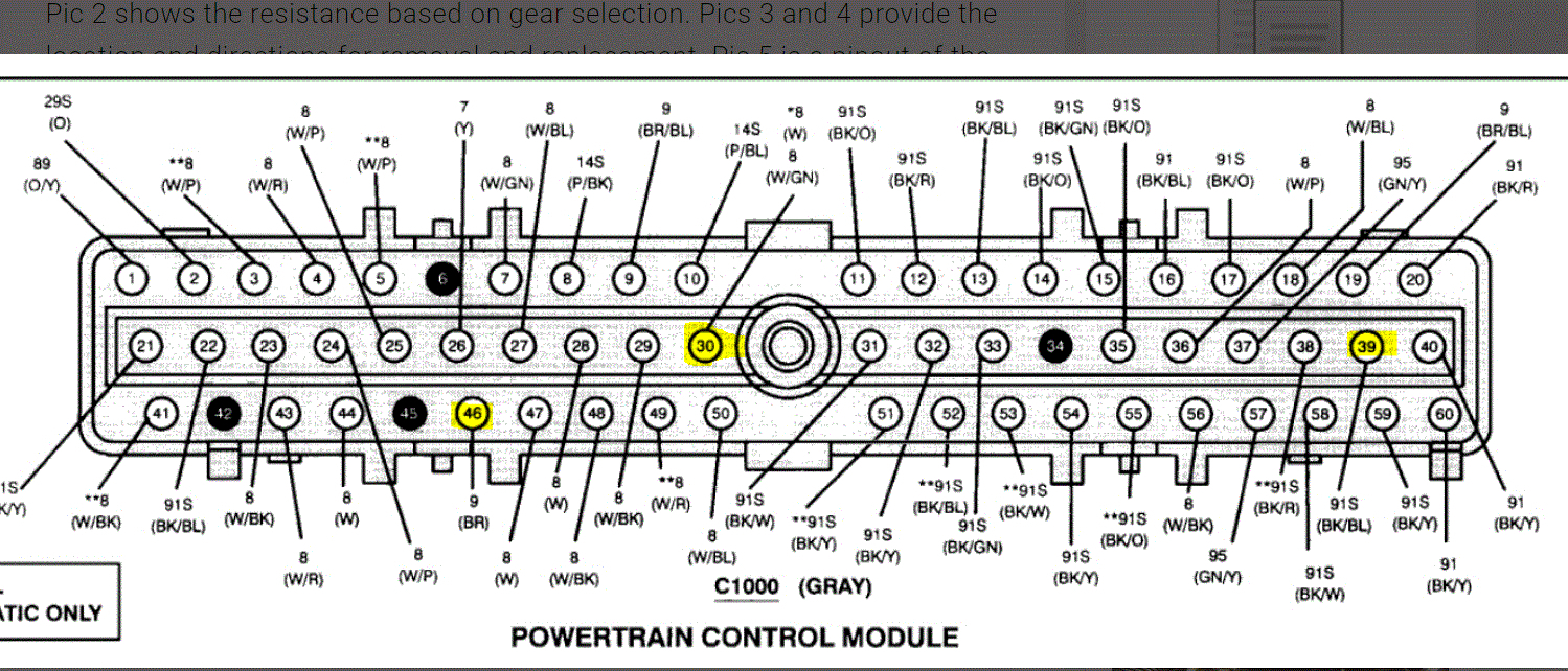

I need you to check pin 30 for a 5v reference from the ECM. Also, did you confirm a ground path via pin 46?
Note: I accidentally highlighted the wrong pin above. It should be pin 30 (not 39) that provides power. Also, if you haven't already, disconnect the connector at the ECM and inspect it for damage or corrosion.
As far as testing the ECM, see if there is power and ground for the circuit. If there is, it's good. If there isn't, check wiring between the sensor and ECM for continuity.

The voltage reading between pin 30 and pin 46 is 4.5v. I checked the resistance of the VSS- 7.8 ohms, TSS-.8 ohms. I'm stumped.

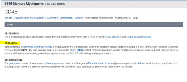

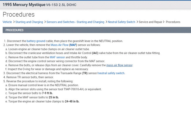

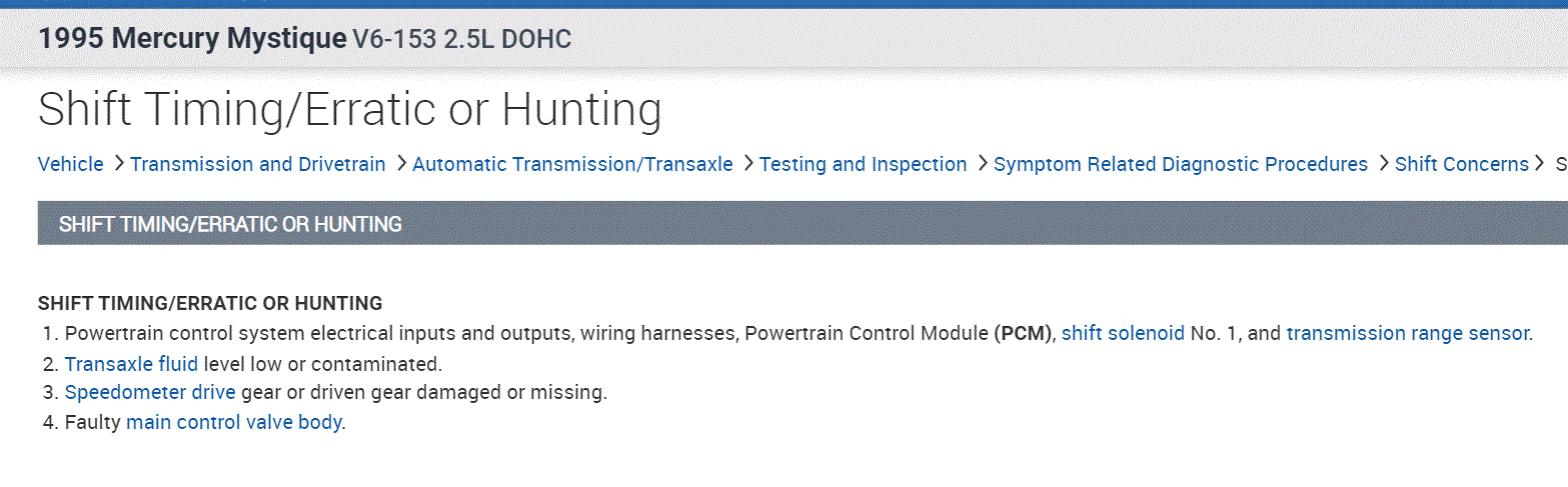

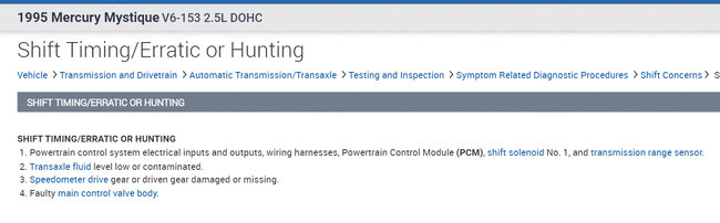

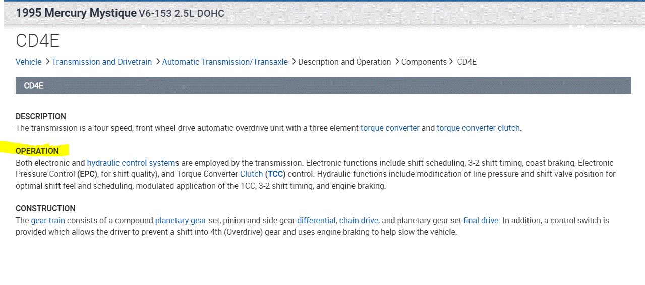

Shifting is controlled by the powertrain control module (PCM). The PCM uses information from the speed sensor, throttle position, engine load, speed, and so on.
If the vehicle is shifting erratically, it could be the speedo drive gear, a problem with the fluid itself, or within the valve body. See pic 1 below.
I can't remember, but was line pressure tested? Have you noticed anything related to the speedometer? I likely already know the answer to this, but is the fluid clean and full?
See pic 2 for a better description of how it works.

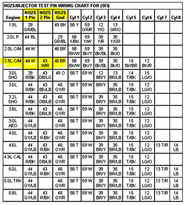

The spark plugs were black and sooty. I decided to check the O2 sensors and both sensor elements are open, so I guessed that I need new ones. The old one had only been in the car 2 years and hardly used.
Feb 3, 2022 at 5:59 AM
  • 110,241 POSTS
If the sensors are bad, that is the likely cause. Let me know if that takes care of the issue. Also, let me know if there is anything I can do to help.

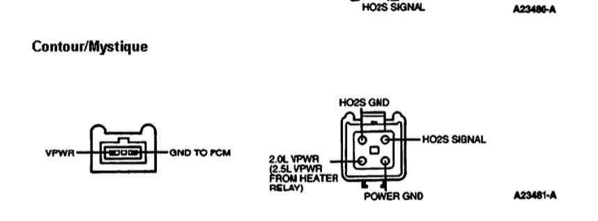

Hi Joe,
The new O2 sensors will have two white wires for the heater and a gray and a black wire. I'm confused as to which wire is the signal wire connecting to pin 43/44.
Feb 6, 2022 at 12:41 PM
  • 110,241 POSTS
Take a look at the two pics below and let me know if they help.

I installed the 2 O2 sensors and the car ran much better. No black soot coming out of the exhaust. I'll take it for a road test soon.

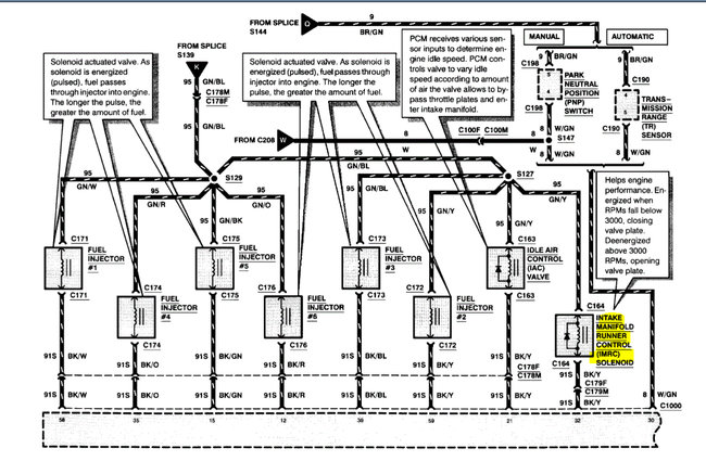

Hi Joe, the road test was so-so but first I'd like to know about the intake manifold runner control. The Alldata-diy shows two wires going to the valve. But the actual valve has 3 wires going to it. One wire comes from pin 32, the other comes from pin 57, the power. The third wire is a mystery. Also, I can't tell which wire goes where in the IMRC connector. Between the two outer wires the resistance is 60.2 ohms.
Putt
Feb 13, 2022 at 7:49 AM
  • 110,241 POSTS
I dug through the OEM schematics, and they show the same. I did notice there is a splice that the runner wiring is part of.
Take a look at the pic below. Let me know your thoughts.
See pic below.
Feb 13, 2022 at 10:36 AM
QFONG
  • 92 POSTS
That's the same as the ALLDATA-DIY picture I have. I'll follow the wire back toward its other end. This car is a headache.

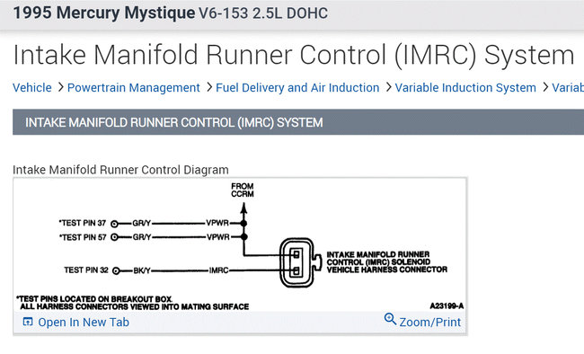

Yes, I was looking at the IMRC connector.
Putt
Feb 14, 2022 at 7:51 AM
  • 110,241 POSTS
I sure hope you're enjoying Florida. It's 8 degrees here tonight. LOL But, I would likely be doing the same thing as you.
I attached the connector below for the IMRC. Although there are two pins at the connector, there are three wires involved. One comes from pin 32 one from pin 57. There is a third that goes to pin 37. It is spliced 57.
Take a look and let me know if that helps.
See pic below.

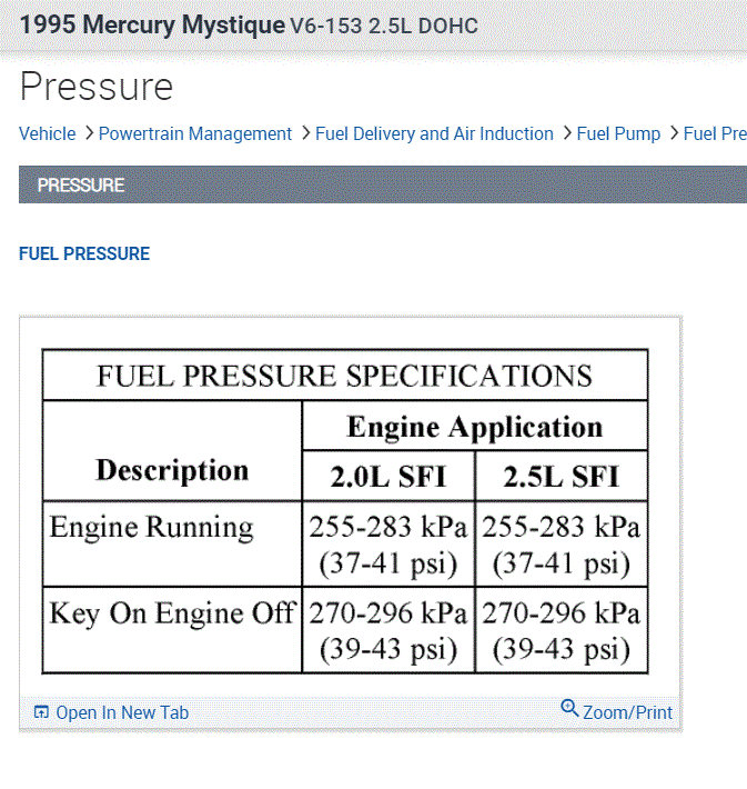

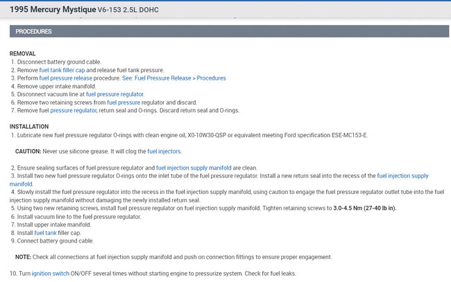

No luck with the IMRC, it seems to have 60 ohms resistance between the two outer wires and putting 12 V to it does nothing.
Meanwhile after the car runs for about 1/2 hour it starts blowing black smoke and will not idle. Fuel pressure regulator?
Feb 17, 2022 at 7:24 AM
  • 110,241 POSTS

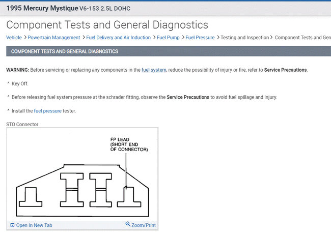

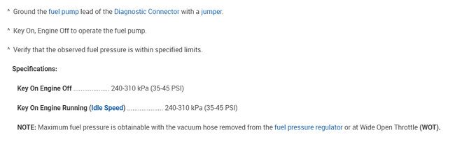

Black smoke indicates a rich fuel mixture. So, it is possible that the pressure regulator is bad.
I hope you are sitting down. I just ran through the procedure for replacing one (which is attached below), and the intake needs to be removed.
As a result, I would check fuel pressure first to confirm that it is the issue. Here is a link that explains in general how it's done:
Also, pic 2 shows the pressure specs, and pics 3 and 4 are the directions specific to this vehicle.
Let me know if this helps, and by no means am I tired of hearing from you. I'm a little jealous you are warm, but what can I say. lol 60 here today, rain, tonight, rain to sleet, then to snow. Temperature to drop to 20 degrees. Ugh!
