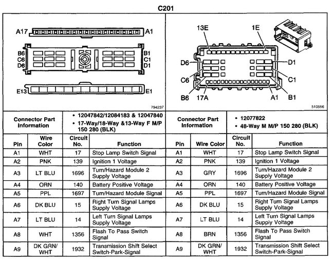

I recently changed my multi-function switch due to the cruise control going out. whenever I removed the old multiplexing switch the pins came out of the connector. I put all them back, in what I thought was the right position obviously I was wrong because now my brake lights stay on and whenever I press the brake pedal, even with the ignition off and key out, the radio comes on and the headlights come on. If you could please supply me with a pin out for the plugins on the multifunction switch itself I would greatly appreciate it..
Feb 3, 2021 at 8:57 PM
STEVE W.
  • 15,349 POSTS

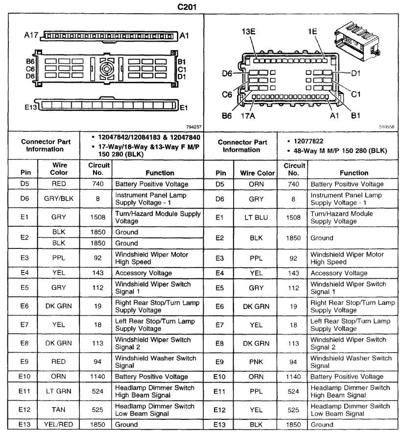

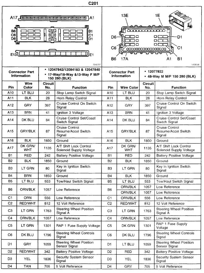

Okay, that should be connector 201. There are two versions of that part but the pin diagram covers both, one in each column. Determine which switch you have and you should be able to repin it using the information below.
