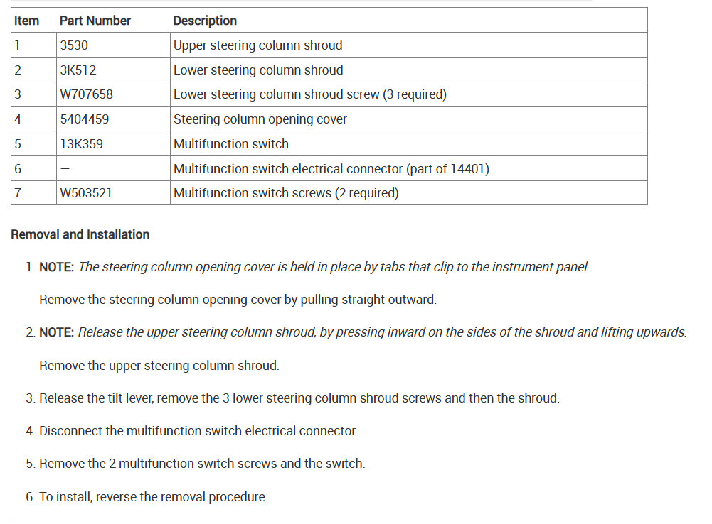

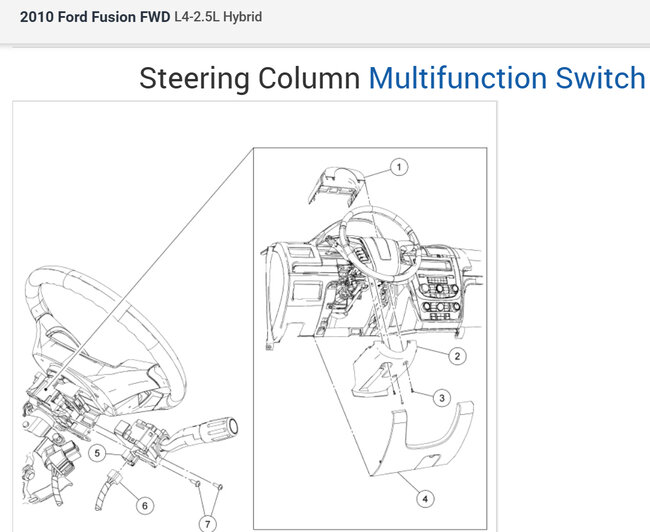

Did the old switch cancel? If so, I would get an OEM part, it seems like the aftermarket part is missing something. Also, when the part is out, turn the steering wheel and look to see if the cancelation tangs used to turn off the switch are still intact. Let me know, here is how the job is done so we can be on the same page. Check out the images (below). Please upload pictures or videos in your response of any problems so we can see what to help you with.
