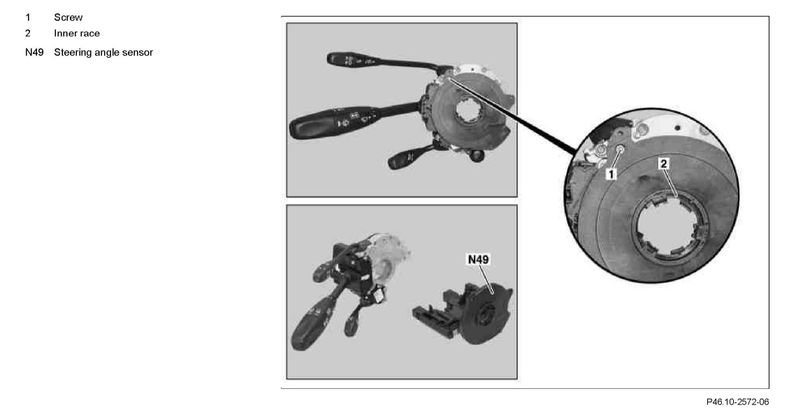

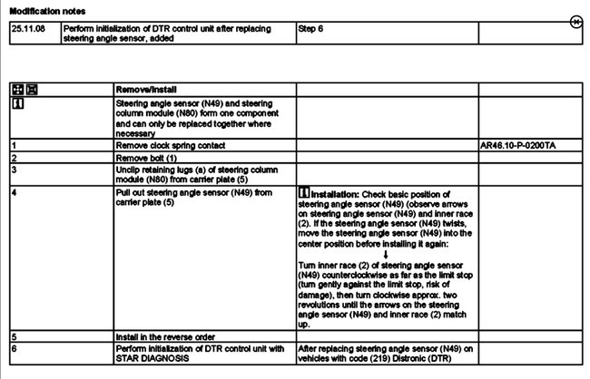

i would say that the sensor is giving incorrect vector angles to the BCM i feel that the sensor is faulty and it should be replaced. a steering angle calibration will have to be done with a new sensor fitted. i would think that a dealer will have to do this procedure.

could well be a side affect of the steering angle signal being incorrect, fix this first.
