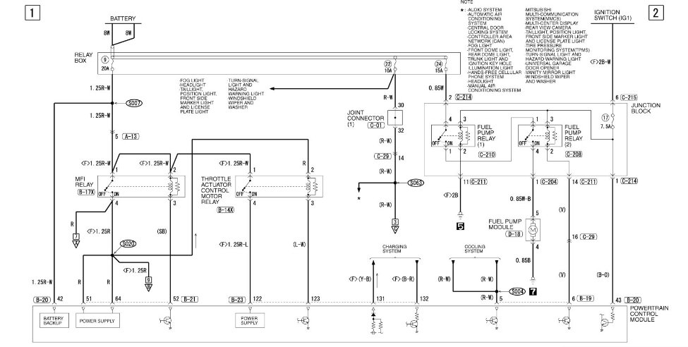

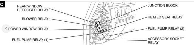

Where are the MPI relays?
Apr 7, 2018 at 9:05 AM
Experienced Mechanic
52,796 POSTS
Good evening.
What do you mean by MPI relays?
Apr 7, 2018 at 9:08 AM
HAYDEN N ASHLEY BRIDGES
MEMBER
2 POSTS
The MPI relay that controls the fuel pump.
Apr 7, 2018 at 9:15 AM
52,796 POSTS
There are two fuel pump relays. I attached a picture of the location and a wire diagram for you to view. check the fuses for power with a test light on both sides.
