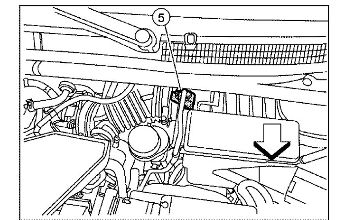

went from 31 highway, to 18, city 22 to 15. i replaced plugs, air filter, and Master air flow sensor. It acts like it's missing but it's not. its runs great has great pick/up and speed runs smooth but at city driving i can really feel the jerking.

Idles perfect, no misfires unless driving at slower speeds and you usually feel it when you let off the gas and it's jerks a little a couple of times.

Any codes? most of the time when this happens is because the MAF sensor is off but not enough to trigger a code. Here is the location so you can check it out and replace the sensor to see what happens.
