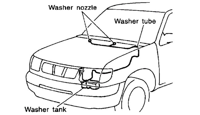

My sons's vehicle listed above had its windshield washer reservoir and pump removed by the previous owner. I'm helping him to get his truck back into working condition, so I purchased a new windshield washer reservoir with pump, but the factory service manual that I have for the vehicle has zero information regarding its removal/installation. I tried downloading the OEM parts diagrams for the windshield wiper/washer system, but they weren't of much help either.

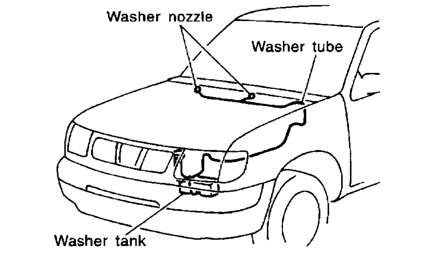

The reservoir is somewhat hidden. I attached a picture of its location. Please let me know if that helps.

Anyone can download the same Parts Diagram from a Nissan Dealer's Website. The problem is that this provides zero information regarding the reservoir's mounting points.

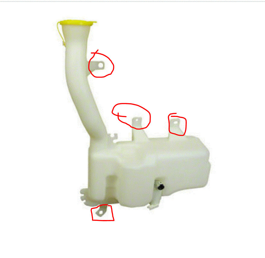

Your heading indicated "Location for windshield washer and pump" so that's why I attached that pic. So, I'm not sure what you are asking for. The mounting points are between the front bumper and radiator core support and is held on by 4 bolts. See attached pic of bottle. If this isn't what is needed, let me know.
