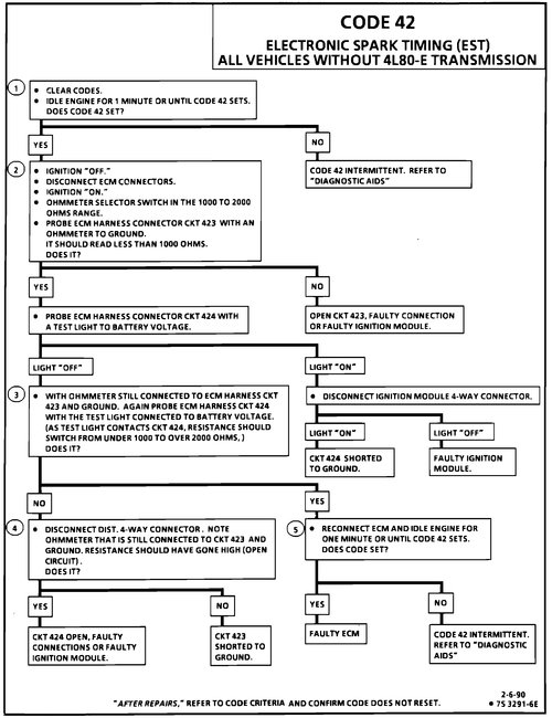

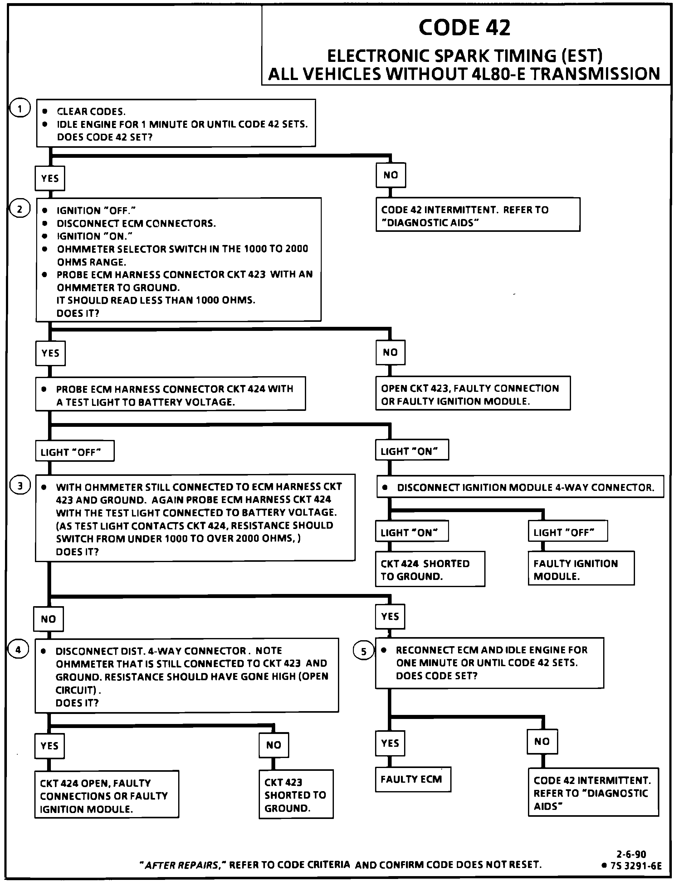

It shows a 13 and a 42. I don't understand number 42.

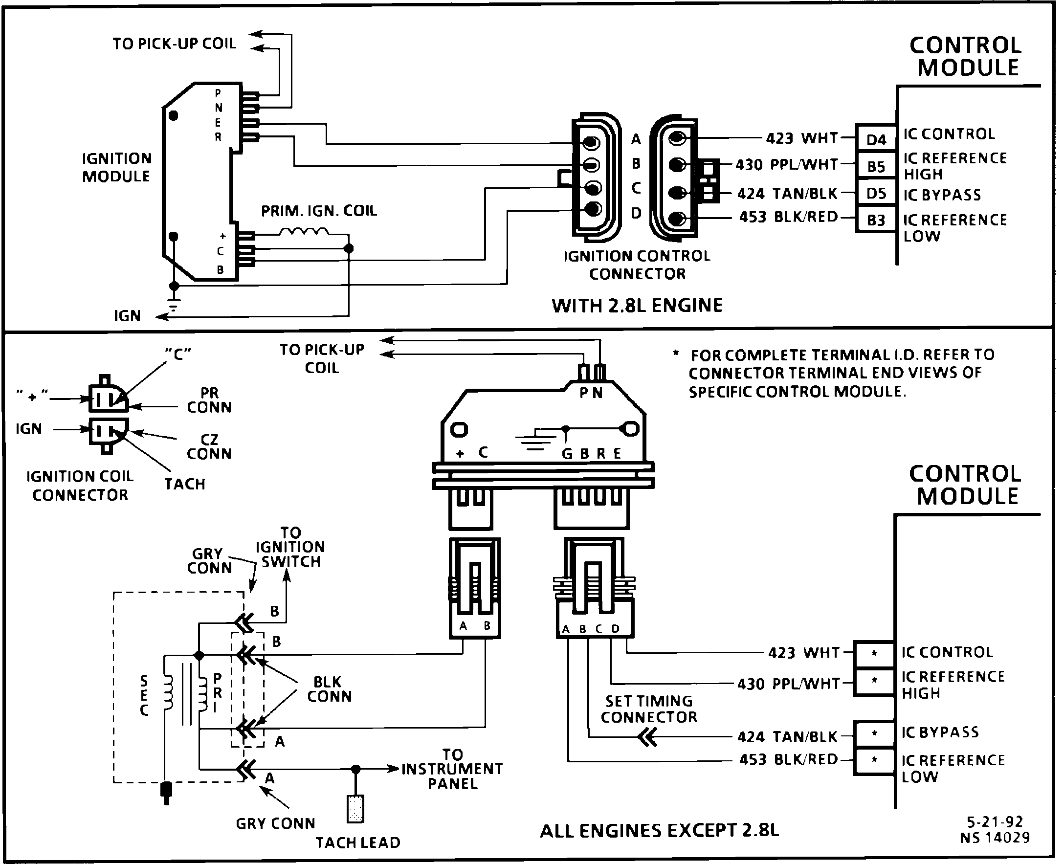

Code 42 is related to the electronic spark control system. That can cause this. I attached the flow charts in pics 1 and 2. Let me know if you can read them. Also, what do you mean about the timing mark on 0?

On everything I have found it says to put the timing when it's running on top dead center on o. I don't see the flow charts.

Sorry about that. I attached them after I already sent the post. They should be there now. If they still aren't available to you, let me know.

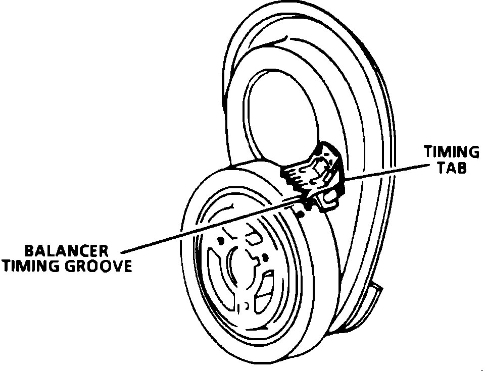

Next, here are the directions for adjusting timing. My specs don't show 0. Where did you get that?
Take a look through this and see if it is what you are doing. The pics attached correlate with the directions.

Timing Mark
pic 1

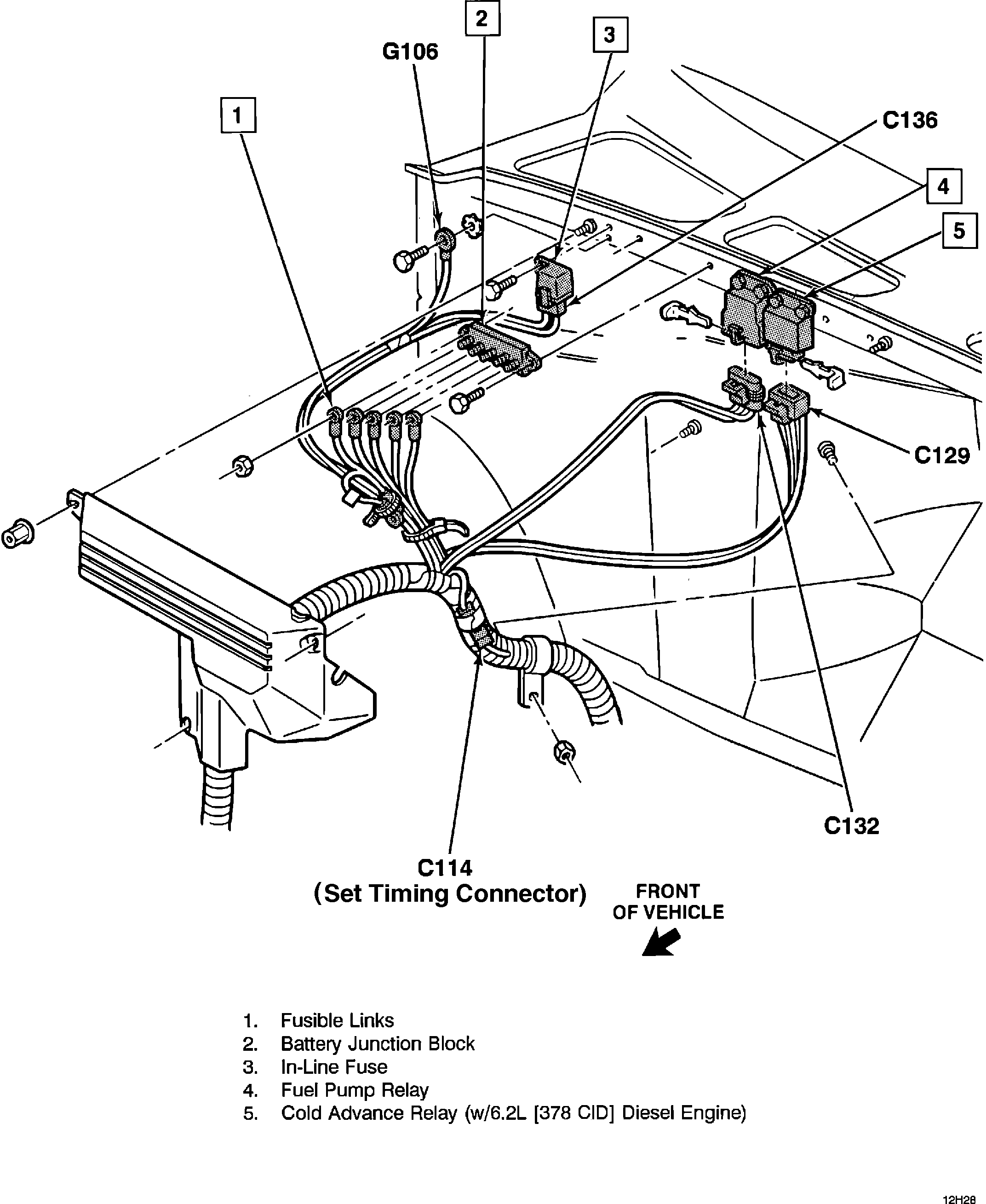

Battery Junction Block And Relay Wiring
pic 2

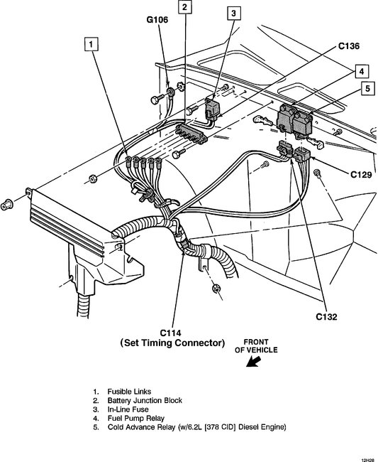

Disconnect SET TIMING connector (C114, tan/black wire) located in center of cowl, under battery junction block cover. DO NOT disconnect 4 wire connector at distributor.
Connect timing light and adjust as necessary by loosening hold down bolt and rotating distributor. For specification, refer to SPECIFICATIONS/TIMING MARKS. Tighten hold down and recheck the timing. Stop the engine and connect SET TIMING connector. Clear ECM trouble code by disconnecting ECM power source. With engine at operating temperature, drive vehicle at part throttle with moderate acceleration and decelerate to idle condition. This will "teach" the ECM/VCM and return the engine to normal performance.

I'm doing all the instructions right, and the picture of the harmonic balancer with the line across it that shows to be on zero on my mark, but I can't get it there without it shutting off and not cranking back up.

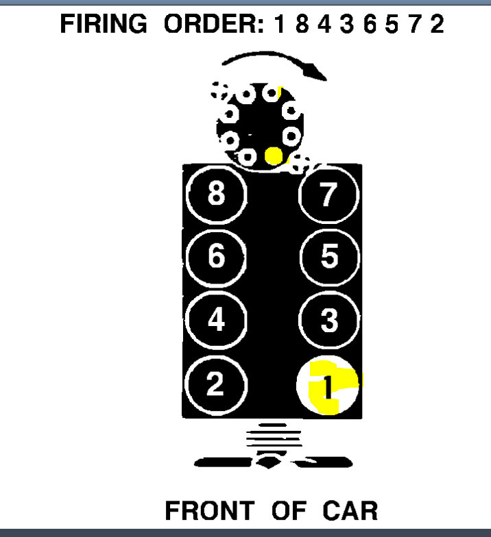

If that is the case, I have to ask. Was the distributor removed? Are the plug wires correct? What you are describing sounds like it is firing too early. Even though the timing mark on the crank is correct, something is fighting it from turning, and most times that is the result of ignition spark being introduced too early.
Let me know, and I will wait to hear it. I have a feeling the timing chain may have jumped. Please reconfirm that the plug wires are in the correct order from the cap. Also, when you place the crankshaft pulley on TDC, remove the cap and see if the rotor is pointing at the number 1 spark plug wire. I attached a pic of the firing order.
