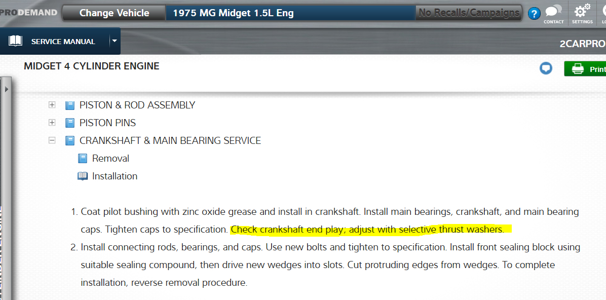

Hello again,
I don't think you could have over tightened the crankshaft pulley bolt causing binding of the crankshaft. According to the description in the diagrams down below, the crankshafts end play is taken up during installation with thrust washers, so there shouldn't be any end play to begin with. Also, most crankshaft pulley bolts are torqued down in multiple stages with high torque values to ensure the bolt doesn't back off, so I just don't think that is the case. If the main bearing caps were over-tightened, this would cause engine drag, along with bearing failure, as would the connecting rod bearings being overly tight, although, getting the connecting rod bearing bolts properly torqued down with sufficient lubrication on the bolts is the most important thing for engine longevity that an engine builder can do for a engine. Anyway, I would suspect a starter in need of new brushes or replaced all together as the problem.

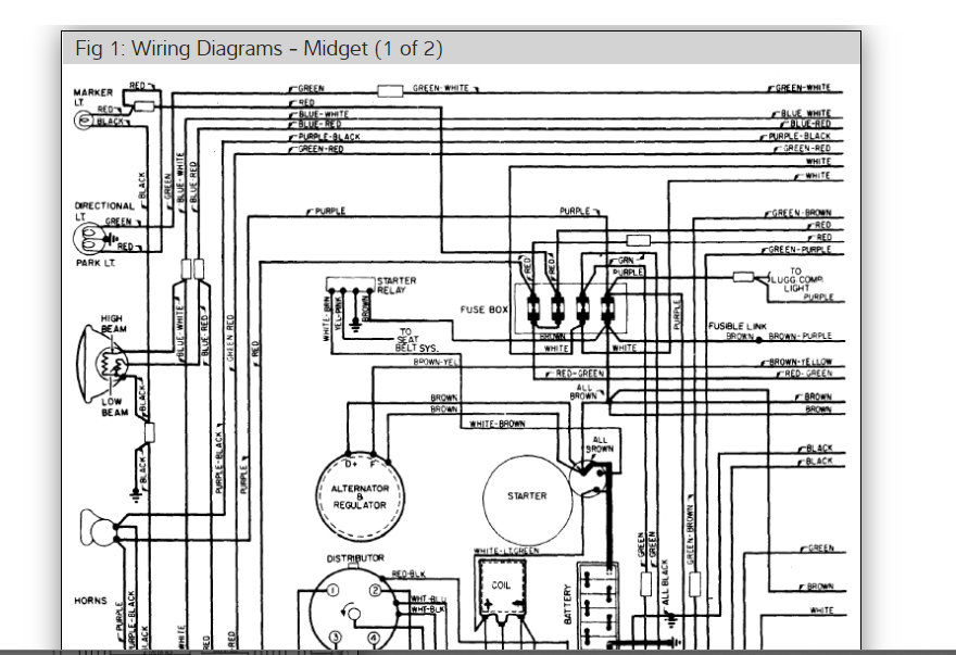

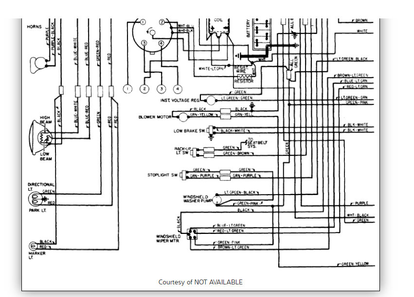

Hello again,

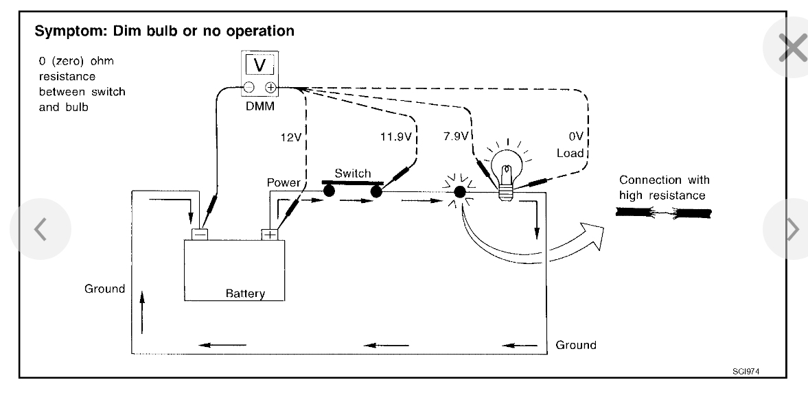

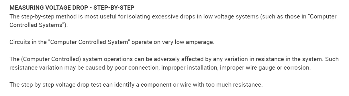

Okay, so to test the battery you can take a voltage reading across the terminals with a Digital Multi-meter (DMM). A healthy battery should return a reading of 12.6 volts. 12.45 volts is 75%, 12.3 volts is 50%, 12.15 volts is 25% charged, and 12 volts and under is technically considered dead. This, of course, is a quick test, the proper way to test is with a load on the battery, but it will give you some idea of where your battery's charge is at. In the diagrams down below I have included a wiring diagram for the starting system of your vehicle. With the help of an assistant, and some jumper extension wires, could you do a voltage drop test on the white/brown wire going from the starter to the battery. I have included a guide explaining how to do a voltage drop test in the diagrams down below for you as well. This test will give an accurate reading as to the health of this wire which supplies the starter with battery voltage. Also check the connections at the battery and starter for any corrosion, and make sure that they are clean and tight. Please go through these guides and get back to us with what you are able to find out.
