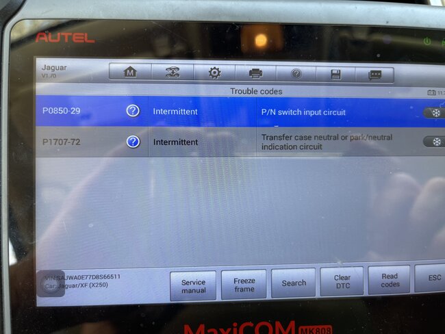

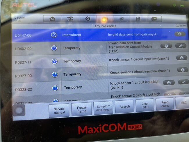

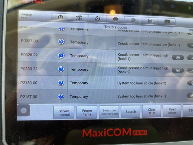

At 35,000, unreal. this does not sound good. Battery is dead, jumped it from trunk, here are the codes before i deleted them, they didn't come back while turning the motor.
Oct 11, 2022 at 4:45 AM
  • 55,394 POSTS
Thanks for the video, it sounds like the engine has no compression. Will the engine run on starting fluid? Here is a guide to help you with the compression test. I would not worry about the codes for now.
Please go over this guide and report back.

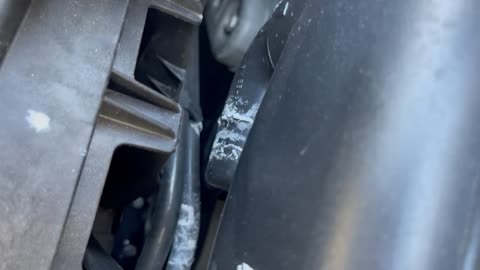

Sprayed some nothing happened. There is a small coolant line that is broken. Maybe the car overheated and blew a gasket. Is it possible for a car that has been sitting for a while to develop no compression?

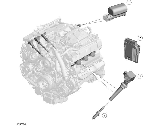

How can i check the spark on this engine? and would you spray starter fluid directly into the throttle body?
Oct 13, 2022 at 9:53 AM
  • 55,394 POSTS
Yep, either no spark or no compression. here is how to remove the ignition coils and a video to show you how to check for spark, while you are at it check the engine compression as well.

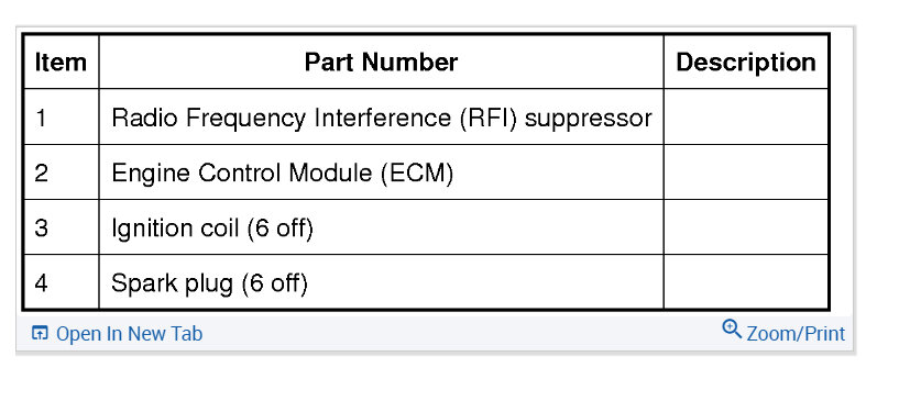

Can you send me instructions on how to get to the spark plug?
Oct 15, 2022 at 7:03 AM
BHAMDOC1973
  • 2,007 POSTS

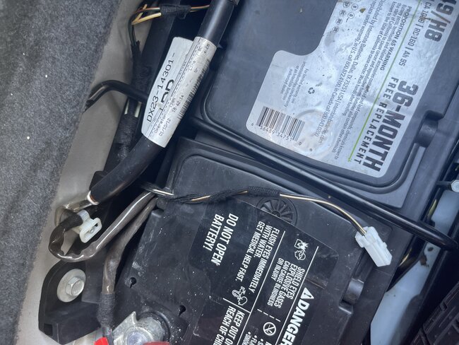

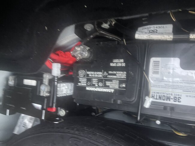

I got to it and there is spark. I opened the fuel line and there is fuel at the ignition on. Do you know what this wire is by the battery? And what is this other battery behind it? Am still using a jumper box every time as the battery has 2v.

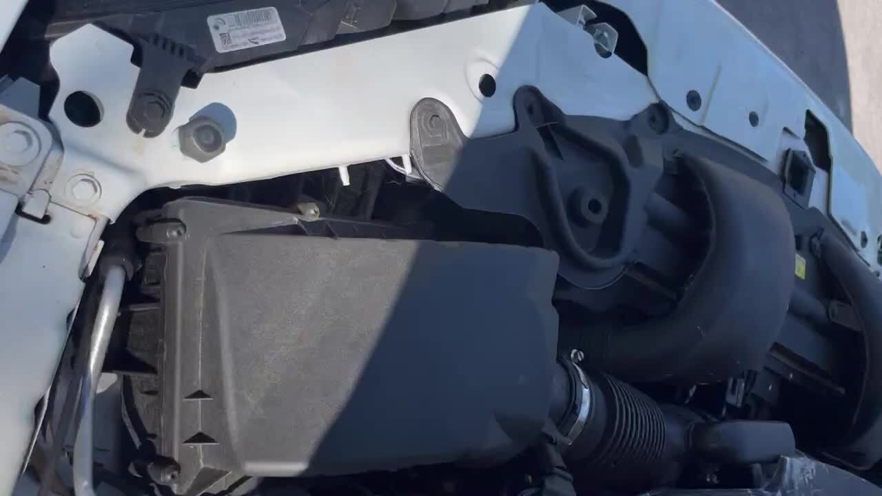

Hard to get to spark plug to remove and do a compression. Am worry it had a wash.
Oct 15, 2022 at 10:05 PM
  • 55,394 POSTS
Yep, we must get at least one spark plug out to to the test. Can you upload a short video on the problem you are having to get the spark plugs out?

It's just super tight. I will try. Do you know what this wire could be from the battery?
Oct 17, 2022 at 5:27 AM
  • 55,394 POSTS
No idea, it could be for the manufacturer to use during the cars assembly.

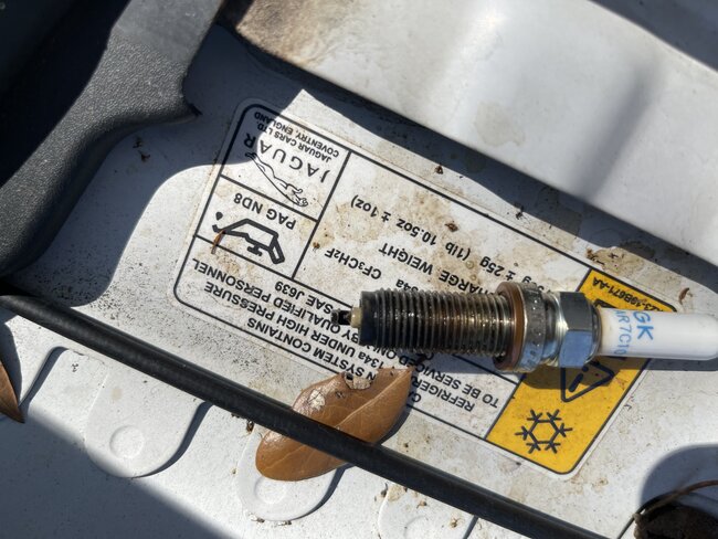

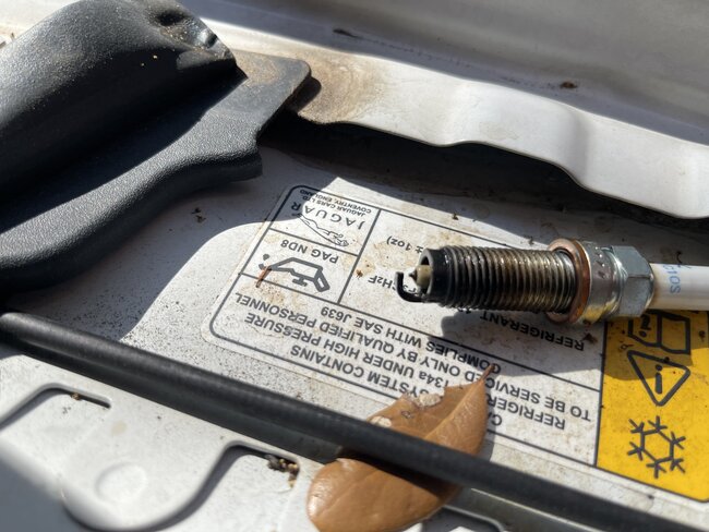

Hopefully i connected the compression connector tight enough but there is zero compression, how can that be? Isn't there always some? The plug was soaked with gas.
Oct 21, 2022 at 6:36 AM
BHAMDOC1973
  • 2,007 POSTS
Attached.
Oct 21, 2022 at 6:37 AM
  • 55,394 POSTS
Yep, that is no good, the engine is hurt and needs to come apart or used engine installed. It could be a timing chain issue. Let me know which way you want to go so I can give you instructions.
