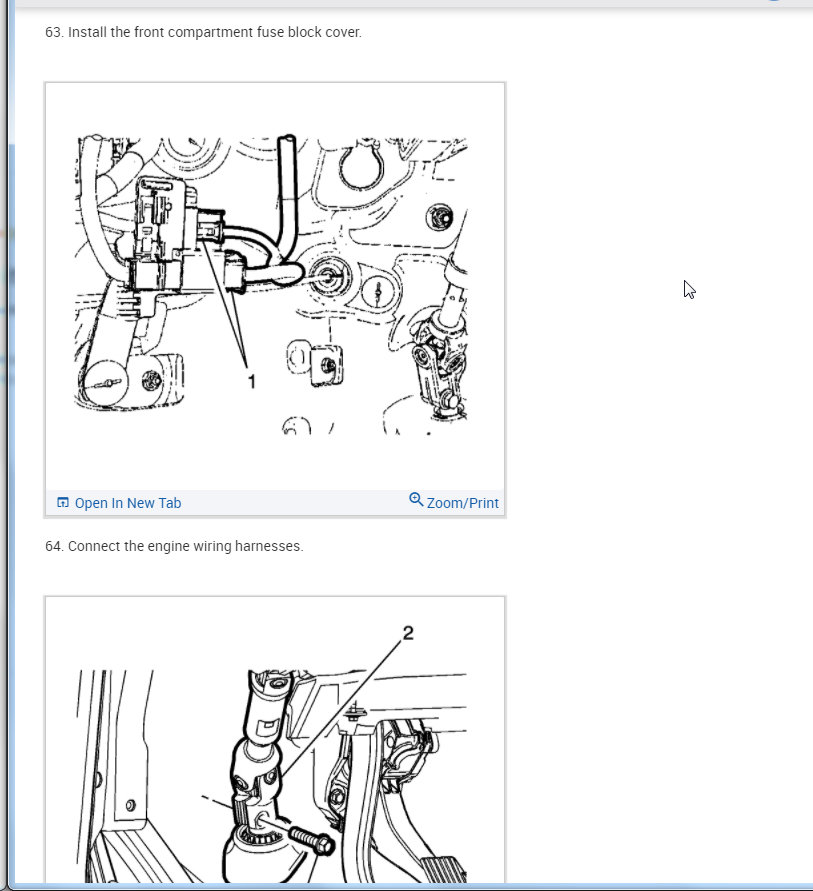

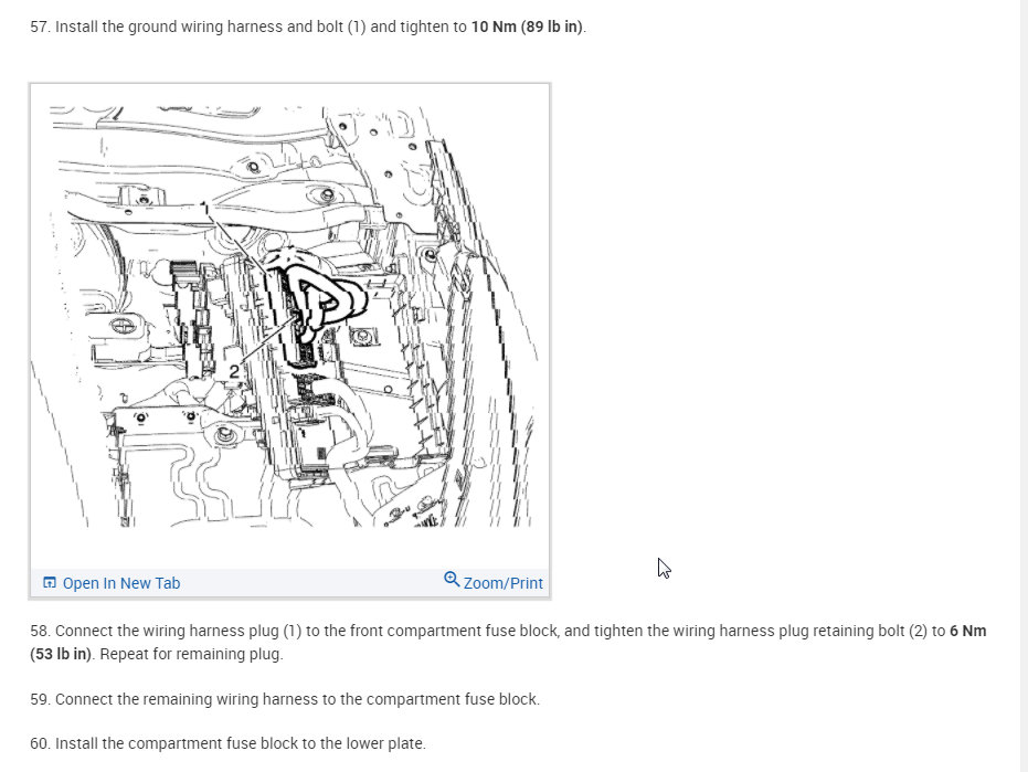

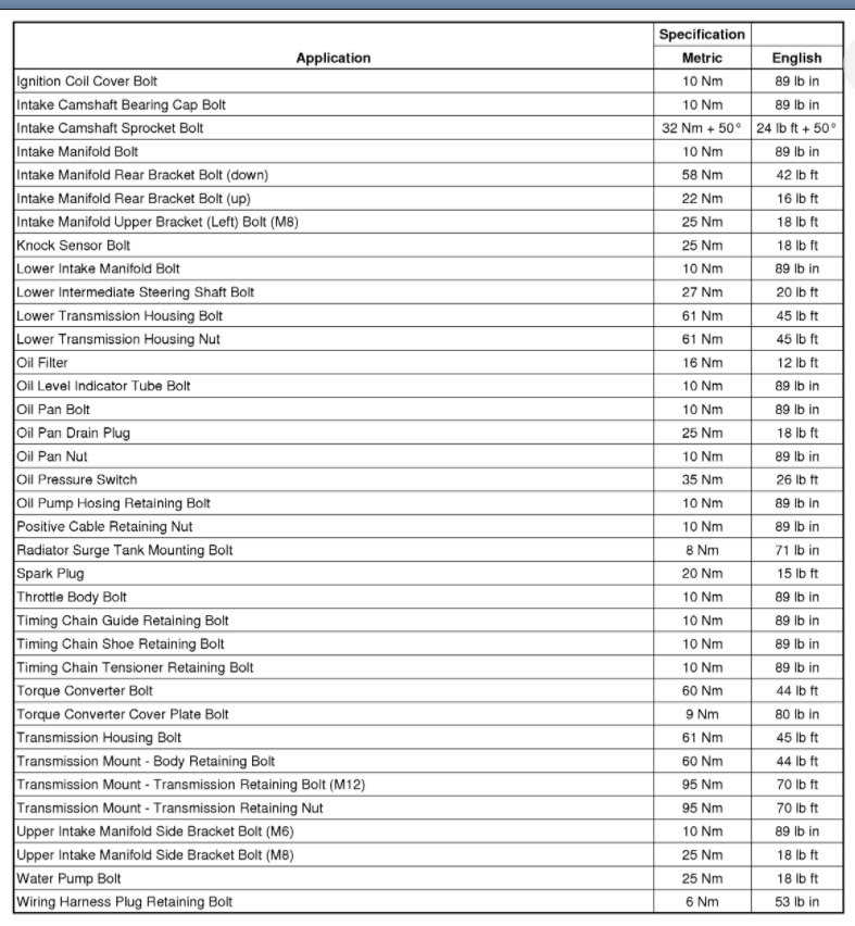

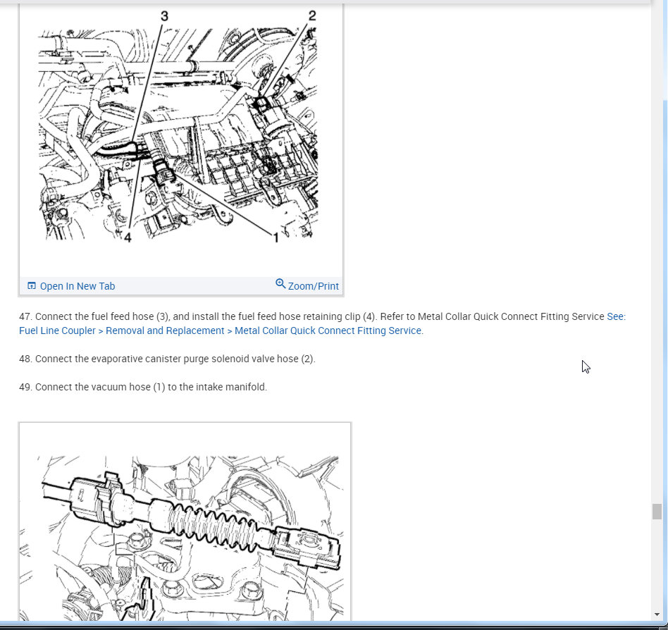

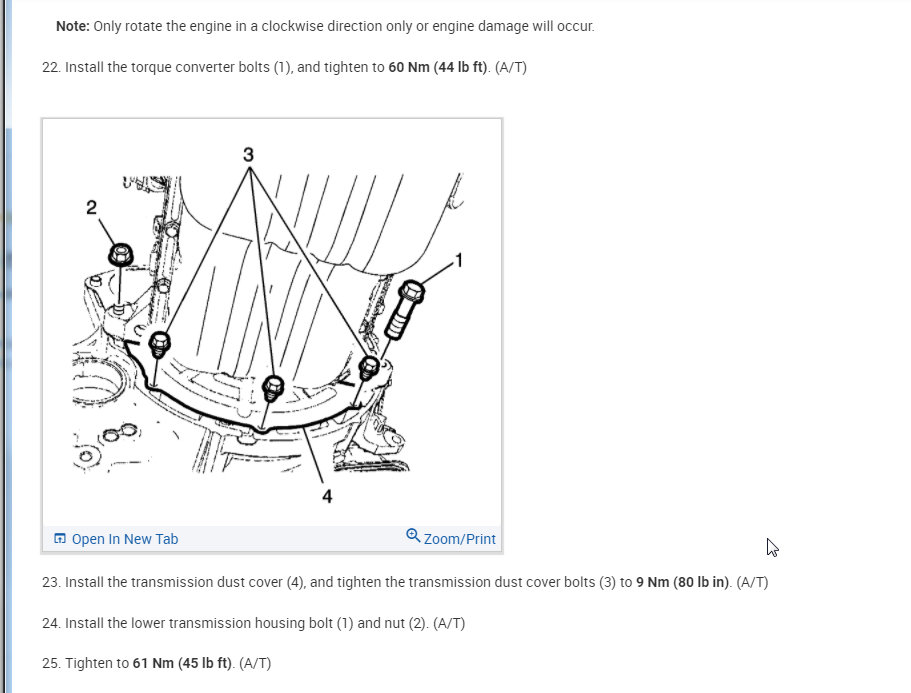

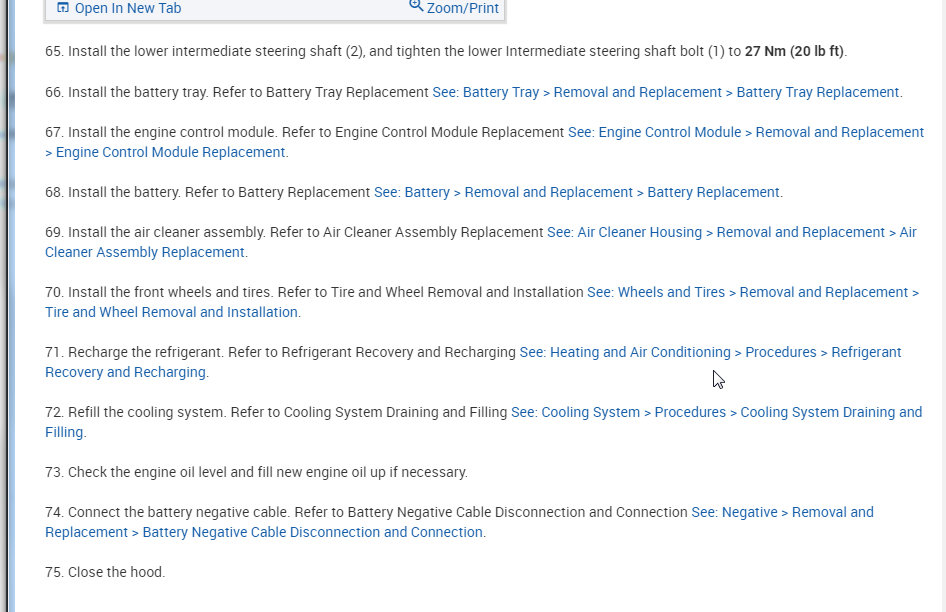

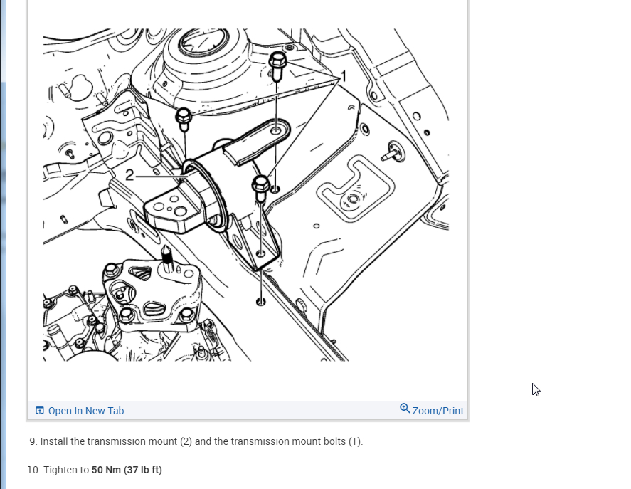

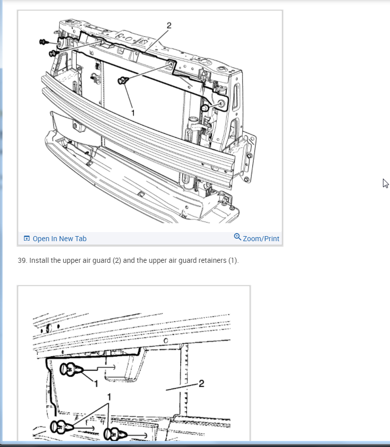

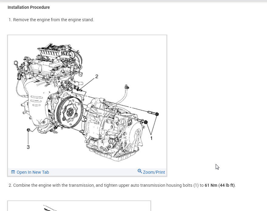

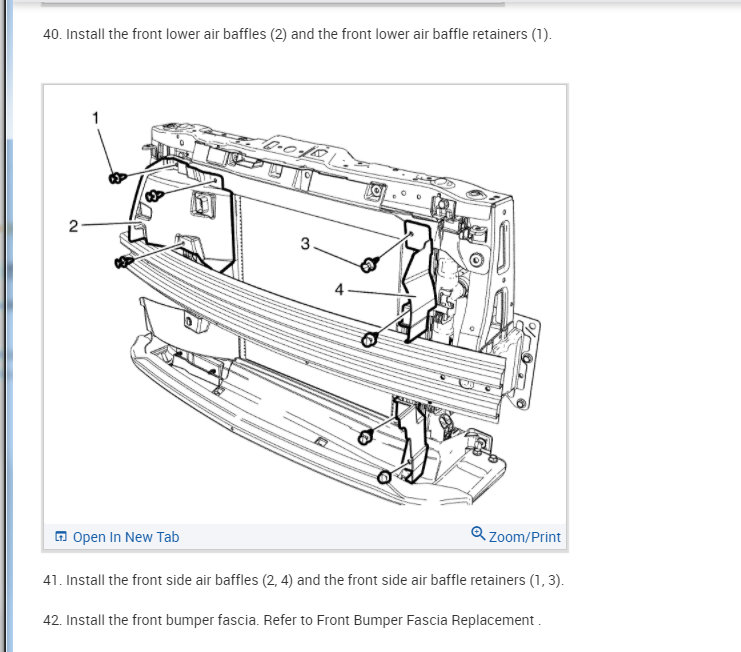

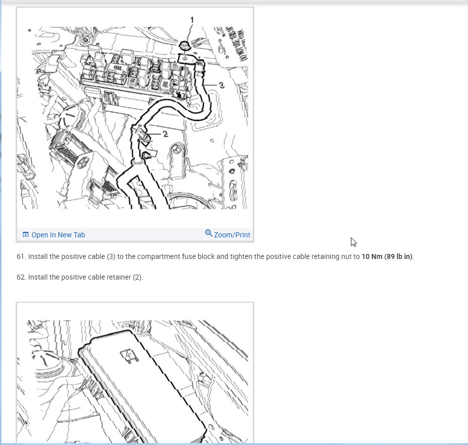

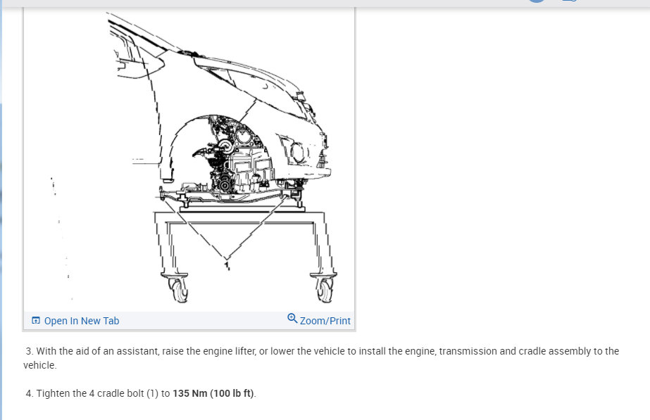

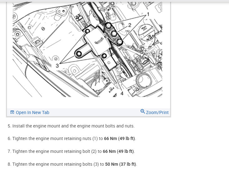

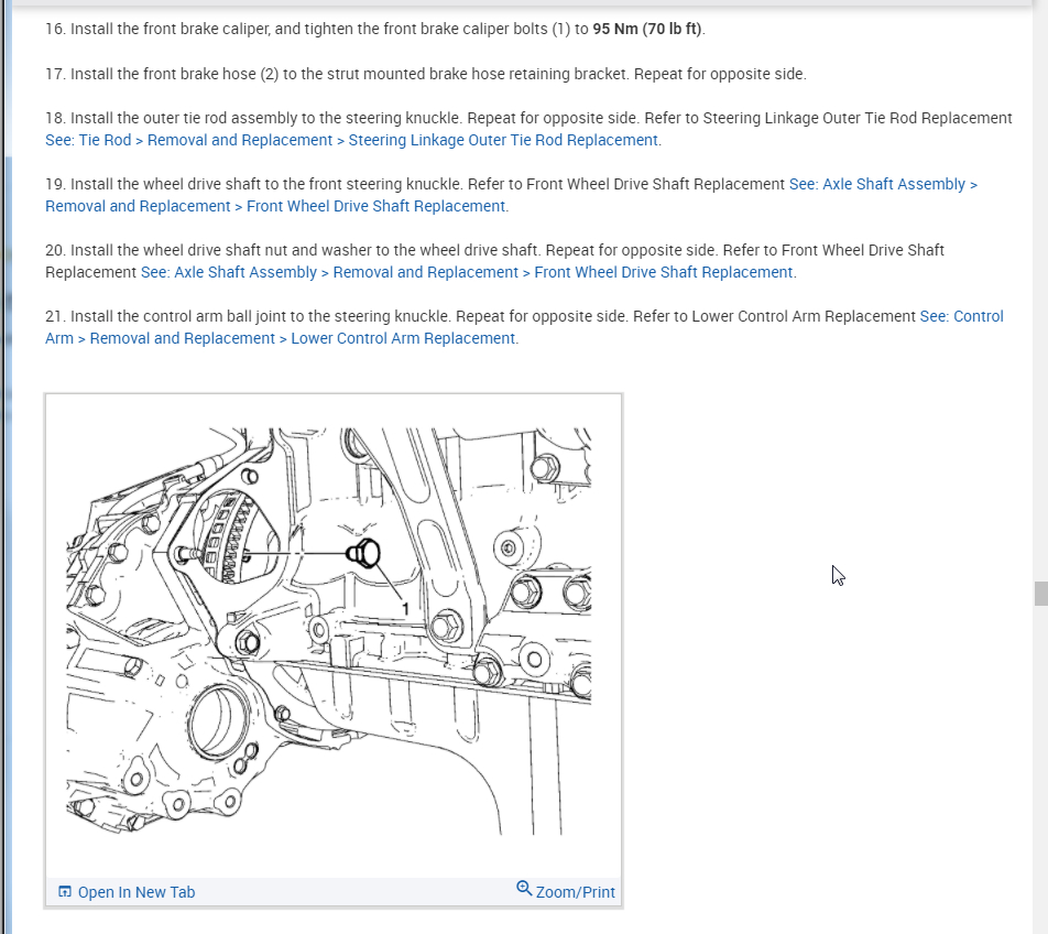

Hello, I have the car listed above 1l s-tech II (M300 B10D1) I'm changing the motor and I can't find anywhere the torque specs even after long research. can you help me?
Sep 5, 2020 at 5:11 AM
We can get them from the manual but what exactly are you looking for? If you are changing the engine I included the procedure on how to install the engine which includes all the torque specs. Let us know what exactly you are looking for that is not included here and we can get it. Thanks
Sep 5, 2020 at 6:35 AM
CHARLY LEFèVRE
hello, thanks for the fast response!

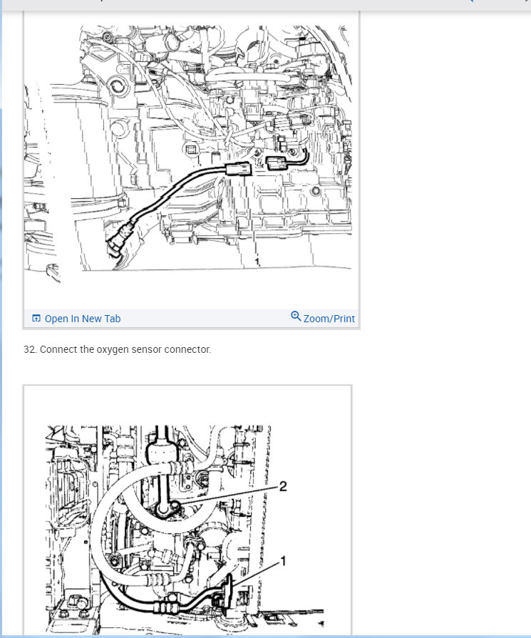

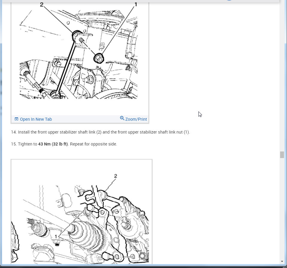

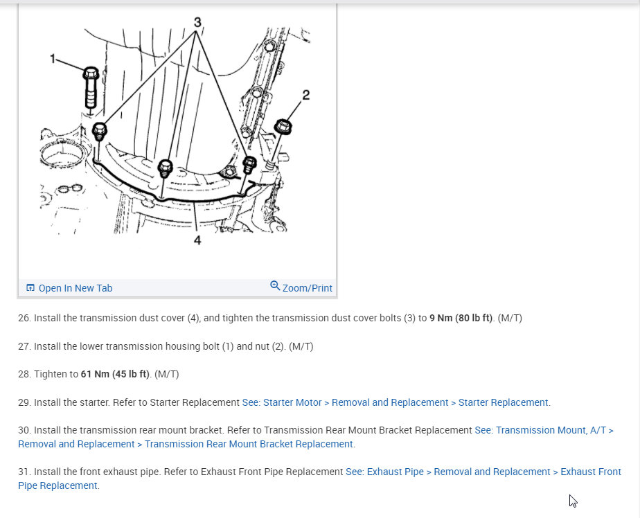

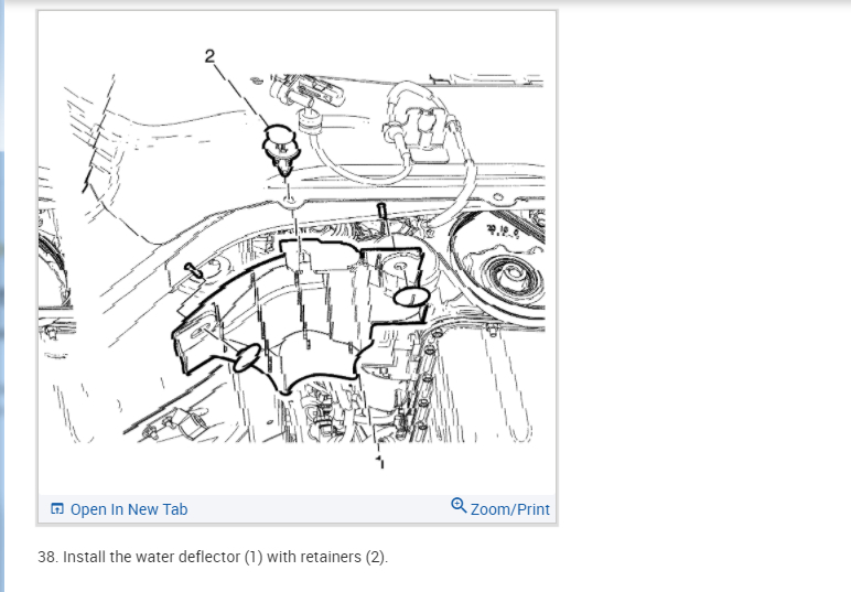

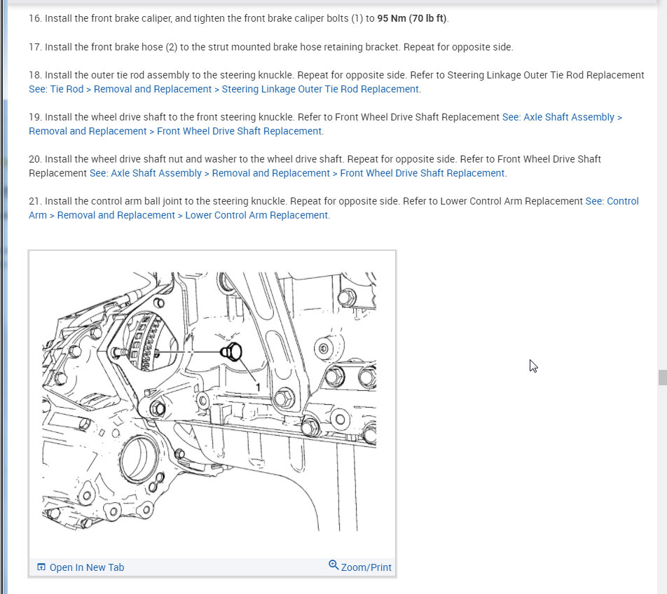

I just need all the torque specs list. I know the procedure , my motor block is already out.
Sep 6, 2020 at 8:22 PM
Okay. Here is the list of all the engine torque specs from the manual. Let us know if there is anything else. Thanks
