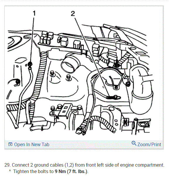

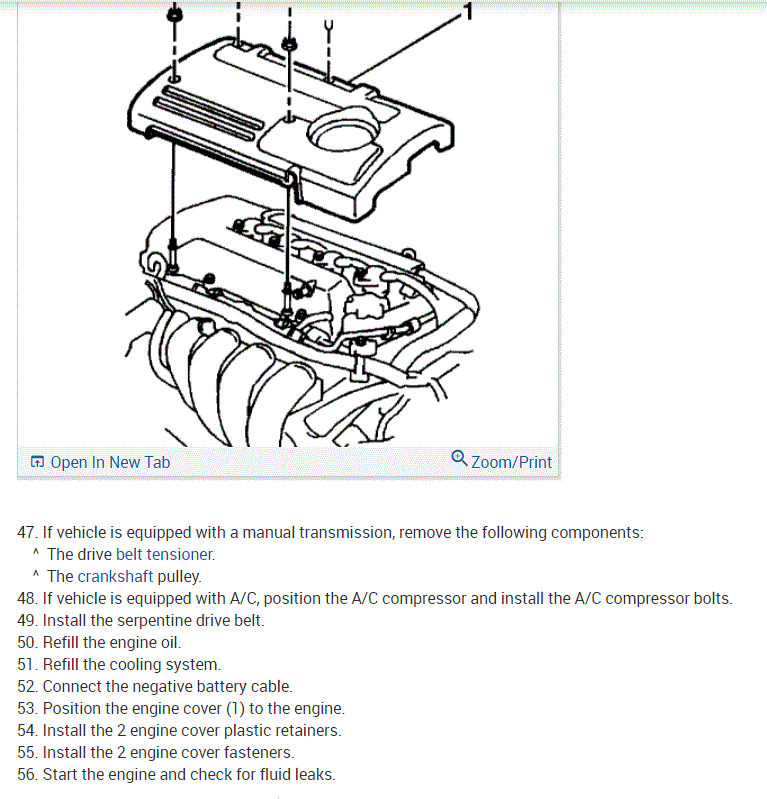

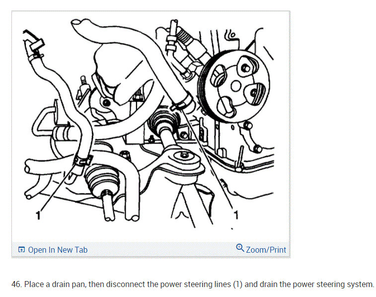

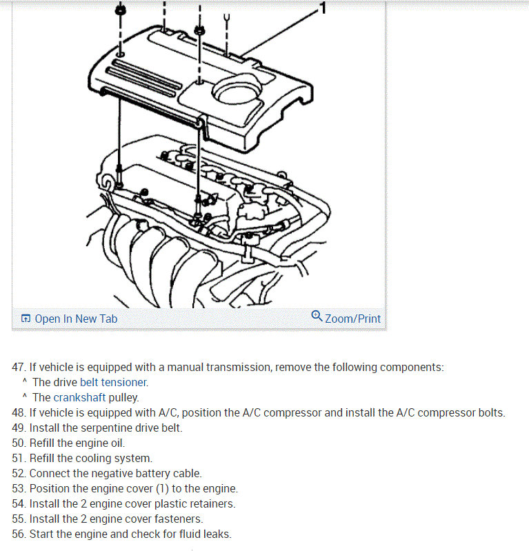

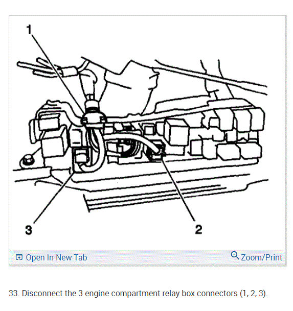

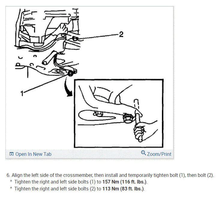

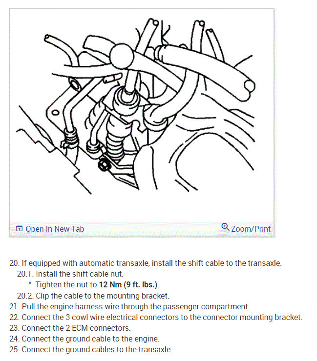

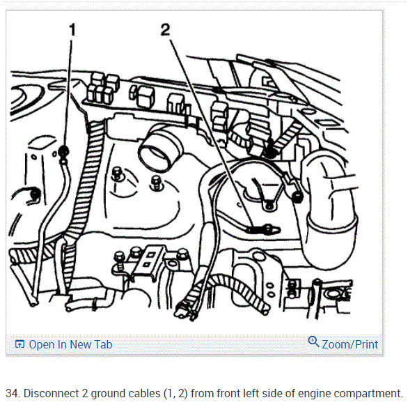

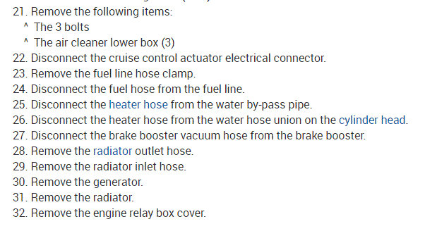

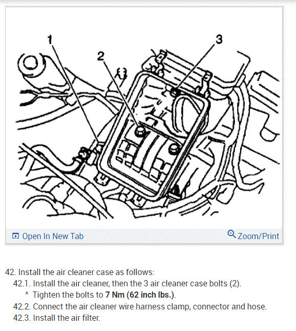

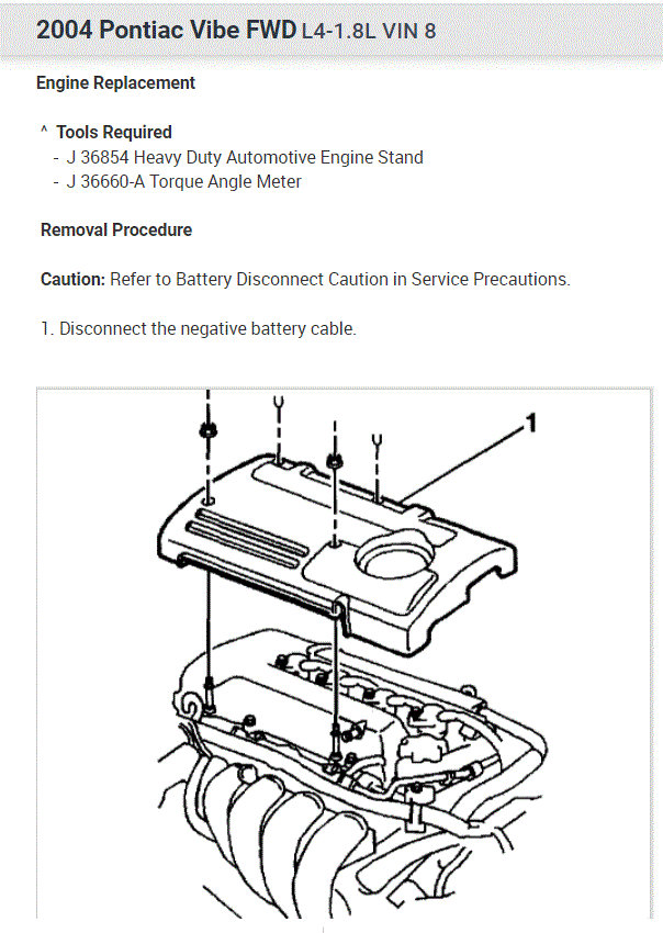

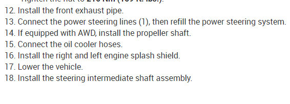

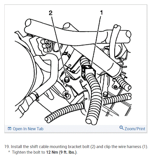

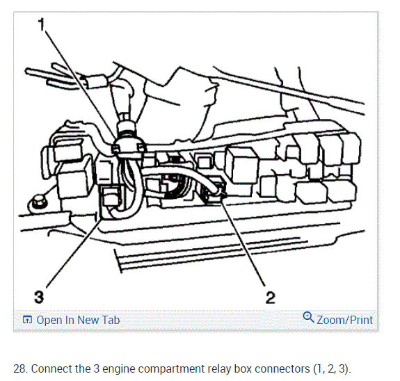

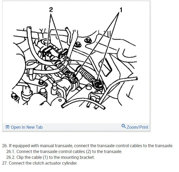

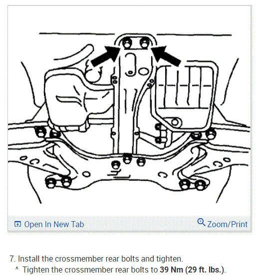

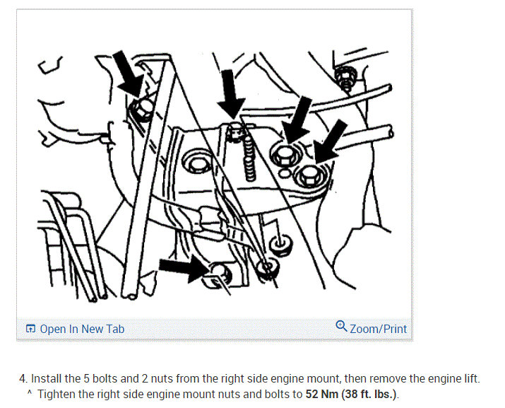

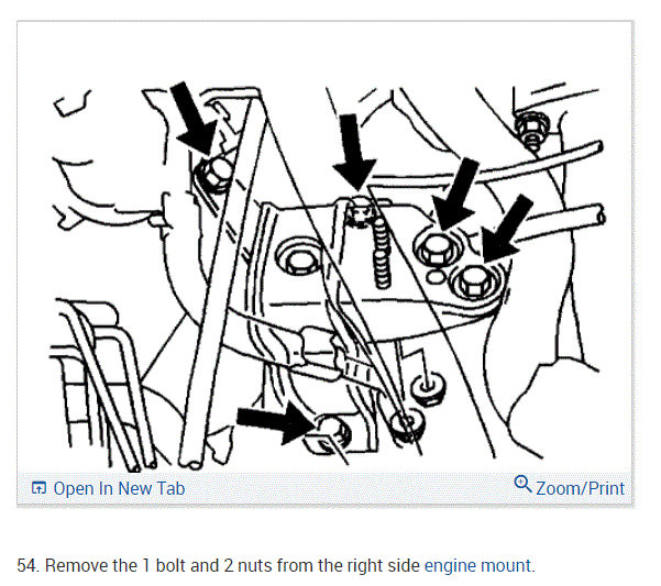

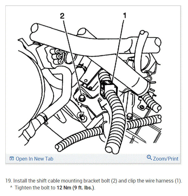

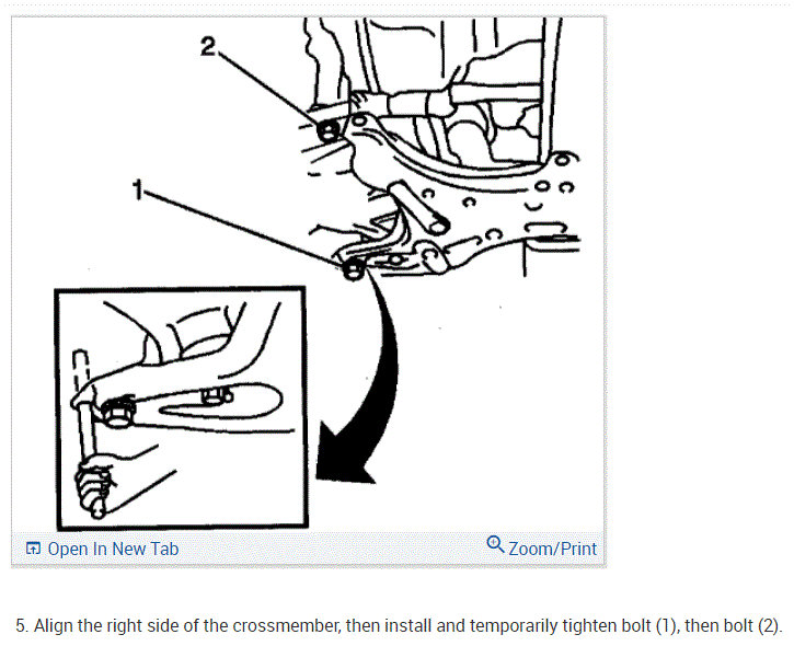

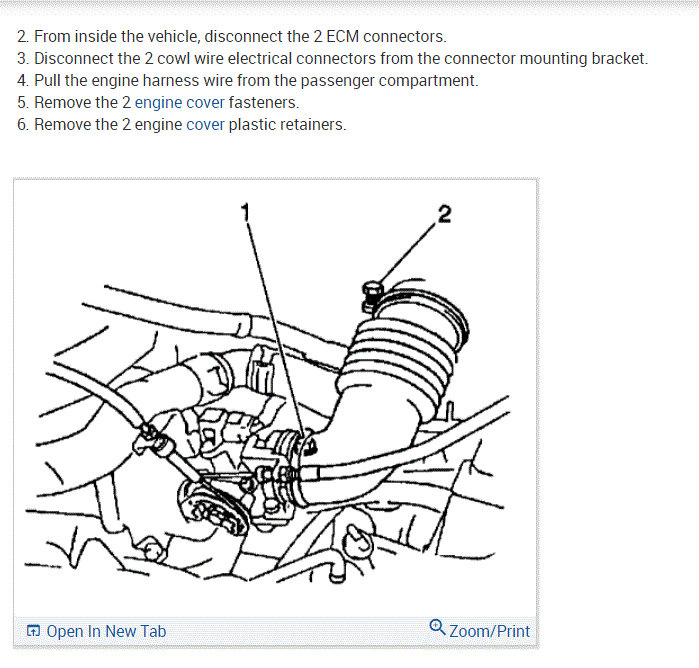

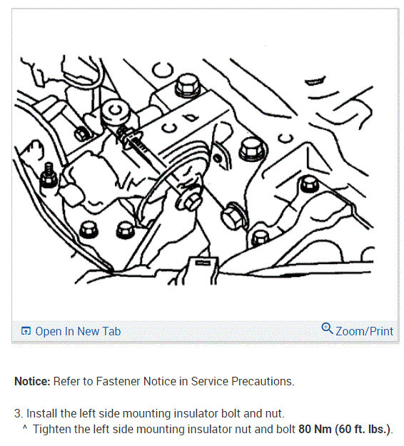

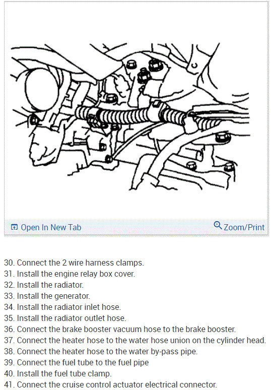

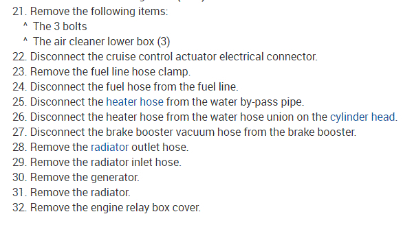

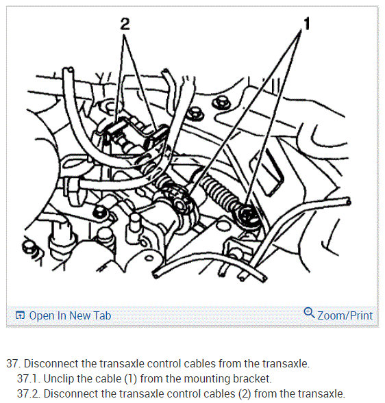

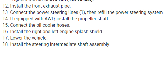

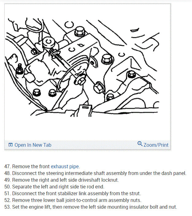

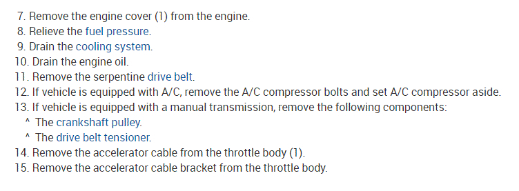

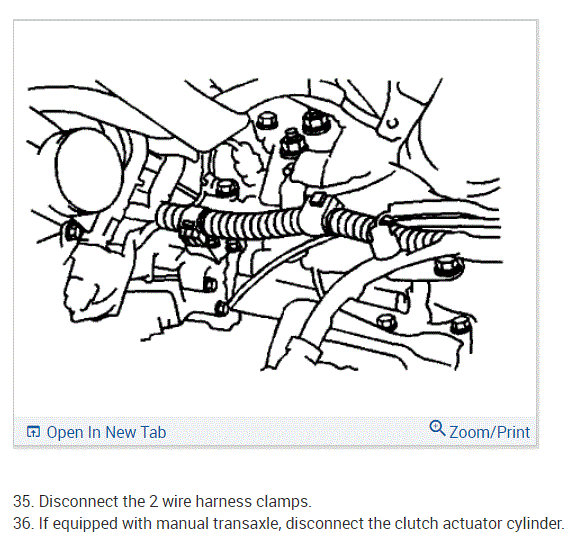

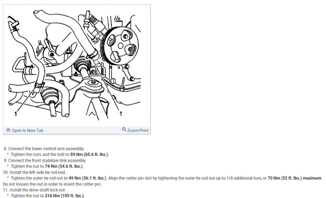

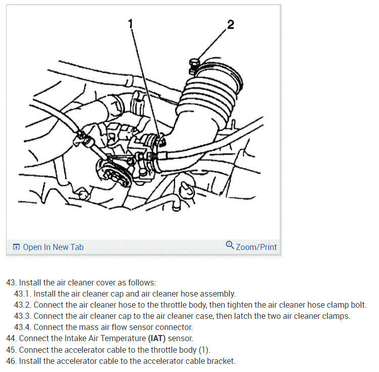

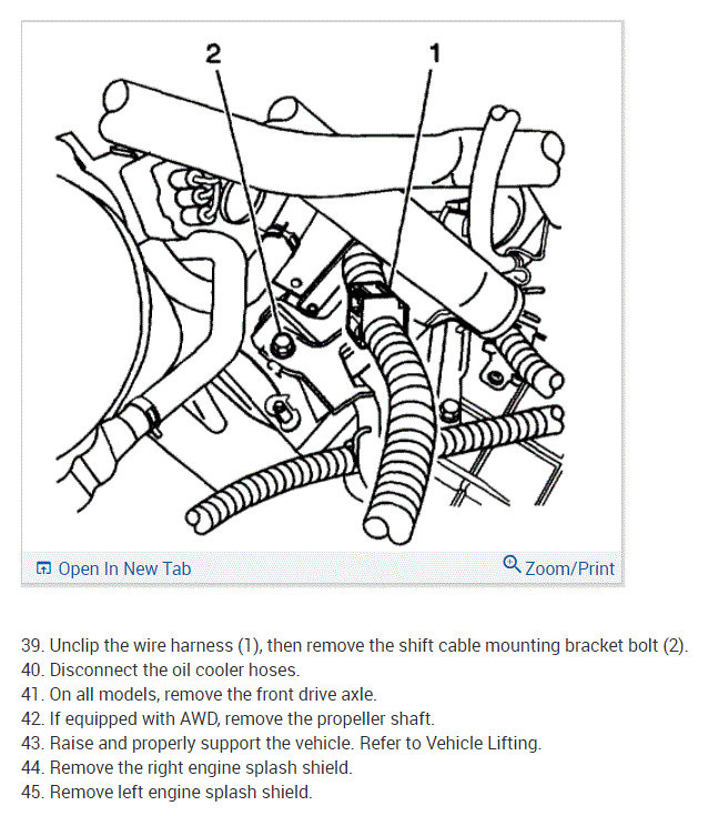

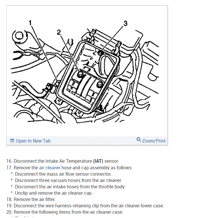

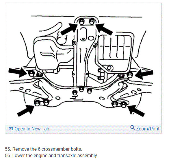

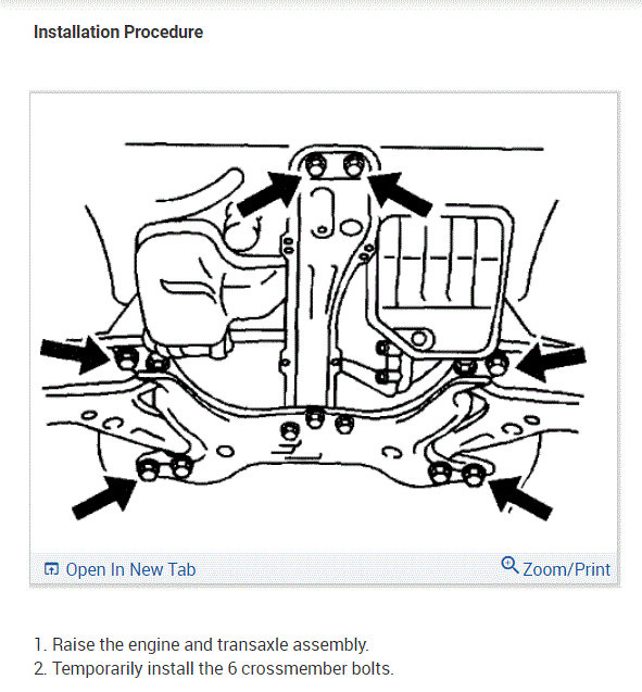

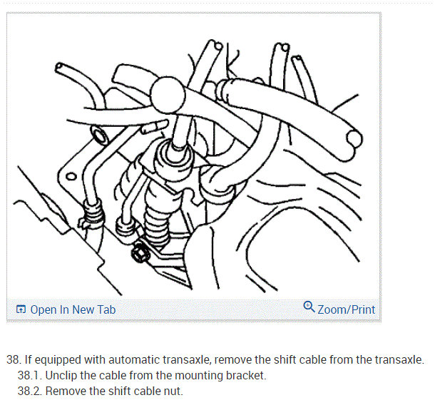

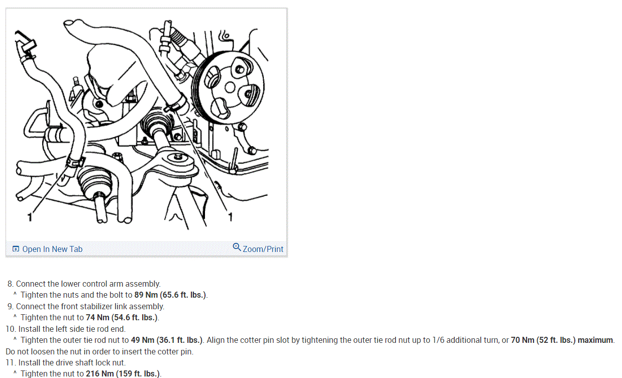

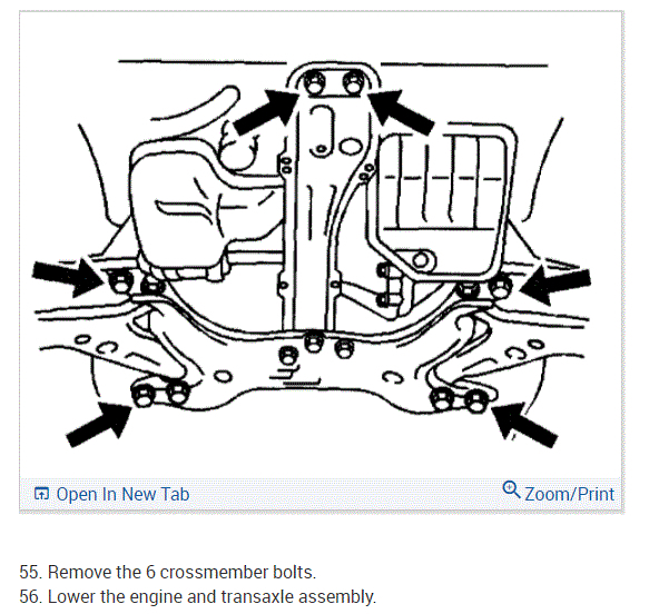

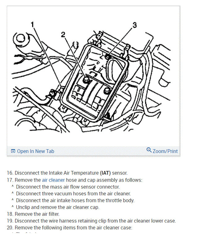

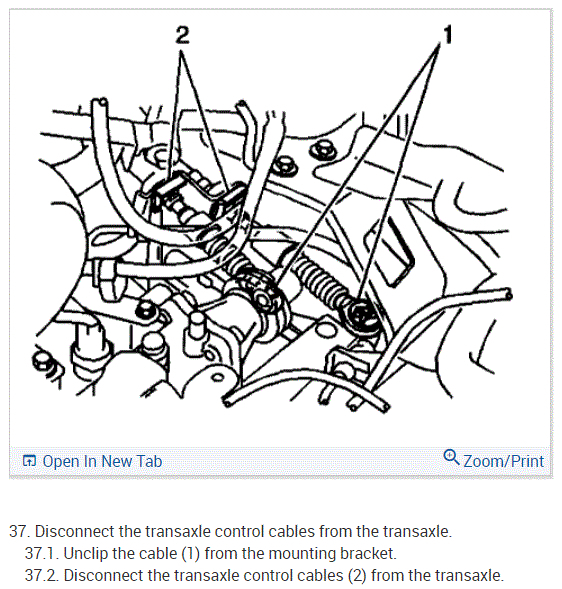

If you do decide to install a new engine in the vehicle, I attached the directions and pictures below specific to your vehicle for removal and replacement.
I hope this helps. Let me know if you have other questions or need help.

Looking at the interchange info it appears that 2003-2008 1.8s out of a Vibe or a Toyota Matrix (same car GM bought them from Toyota) will work, However they have to be from a front wheel drive (AWD uses a different block and mounting) and have option code LV6 for the common version, If yours is the higher option version it uses a different optional engine, Still a 1.8 but code LNK. To tell which you have look at the 6th digit in the VIN number, 8 is the LV6 while L is the LNK engine. Then specify its for front wheel drive.
