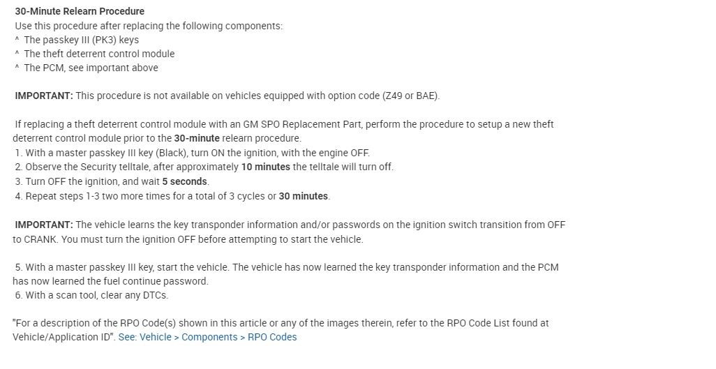

Is the theft light or security light on? From the battery being disconnected, the key may have forgot the password.
Try a security reset.
https://www.2carpros.com/articles/how-to-reset-a-security-system
