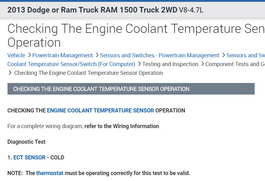

Vehicle overheated. Full hot gauge. Drove approximately 1/2 mile while hot. While driving hot, gauge went full cold? Discovered bad water pump. Replaced water pump, thermostat, clutch, clutch fan, and radiator cap. Repair went well and once started again it ran gauge cool right below middle as always, except when at higher speeds tends to run gauge middle to 3/4? Didn't do before. Also motor is very sluggish especially going into second gear, but overall also. The motor also has a tick tick tick to it that it didn't have before?

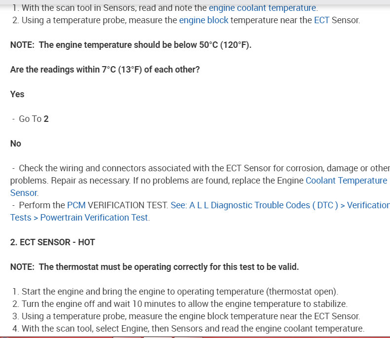

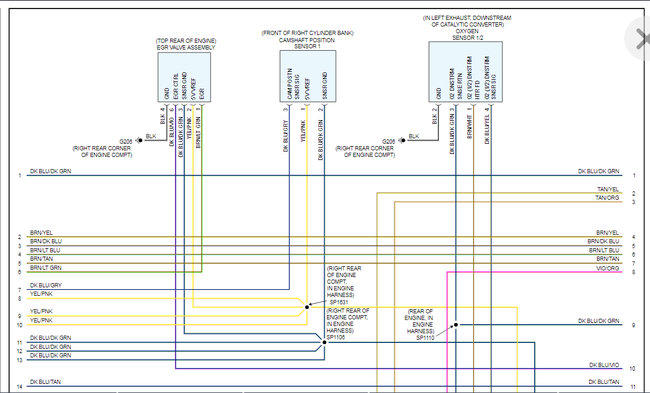

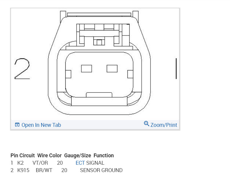

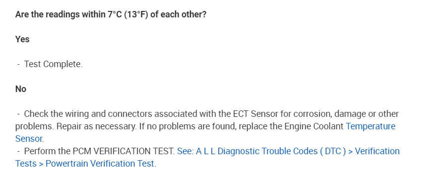

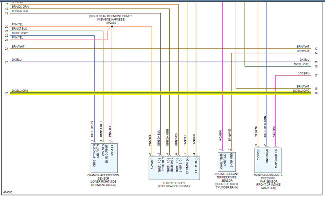

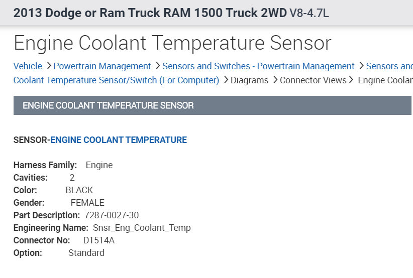

SCGRANTURISMO
  • 4,897 POSTS
Hello again,
Usually that is what happens to a vehicle when they overheat. If you got away without happening to your vehicle, consider yourself lucky. I've always been a big fan of Dodge and Mopar. I love horsepower. It sounds like they had a good day at the factory when they made yours. They ECT or the wiring sounds like it might have shorted out. In the diagrams down below I have included the wiring diagrams of your vehicle's ECT sensor, connector with callout, and testing of the ECT. Please go through these guides and get back to us with what you find out.
Thanks,
Alex
2CarPros
