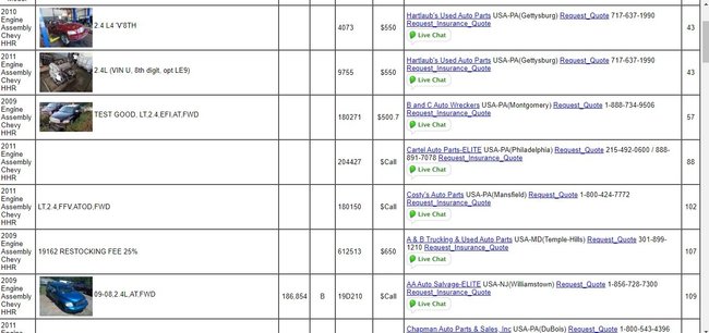

That is a lot for a used motor.
Go to www.car-part.com and enter your information.
I found pages of them and most of them are $500.00 to $700.00.
I would consider this as opposed to replacing the head.
