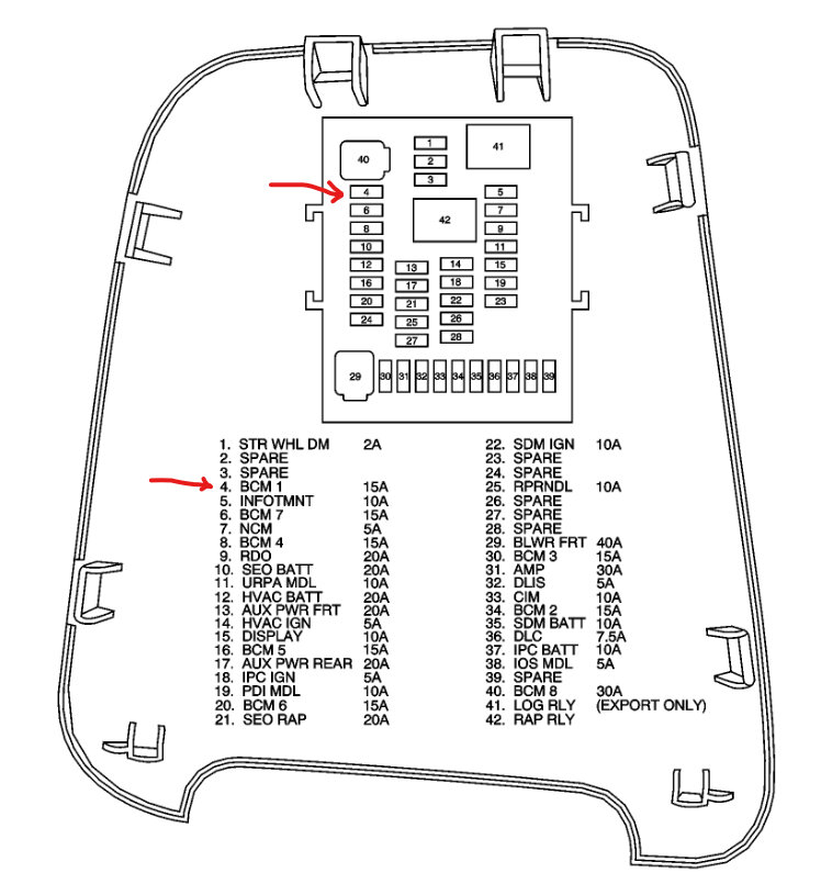

I would start by checking the fuses (bcm1), here is a guide to help and I have included the fuse locations in the images below. Also, double check your work to make sure everything is plugged in as it should be. I would check the grounds which if have been left off the locks will not work.
Please start a new thread for the engine noise problem. Check out the images (below). Please let us know what happens.

I checked fuse it is working also I double check everything plugged same as before.

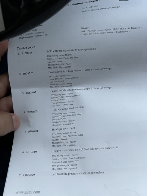

I did CAN scan as you can find attached.
Could you provide the installation location of receiver exactly?
Oct 10, 2024 at 7:48 PM
  • 55,433 POSTS
We only handle one problem per thread and it looks like you have may problems, I would clear the codes, then turn the key on and then do another scan, this will give of the most relevant codes to work with. Did they replace the PCM ?

Okay, it seems like something is wrong with the voltage supply to the PCM, check out the first three codes, I would try clearing the codes and then turn the ignition system on and then run them again to see which ones are relevant still. The problem is the first code with the eeprom error, you usually see this code whent he PCM was been changed.
