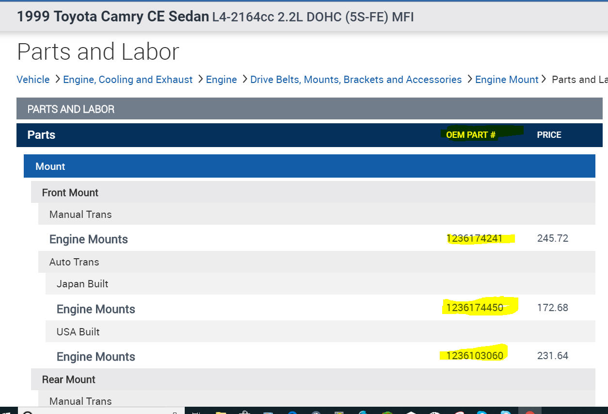

Hello, I've been hearing noises coming from under hood when I have foot on brake or usually when going in reverse.
Went to mechanic and appears that maybe motor mounts replacements are needed, he advised to not go with AutoZone parts because usually car does not run well/still vibrates/noise making with AutoZone supplied parts. he suggested purchasing directly from dealership.
With Toyota, all 3/4 parts needed would run about $650.00 including tax. my question is, is it necessary to have original parts for these motor mounts?

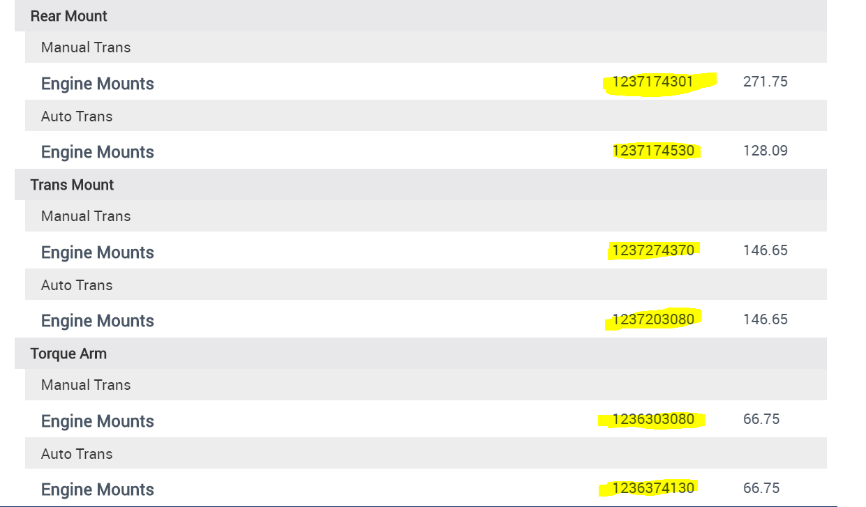

No, not normally. But you get what you pay for, and you can never go wrong with Original Equipment Manufacturer (OEM) parts. A happy medium between parts house parts and OEM parts from the dealership might be to go on eBay or Amazon and get OEM parts from there. You can usually save some money and find good deals for OEM parts there. I have included in the diagrams down below the OEM part numbers for all the motor and transmission mounts for your vehicle to help you identify the correct OEM parts. Please keep us informed as to how everything is progressing.
Thanks,
Alex
