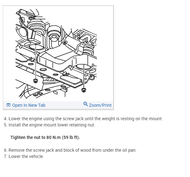

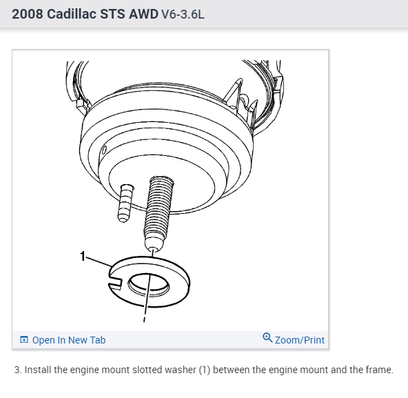

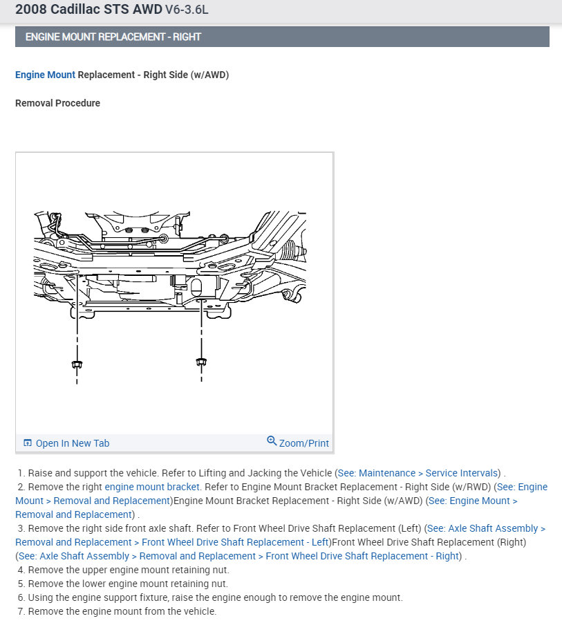

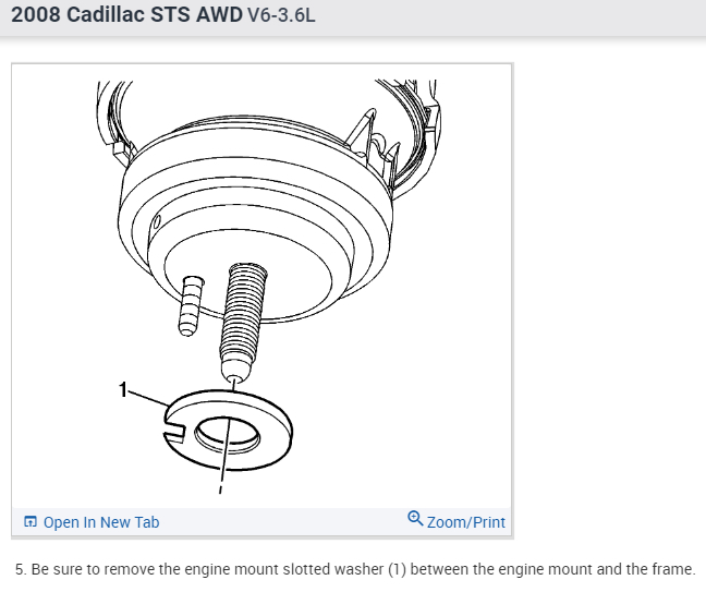

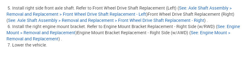

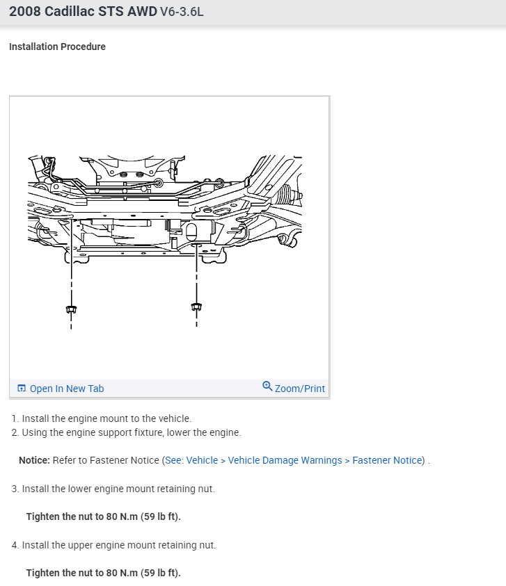

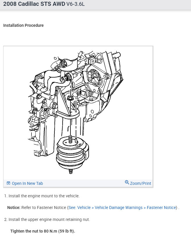

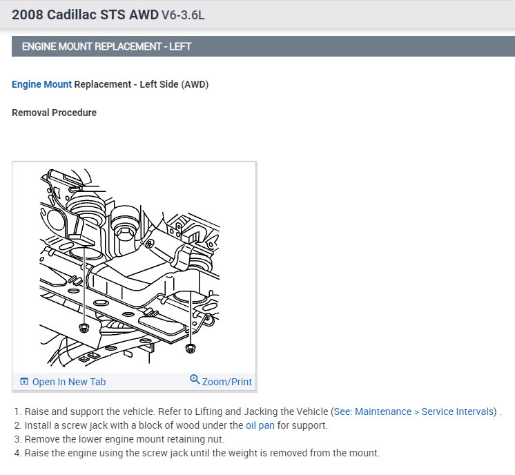

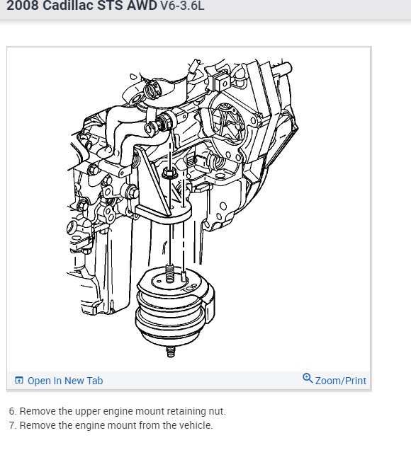

I have to replace my engine mounts, please give instructions with illustrations so I can get this done.
Apr 23, 2022 at 2:25 AM
SQM
  • 6,383 POSTS
See attached for the replacement instruction for the left and right motor mounts.
https://www.2carpros.com/articles/replace-motor-mounts
Let me know of any questions.
