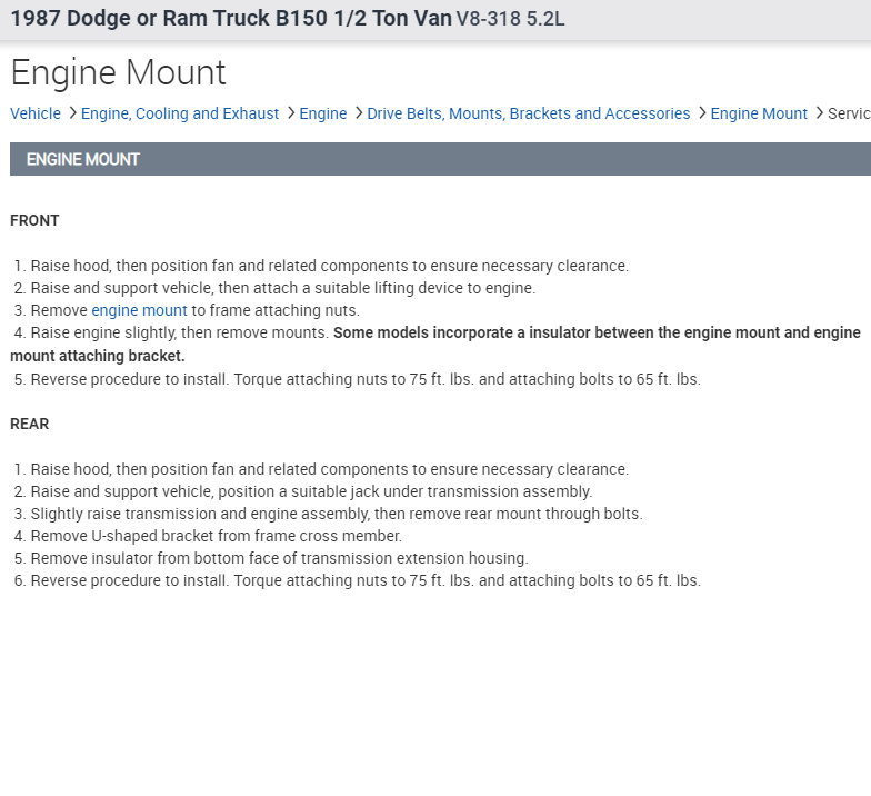

What's the easiest way to change the motor mounts in my Ram van b150 (listed above) without having to take too much apart?

On this vehicle you will just have to make sure you have enough to access the nuts for the motor mount. You might have to position the fan in a certain position in order to access the front nuts of the front motor mount.
Of course, first you want to make sure to support the engine before removing the mount.
Here is a helpful guide"
https://www.2carpros.com/articles/replace-motor-mounts
I have attached the replacement steps below for your reference.
Let me know of any questions.
